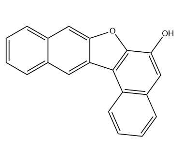

Synthesis of a butterfly shaped furan derivative
Today i wanted to share a synthesis i performed this week end that i found to be pretty interesting
The info and procedures come from the following paper :

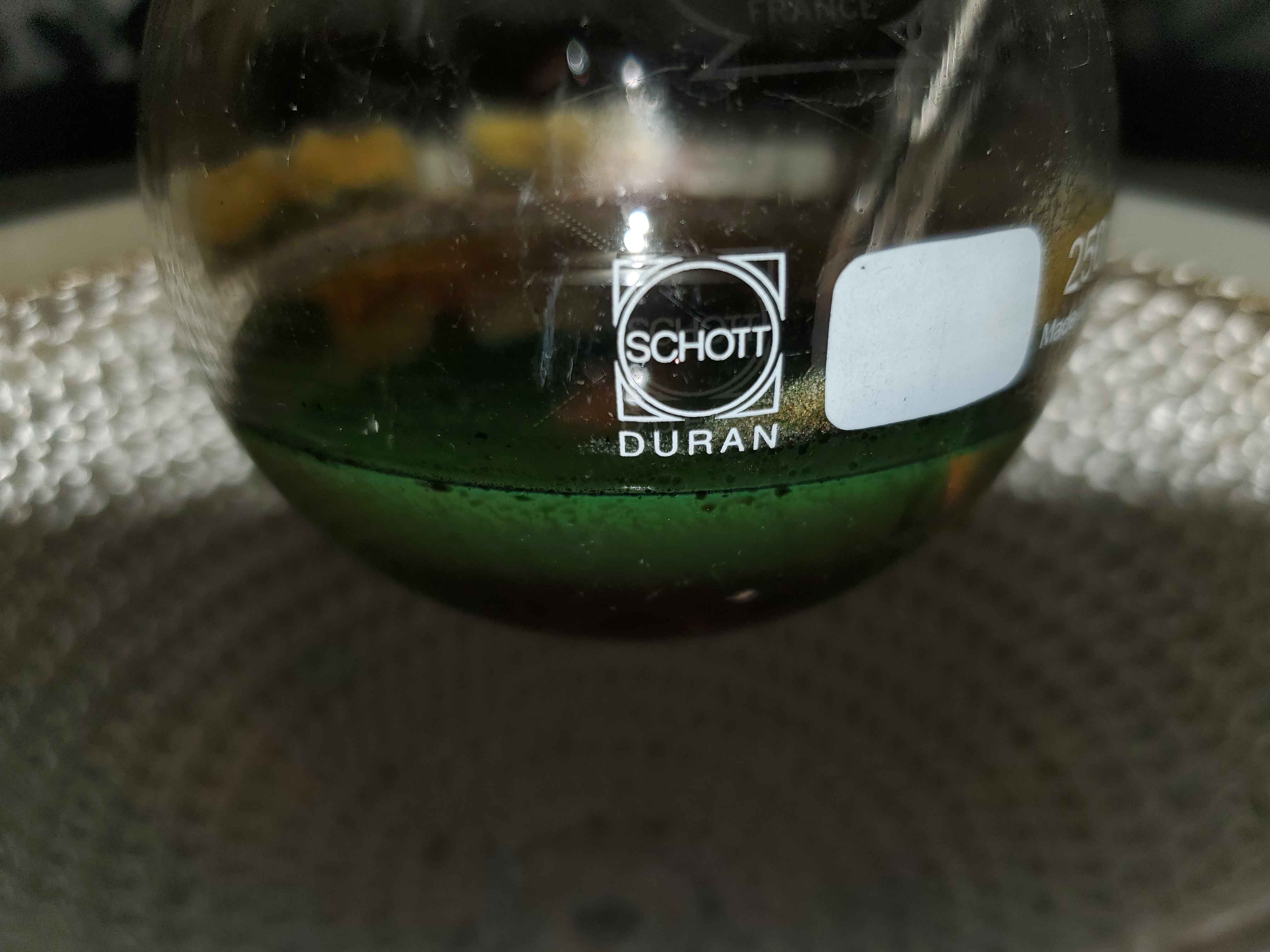

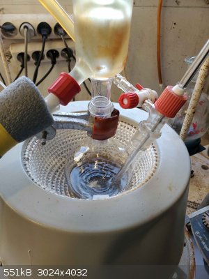

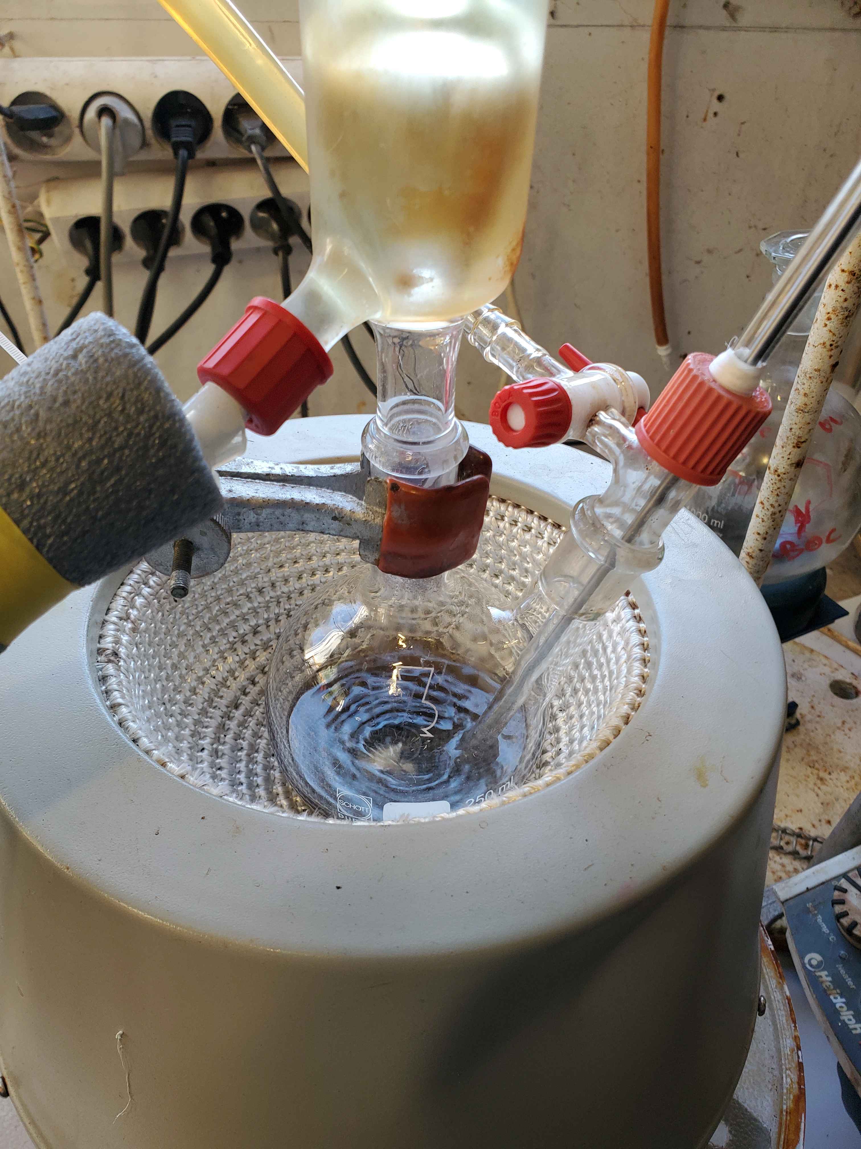

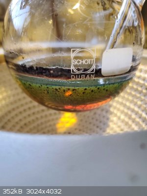

Firstly a reflux apparatus was setup with a argon entry in order to inert the whole thing, following this 60ml of dried O xylene was added and argon was bubbled trough it for a few minutes. Once the solvent was degased 1,6g of 2,3 dihydronaphtalene was added followed by 3.2ml of dry methane sulfonic acid. The apparatus was then closed and heating to 130°C was started. During the 24h reflux the temp spiked to 150°c a few time cause of the bad precision of my heating mantle. Some dark oil formed in suspension and the mix slowly took a tint reminding me of dilute fluoresceine in sunlight

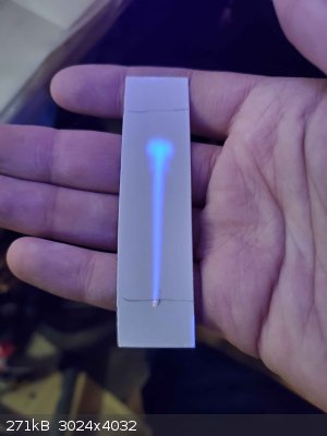

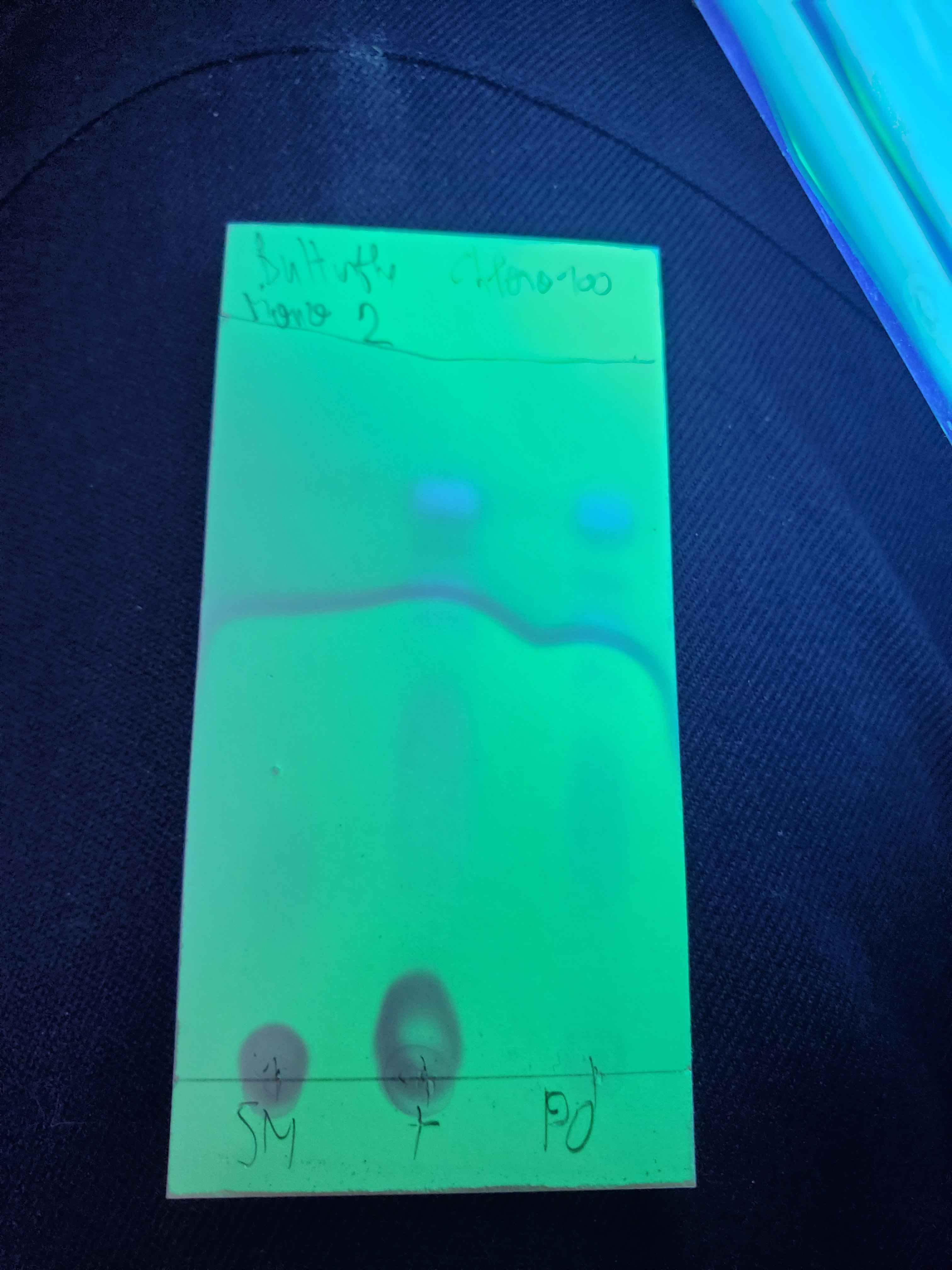

At this point the TLC showed a brightly fluorescent blue product with a high rf and no starting material left

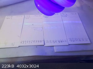

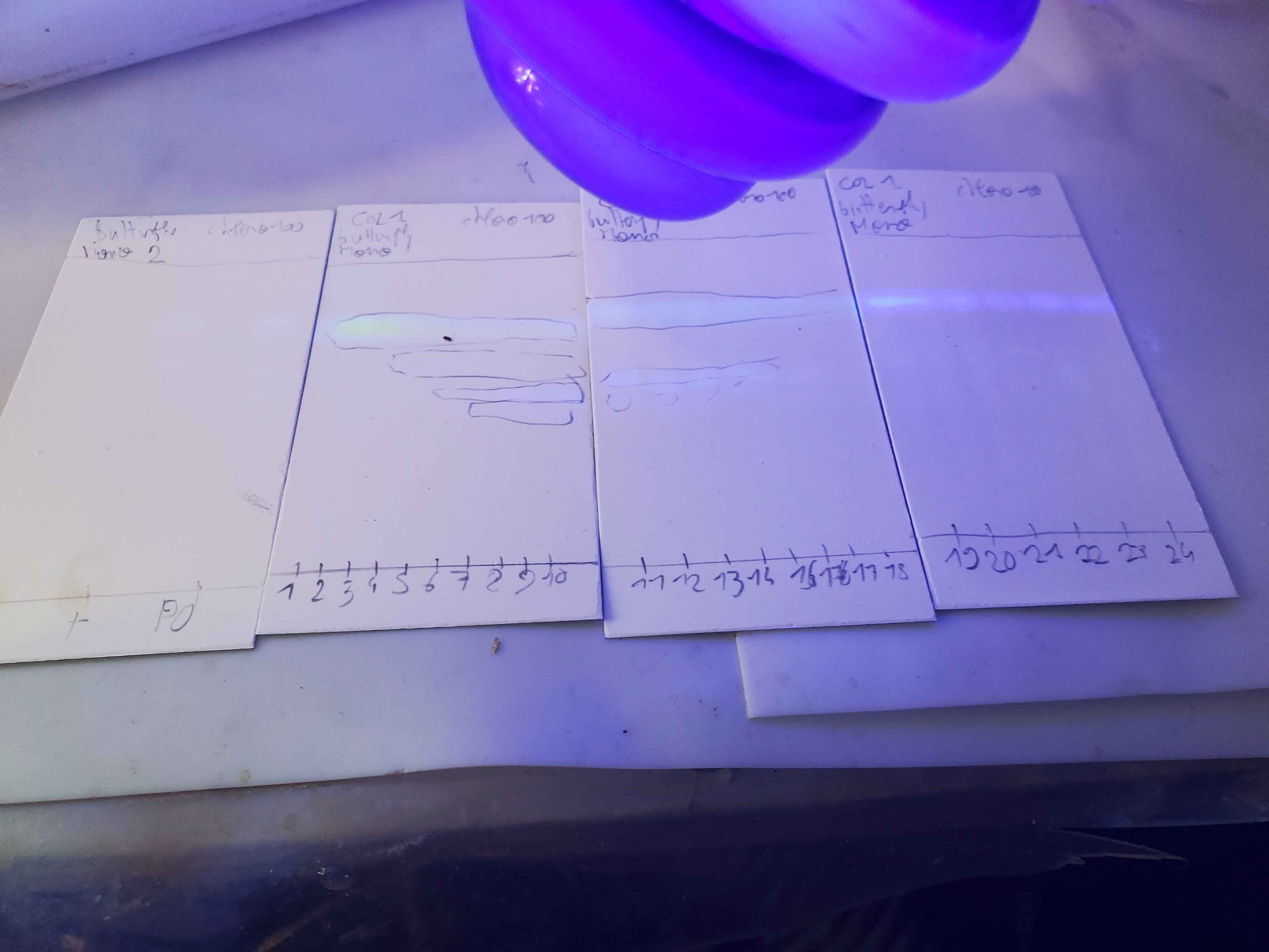

I then setup a vacuum flash chromatography using chloroform as a solvent and collected 27 tubes
After i performed a few tlc to determine the main product fractions and found out they were the 5 first tubes

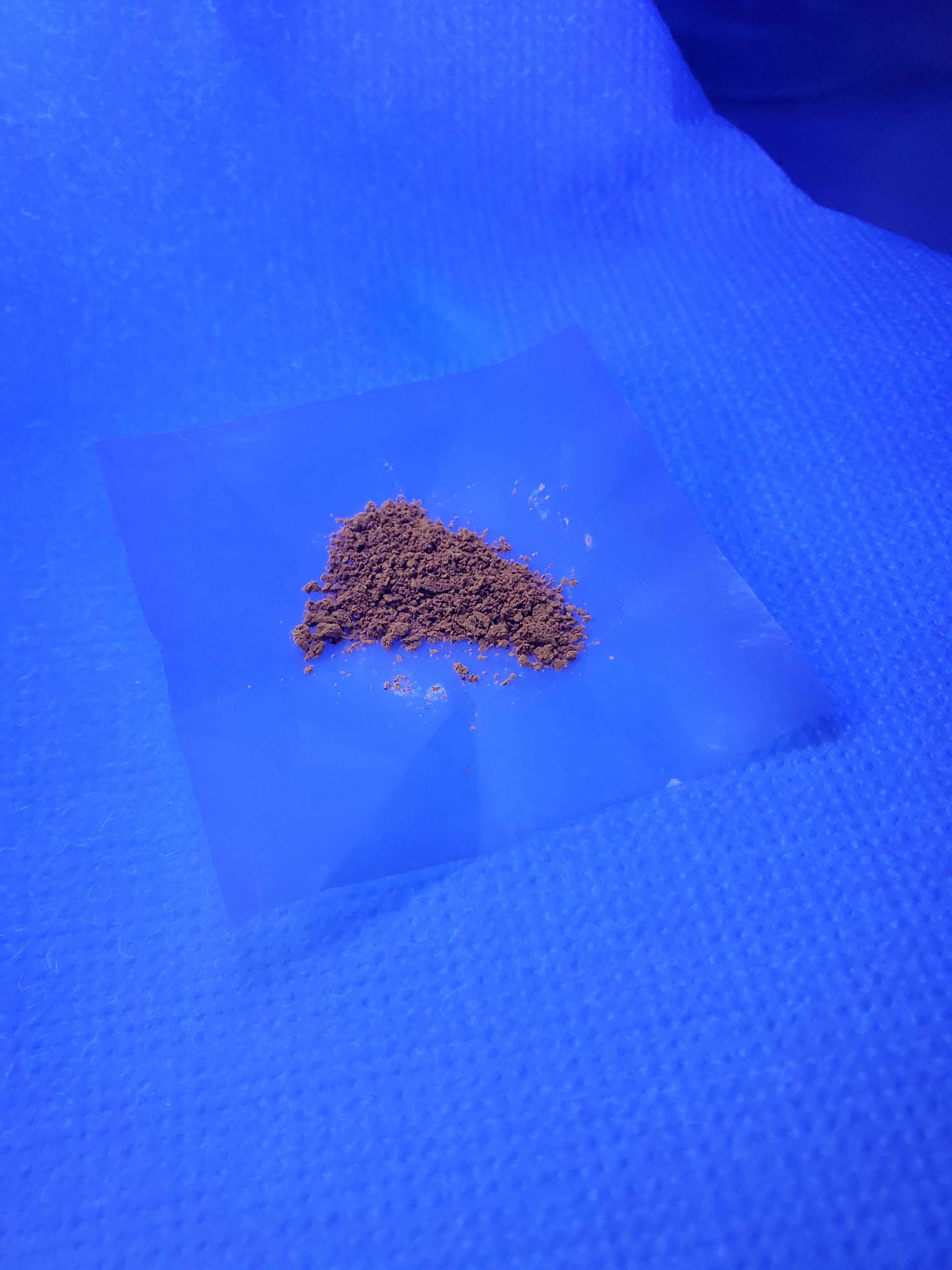

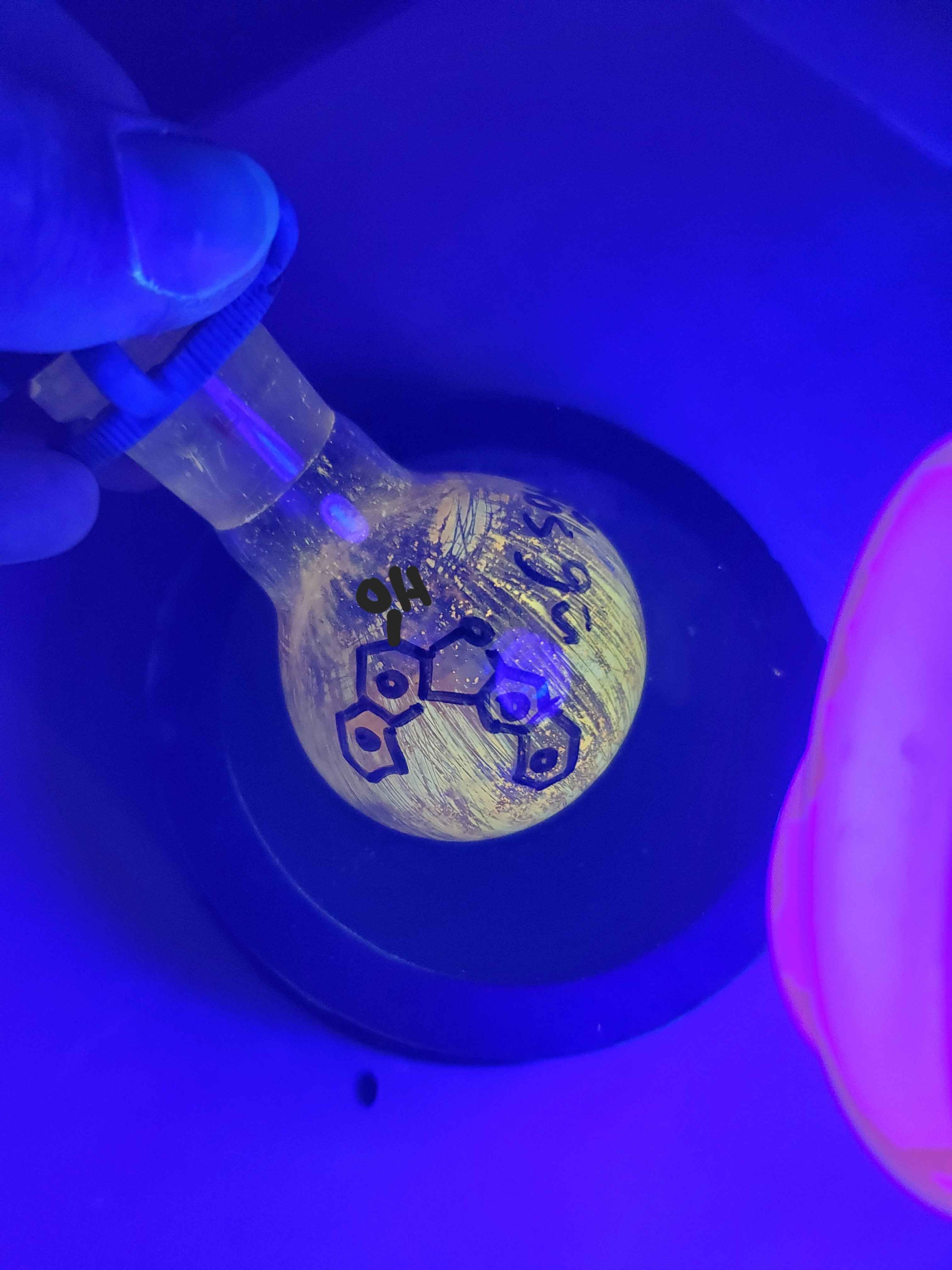

Following evaporation i obtained around 650mg of a brown/orange powder (around 45% of yeild if it was 100% pure) with a melting point of around 219c (close to the litterature value). Tlc of showed a single spot with a long trail left behind it probably because it was too concentrated. I would probably need to do a NMR or LCMS but i will proceed toward the next step adding the same patern and make it symetrical in a few weeks and update on how it went.
I noticed as well that the color of the glow seem to vary from blue to green/yellow depending of the concentration / if its in solution or not, am not sure if this is the product itself or slight impurities causing that unfortunately
Anyway enjoy a few pics of synthesis and the beautiful glow of the final product <3
