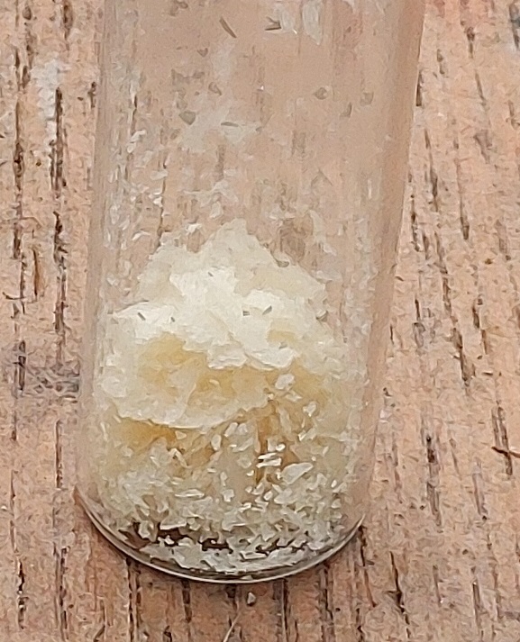

I found a procedure in the Journal of the American Chemical Society after looking into uses for perchloroethylene. The procedure I did is on a 1/5 scale. I synthesized the chloroform from bleach and acetone, followed by reflux and distillation over sulfuric acid. Because I didn't have the stirring setup called for by the paper, I opted to double the amount of chloroform to account for decomposition.
100mL of perchloroethylene, 60g of potassium hydroxide flakes, and 10mL of chloroform were mixed with stirring. A condenser was attached and heating started. 2mL of additional chloroform was added while it was below reflux. At this point, the stirring had seized, so the flask was manually stirred every so often.
The remaining 8mL of chloroform was added in 0.5mL spurts, the flask was swirled after every addition, which took about 12 minutes. Over this time, the potassium hydroxide had gone to a brown color. The reaction mixture was refluxed for an additional 10 minutes, with swirling every 2 minutes. The flask was then placed in a water bath to bring the temperature down, and then allowed cool to room temperature.
The solids were filtered off and eventually discarded. The remaining supernatent was about 90mL, and was a yellowish color. The flask was then covered loosely. I then forgot about this reaction for several months, over which time the solvent conveniently evaporated.
The slightly-yellow, damp crystalline mass was weighed, and came out to be roughly 2g. 14mL of methanol was measured out and added to the crystalline mass. Solution was heated to boiling, and an additional 10mL of methanol was added due to the crystals not dissolving fully. Once everything had dissolved, the solution was slowly cooled to freezer temperature. Large crystals had formed, and these were filtered off, washed with a small amount of cold methanol, and dried.
Hexachlorocyclopropane.jpg - 167kB
This came out to 1.68g of slightly-damp, off-white crystals. The smell was obvious when working with this compound: piney, camphorous, and reminiscent of chlorobutanol. This is consistent with the paper. The melting point was 102°–104°C, which is slightly broader than reported (103°–104°C), but consistent with hexachlorocyclopropane. Thus, I believe this is the compound isolated. The yield was about 2.7%, which is a bit far off from the paper (4.5%). But, the paper used better stirring, and the percent is slightly skewed lower because of the doubled chloroform. Also, I used a bit more methanol than the paper did in the recrystallization.
Some notes on safety:
  • Due to the low yield, it can be inferred that most of the dichlorocarbene decomposes in the basic solution, either to carbon monoxide or potassium formate (I presume via a formyl chloride intermediate). Just in case it was mostly the former, I performed the reaction outside, and severely limited my exposure to the reaction by only being around it if needed.
  • The toxicity of the hexachlorocyclopropane has also not been established. It doesn't seem far off to think that it would be a liver toxin based on similar molecules. I tried to limit my exposure to it.
The solution was evaporating for 10 months or so in my garage, so the stability of the product is, as the paper describes, quite high. I probably won't revisit the synthesis due to the low yield, but I'm extremely happy that the reaction was successful.

Interesting chemistry! When I read your account I notice that you let it stand for "10 months" over which time the excess solvent evaporated. This makes me wonder if you didn't loose some product too as I am pretty certain it will be fairly volatile.
My other question is what can you do with hexachlorocyclopropane? Conc sulphuric acid hydrolyses some of the linear polychlorohydrocarbons to various poly chlorofatty acids etc. so I wonder if this compound might undergo such a reaction? and what would it make? I presume that if it will withstand refluxing with caustic alkali it is fairly stable under alkaline conditions.

Boffis: Yep, I did let it sit for a while. It did remain loosely covered with aluminum foil, so it can't be super volatile. I most likely did lose a small amount of product over this time, though, since I have no idea when the solvent was gone.
