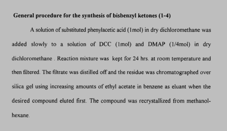

I must say i went the "easy way" buy ordering directly the dibenzyl ketone as for me it is relatively cheap to get. However it can be made several ways, the best i found so far involved the reaction of phenylacetic acid with DCC and DMAP
The following procedure were inspired from orgsyn protocoles:
http://www.orgsyn.org/demo.aspx?prep=CV3P0806
http://www.orgsyn.org/demo.aspx?prep=CV5P0604

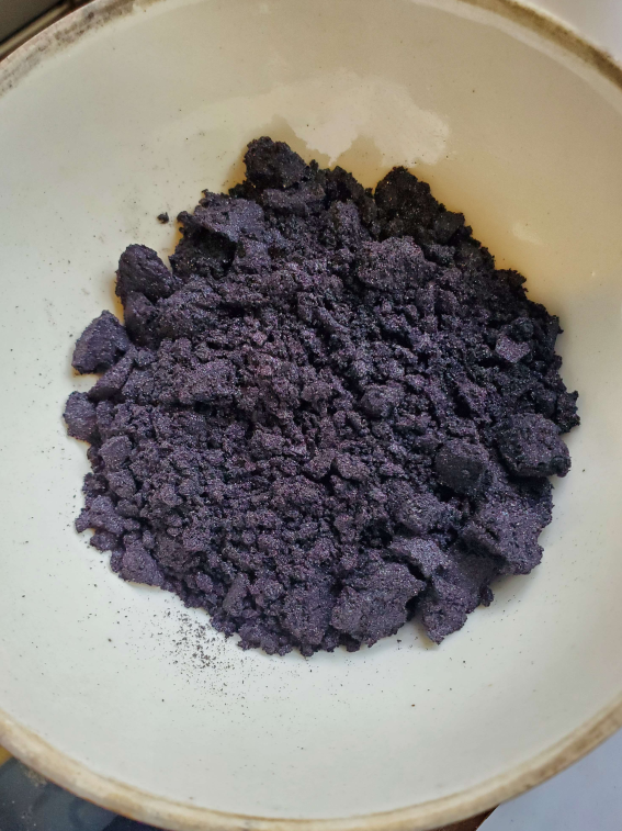

Tetraphenylcyclopentadienone synthesis:

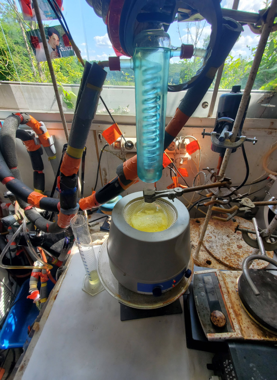

-21g of benzil and diphenyl ketone were mixed with 150 ml of dry ethanol in a round bottom flask
-the reaction mix was heated for 30min
-3g of KOH was dissolved in 30ml of warm dry ethanol and the mixed was stirred to ensure full dissolution

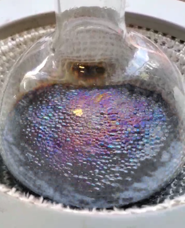

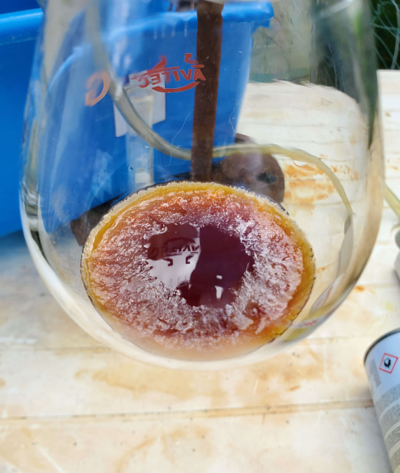

-after 30min of reflux the solution of KOH in ethanol was added in 2 time trough the condenser end and the mix was refluxed for 15 more minutes , vigurous boiling was observed upon addition of KOH with a color change from yellow to dark red/brown (nice irridescence appeared for a few seconds in the bubble formed)
-the reaction mixed once cooled to 0°c was filtered under vacuum on a sintered funnel and washed with 3x10ml of ethanol
the washing were continued till the filtrated changed from dark brown to a pale brown color
Final product was dried under vacuum over P2O5 to afford the product as a dark purple shiny powder : m= 36g (94% yeild)

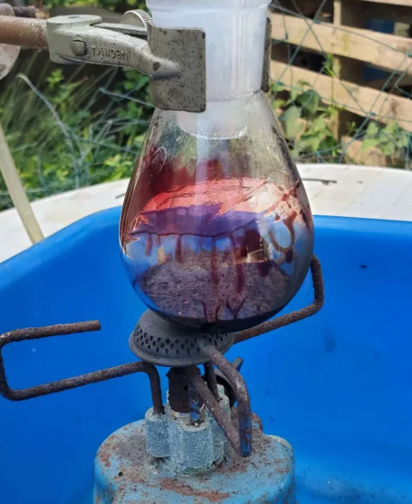

-In a round bottom flask 10g of benzophenone was added and slowly heated on a open flamme until fully melted
-2g of diphenylacetylen and 2g of the Tetraphenylcyclopentadienone were added rapidly before a air condenser was set up on the round bottom flask
-Heating was continued for 1h with mild boiling of the benzophenone as color slowly shifted from dark red to brown (Reaction produce carbon monoxide so i recommend to do it outside, even if my meter didnt seem to pick it up when pointing the exit tube at it)

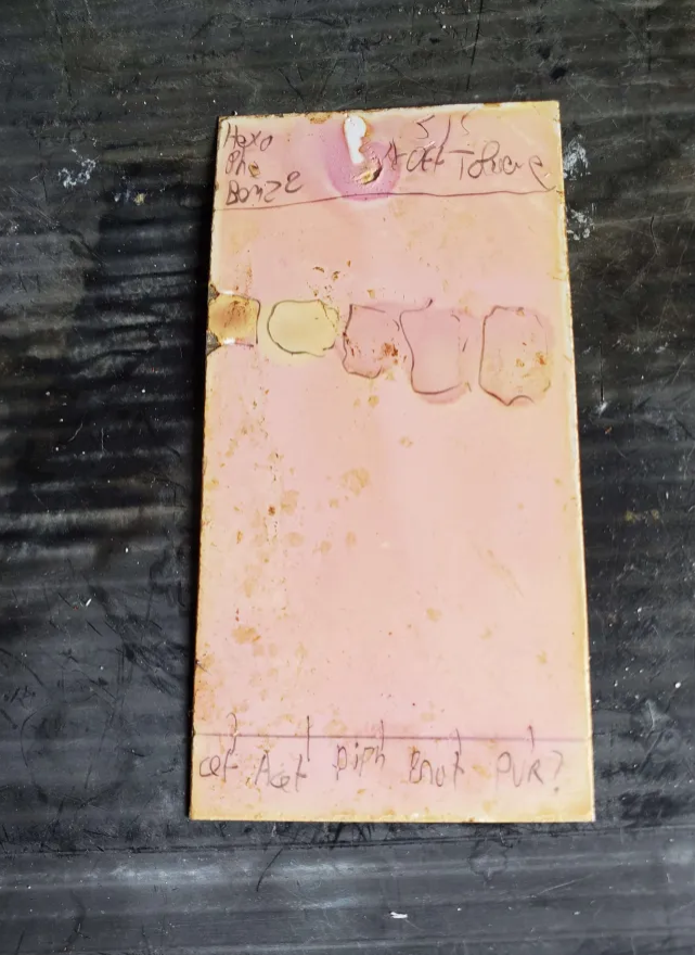

I performed a TLC testing different solvent, the best i found was AcOEt/ toluene 5/5
From left to right : ketone start mat, acetylene start mat, diphenyl ether, crude product + diphenyl ether, pure product + diphenyl ether
(diphenyl ether was used because product was v insoluble into toluene)

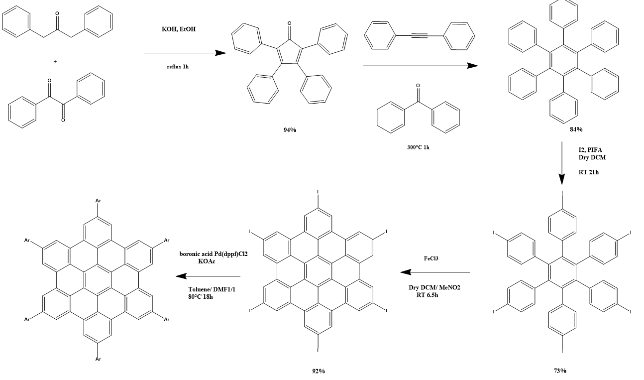

Im not certain what i will use for , prob gonna try a Scholl reaction with MeNO2 and FeCl3 to form the hexabenzocorronene or further alkylated derivatives of it

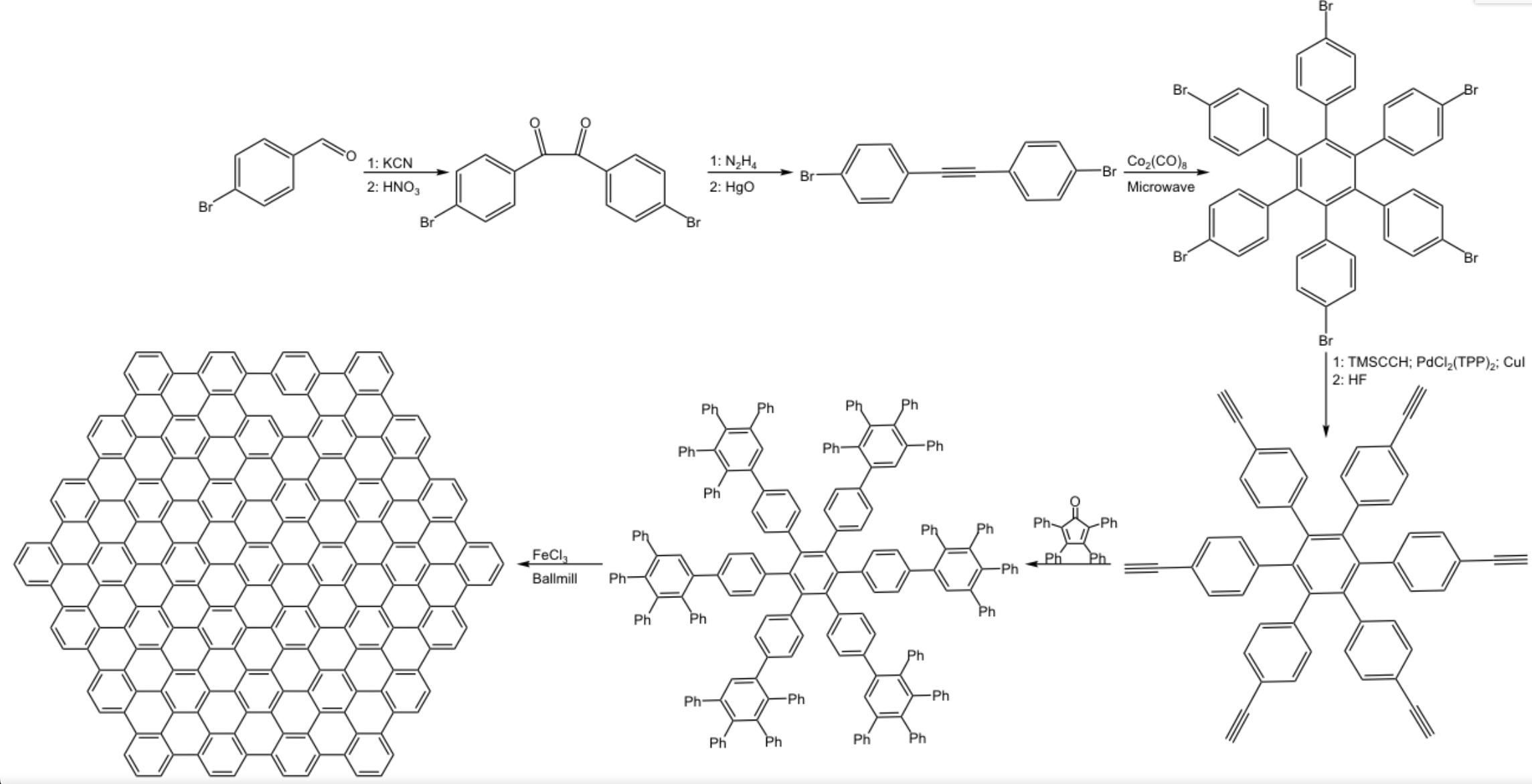

On a different note, this made me remember this thing I was thinking about a long time ago, nanographenes. I did legitimately think about attempting this synthesis back then, but I don’t think I ever will, like for many ideas from back when I just started doing homechemistry.

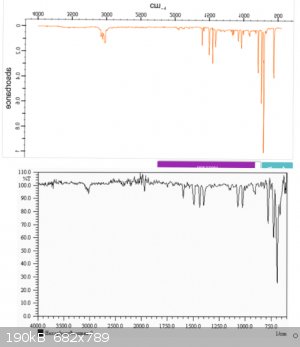

Thanks a lot for your replies, i was thinking to go this way eventually once i got some PIFA, at first i wanted to make the hexaphenyl bpin..but considering their last step has a yeild of 0.8% im probably gonna try to connect some aryl or something on there. Honestly im curious about the fluorescence i can achieve by increasing its size and conjugaison
