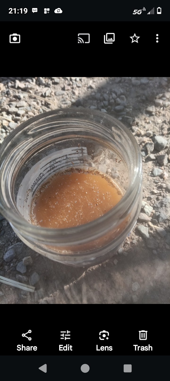

Help to determine what this mineral is

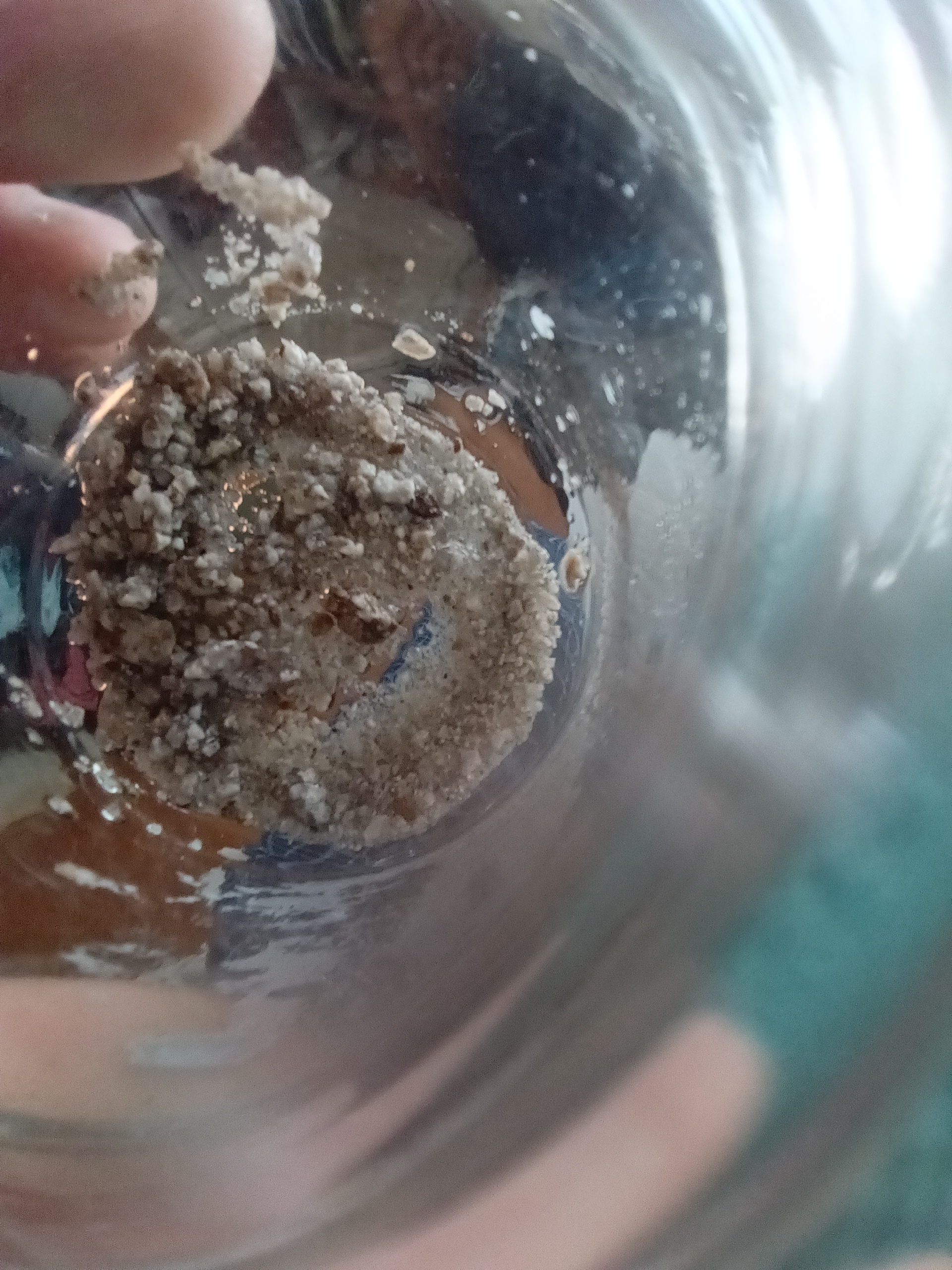

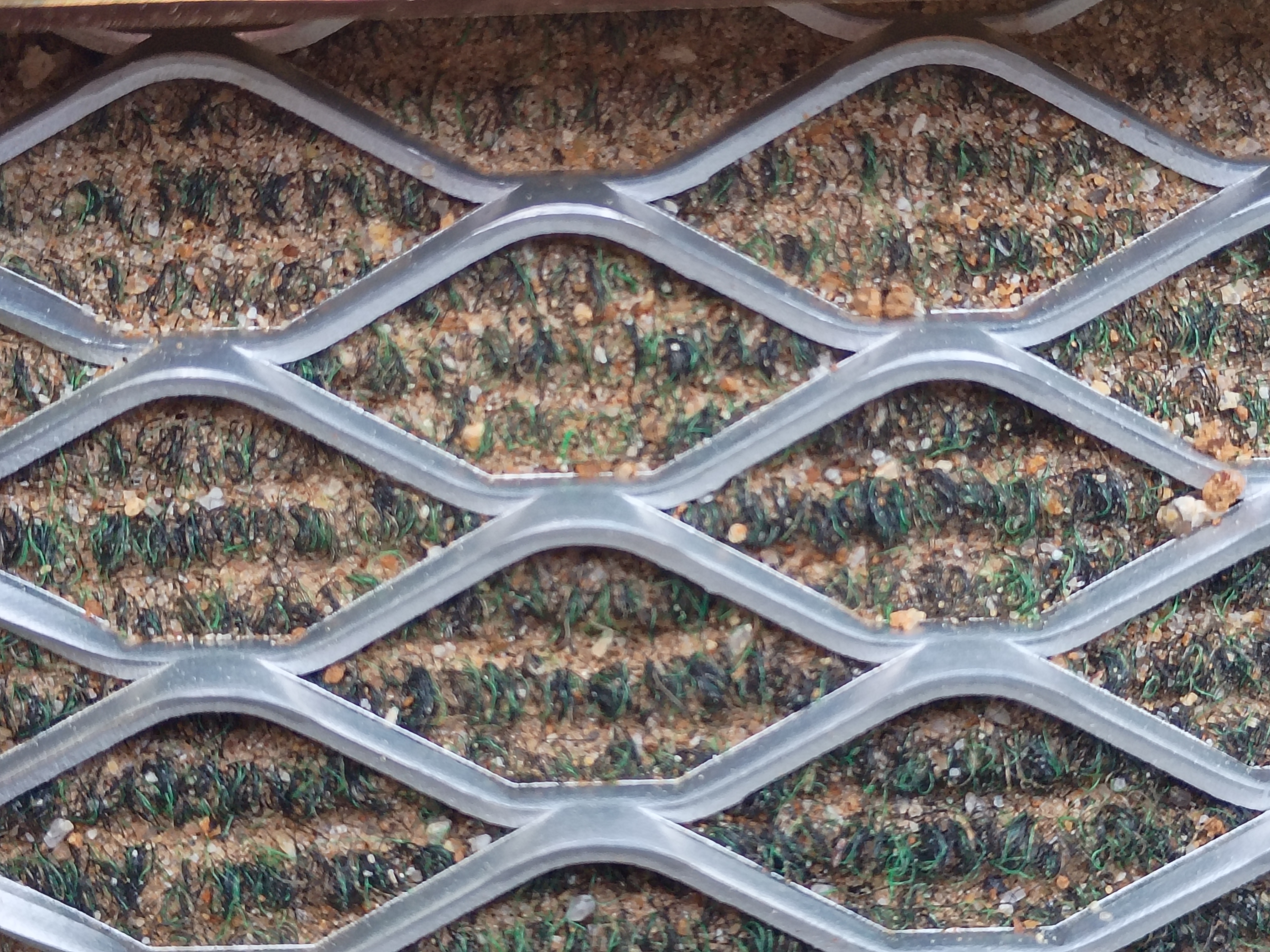

This mineral is really fascinating me because I've never seen anything like it in the ground where I live. The pit from which
I extract it is a long abandoned mining claim. The area of the world in which i live had the richest placer mine in 1900, and some very large gold fortunes were amassed from what is now downtown.
The mineral is a very dense coarse sand, dark red almost purple in color when first dug up from the mineral seam, which is not very large and surrounded by iron rich minerals including pyrite, and there are quartz crystals mixed in the formation.
Upon mixing this coarse sand with equal volumes sulphuric drain cleaner (roto rooter 93%, gray and black impurities at the bottom in otherwise clear liquid) and 12% peroxide a vigorous exothermic reaction occurs, and the silvery metal flakes pictured swirl around. Gas is evolved, with a faintly "savory" mild smell is produced.
Eventually all that is left after this reaction is washed and filtered are some flakes gold and silver in color, which do not change color upon drying in air.
Can i have some direction in how to identify this mineral? Are there any easy ways to test quantitatively or qualitatively for things like arsenic, cadmium, lead, etc?
Screenshot_20250608-211951.png - 945kB
[Edited on 9-6-2025 by PonderosaP]
Screenshot_20250608-211933.png - 579kB
Deathunter88
Posts: 554
Registered: 20-2-2015
Location: Beijing, China
[*] posted on 8-6-2025 at 21:15
I would guess that's a mix of primarily hematite and quartz. This is what gives gold mine tailings that characteristic red-orange color. This also matches your observations since hematite dissolves in the sulfuric acid + H2O2 to form iron sulfate, and it is typical of iron dissolution to produce a "meaty" smell - the same smell that forms when you touch metal coins or blood.
See this example: https://www.researchgate.net/figure/Main-chemical-compositio...

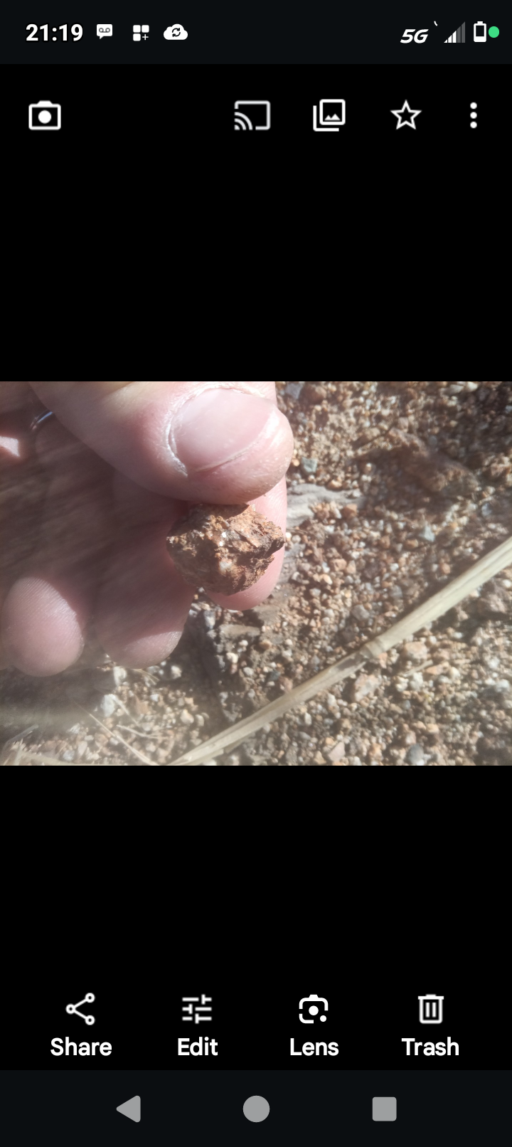

PonderosaP
Posts: 16
Registered: 9-8-2024
[*] posted on 9-6-2025 at 08:38
Thanks for sharing your expertise. I'm certain you're correct, it would handily explain the transition from very shiny black-purple (not pictured) to the rust colored sand pictured above.
The smell of iron is quite distinct, i know it well not only from rockhounding but also metal fabrication.
While the main soluble portion is clearly hematite and [the insoluble one] quartz, i am still concerned working with this mineral.
I would describe the smell as almost like black pepper or onion, evident in the jar pictured after most of the iron has been dissolved and washed away.
Im left with a hard white flakey mineral with embedded chunks of quartz and flakes of what i hope are precious metals.
I suppose the easy answer is to take serious precaution anyway. I guess i was hoping to be spoonfed some qualitative tests and reagents for identifying the more toxic elemental friends of Ag and Au.
Yes, I know that i should UTFSE and read a f*cking book.;)
IMG_20250609_102018207.jpg - 1.5MB
[While this was a mining claim, i believe the operation began and ended with explosives and a water sluice operation over just one or two seasons before being abandoned. The site is mostly a pond, teeming with massive frog and insect population. The sample i collected was at the edge of this pond in the mineral seam. The tailings were discarded at the other end of this pond, acting as a dam for this ~150' long by ~25' wide body of water. Elsewhere in Montana where cyanide was employed biological life is non-existant. That said, the composition of tailings and the ore itself is roughly the same. Modern gold mines are profitable at grams/ton scale.]
Edits in []

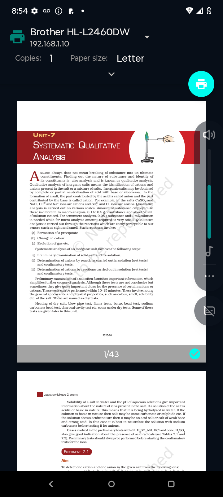

The screengrab I posted was a lazy way to show I printed that little pamphlet to take into the field.

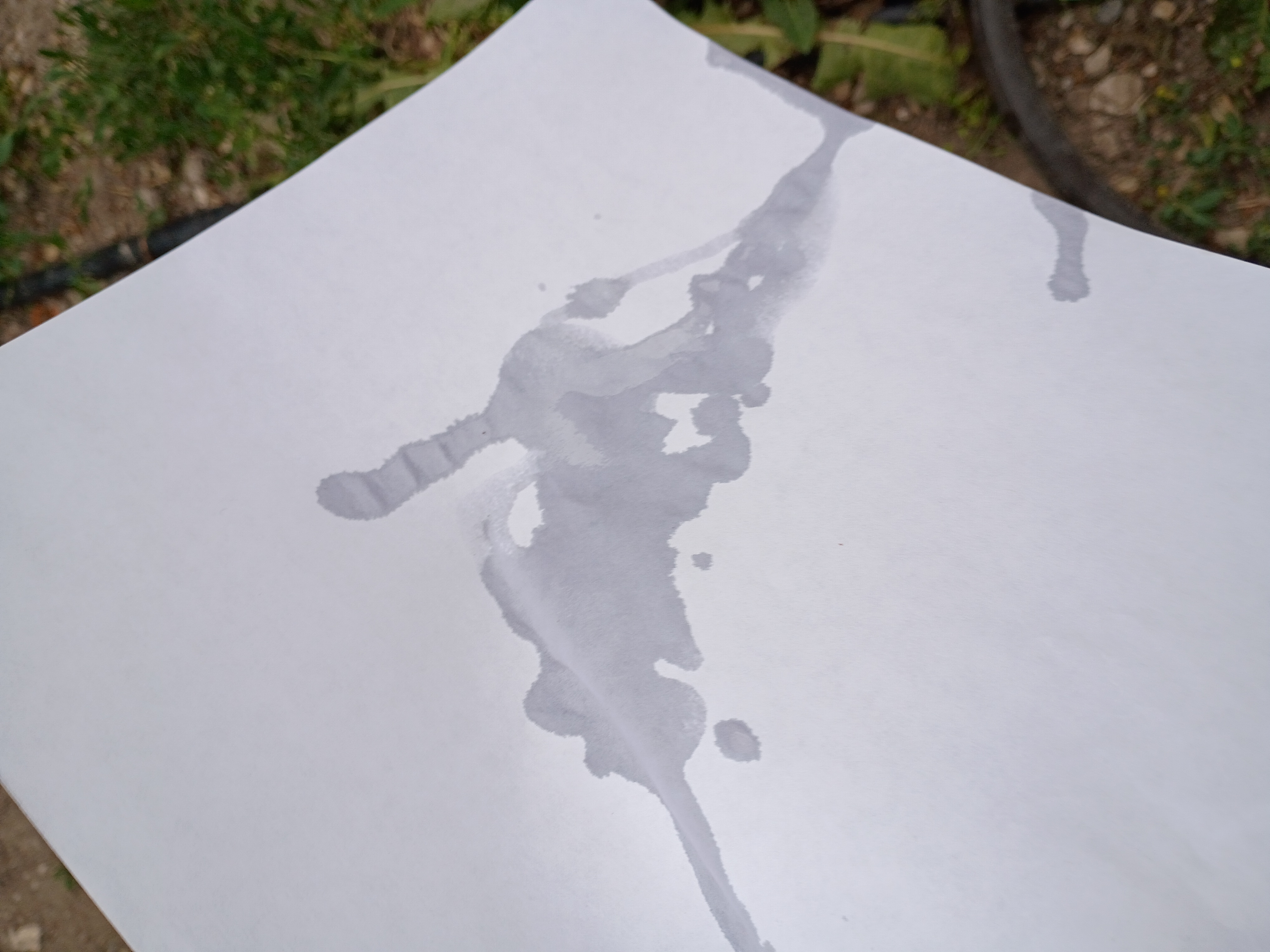

I had a very bright yellow solution from this ore. When I added the dilute flux I had on hand, I enlisted my wife to witness after showing her the video from Tyler Johns. The solution I had looked brighter yellow than his! Upon addition of flux we witnessed a significant brown precipitation develop.
I had documented this with pictures to post, but unfortunately poor judgement led to my phone (and truck RIP little Toyota) being destroyed in an incredible fireball last week.
On Saturday I brought a newly purchased sluice box to the aforementioned mine site. I don't know if I used it correctly but even if I didn't I should have exciting concentrates to test! This mine site has been inactive since 1910. I am careful to fill in my hole and hide evidence of digging with foliage. I'm quite certain there are others looking for gold here.
Thanks for coming to my TED talk SM.
IMG_20250617_201546764.jpg - 3MB

Yea the brown ppt. is a sign of precious metals, and I think your predictions about the precious metal concentration in the sample is way less than what actually is present in it . If you have an analysis lab nearby, try to give them a small sample for determination of minerals present in it.
And was the yellow solution formed after addition of aqua regia or just water?

Well, I wouldn't be so optimistic.
The stannous chloride test depends on the gold being in solution.
You found this sand on (in) the soil by a pond. Any soluble compounds would for the most part have been washed out long ago. There probably is some microscopic life in the sand with may confuse things.
Also, I think you barked up the wrong tree with that flux. As far as I can find online, K-T Ruby Flux contains zinc (Zn) chloride and muriatic acid (HCl), no tin (Sn).
In soldering "tinning" means to coat with the solder in a way that forms an alloy with the base metal.
Stannous chloride solution degrades with time. In that "sreetips' video I think he says that he makes a new solution about every four months.
Depending on the situation stannous chloride is used for several other things, in one of the Tyler Johns videos it is used to precipitate a bismuth compound.
