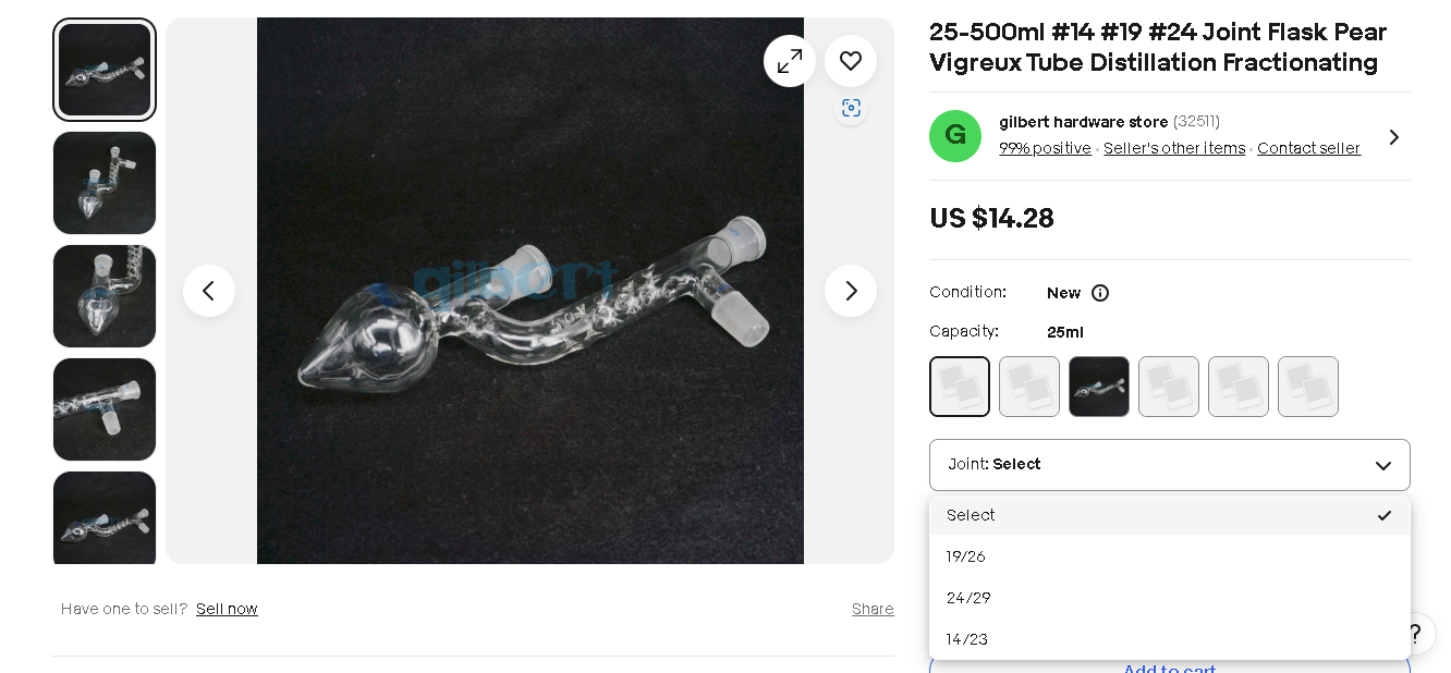

Why are they used as distillation flasks?
I see how retrieval of a small volume of liquid would be easier in a pear receiving flask but am better trying to understand how the pear flask excels in usage as a distillation flask.
The pear flask, I've heard, can be better suited for not boiling to dryness, as this is supposed to create bumping.
Here in the picture, is a pear flask with vigreux claisen adapter attached to it. It seems that this would prevent pumping and contamination that would occur if it were just a simple pear flask with distillation sidearm, as shown below.

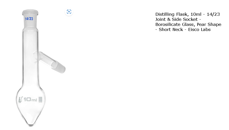

Also, the picture of the pear flask with side arm, can this be used to collect a distillate free of contamination from bumping?
Looking for the cheapest way to do a simple short path distillation. The pear flask with sidearm looks promising.

I have a pear shaped flask with Claisen adapter and a short Vigreux column built in, just like in your picture.
Suitable for atmospheric or reduced pressure distillation but not short-path, due to the Vigreux column blocking any straight path, and multiple bends.

I use pear flasks with distillation arms in small-scale synthesis for purification by distillation, comparing RBF it allows working with smaller quantities for the same flask volume with minimal loose in the arms also. Also usage of cappilary tube for vacuum distillation is more convenient. Generally, they are for small-scale because allow to boil the very last ml of liquid.

I typically only use pear shaped flasks for the collection of distillate, which makes it easier to pipette out the collected product. I would not use one for the distillate. But people will often sell things that are not ideal for your purposes, as not everyone does things the same way. A simple short path works well for small amounts, but will loss some material no matter how well it is used.
