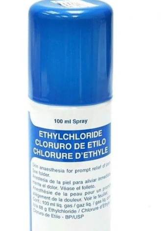

Some adult shops locally (don't know what kinky use it has) have started to sell ethyl chloride spray. I'm curious if it is good enough to use instead
of EtBr or EtI in alkylations eg Williamson ether synthesis, enolate alkylations etc, at the cost of a slower reaction rate and low boiling
temperature? I've seen some Williamson ether syntheses can use catalytic iodide to enhance the reaction rate of less reactive haloalkanes - would that
be a good way to go?
Like would ethylating a phenol by dissolving the phenol, potassium carbonate and a bit of NaI in some acetone, then streaming through the ethyl
chloride give appreciable yields of the ether, or is it just too unreactive and volatile?
Many thanks in advance!

Ethyl chloride with catalytic iodide seems like it would have a good chance of success. Here is a loosely relevant section from Clayden's that implies
ethyl chloride is reasonably reactive on its own:
