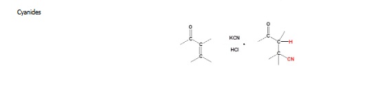

Hi everyone, I can’t understand the mechanism of this reaction. First of all I don’t get it why cyanide ion doesn’t react with ketone and why instead hydrocianic acid reacts with the double bond. But also in this case I don’t understand why the electrophile hydrogen atom doesn’t follow the Markovnikov’s rule. Beacause then the ciano group will be on a different carbon atom than I expect. Thanks

I'm guessing you have predominately a 1,4-addition to the enone?
1,4-addition cyanides.jpg - 5kB

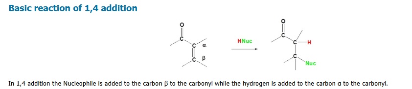

As the nucleophile, the cyanide anion, is a weak base, then the 1,2 addition is usually reversible. This means the competition between 1,2 and 1,4 addition is under thermodynamic control. In this case 1,4-addition dominates because the stable carbonyl group is retained.
1,4-addition.jpg - 23kB
1,4-addition mechanism.jpg - 45kB
