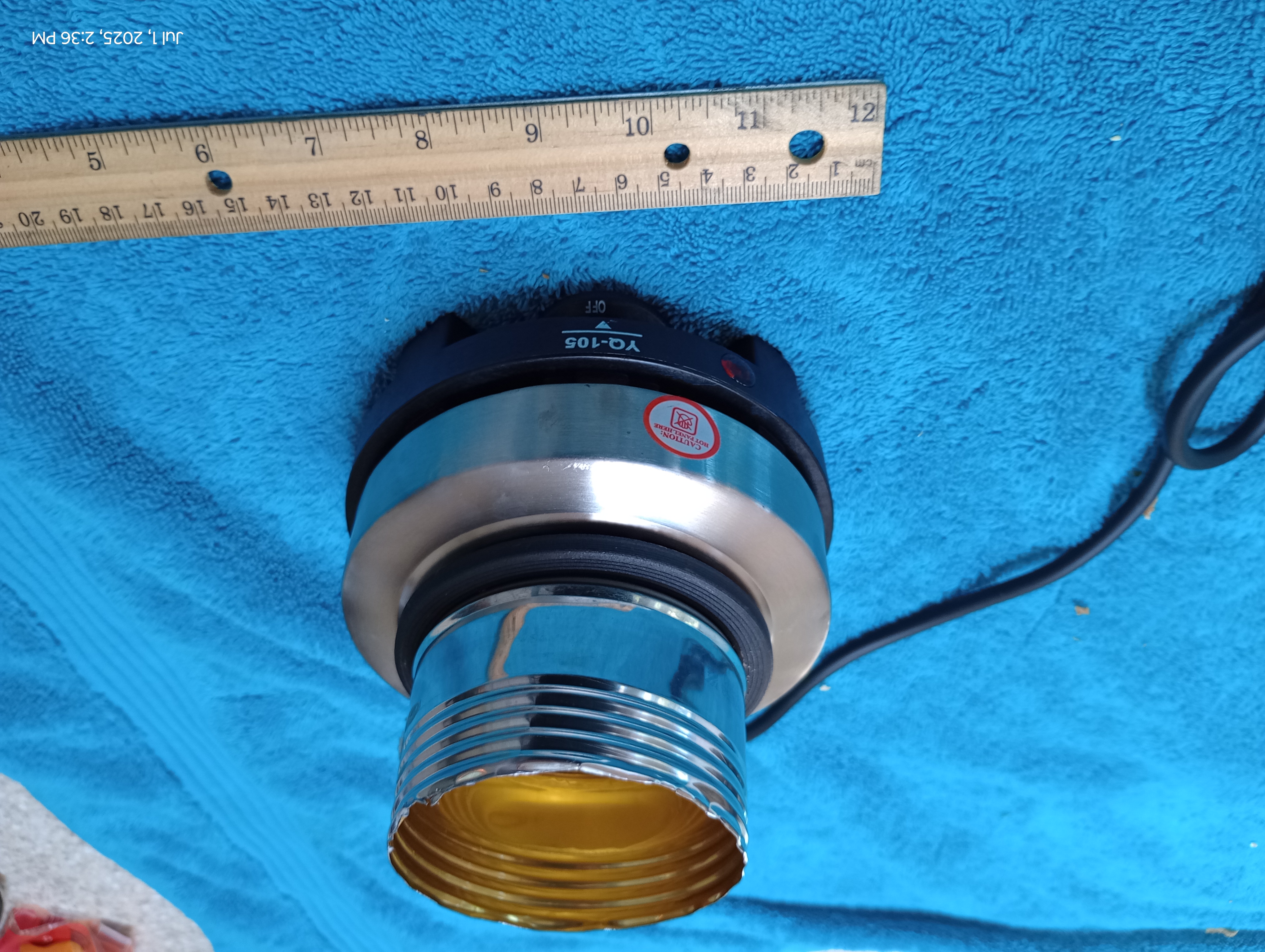

How much sand / oil is generally needed for a heating bath?
Something tells me the capacity of this cut up soup can is a lot less than what I'd.
Looking for suggestions here.

charley1957
Posts: 197
Registered: 18-2-2012
Location: Texas
Mood: Hotter than the hinges of Hell! Well, not yet, but fixing to be!
[*] posted on 2-7-2025 at 03:25
Some questions have no simple answer. Often it’s best to just try it. Run some tests. Use sand. Use oil. More sand, or less, whatever gets the job done. Just try it. Use a bigger can, or a smaller one, or a bigger hot plate. Boil water. Learn by doing.

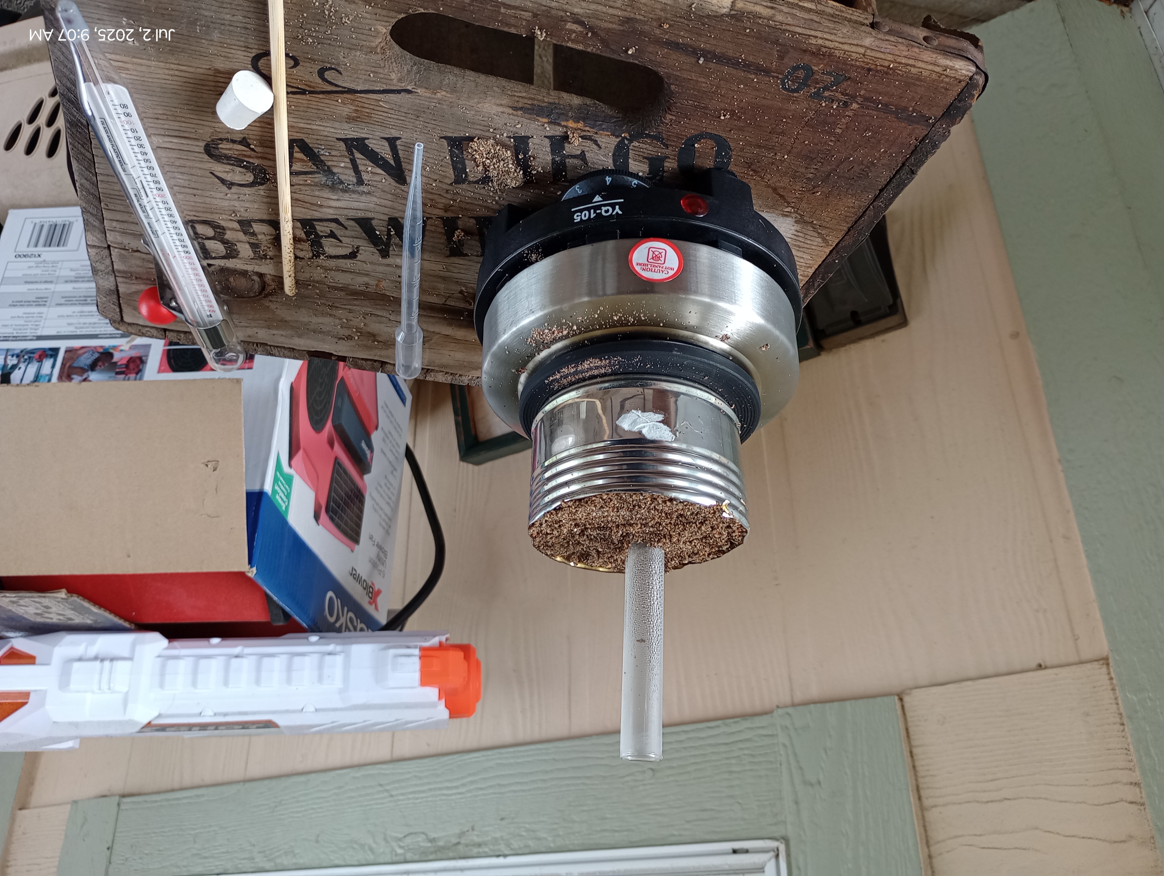

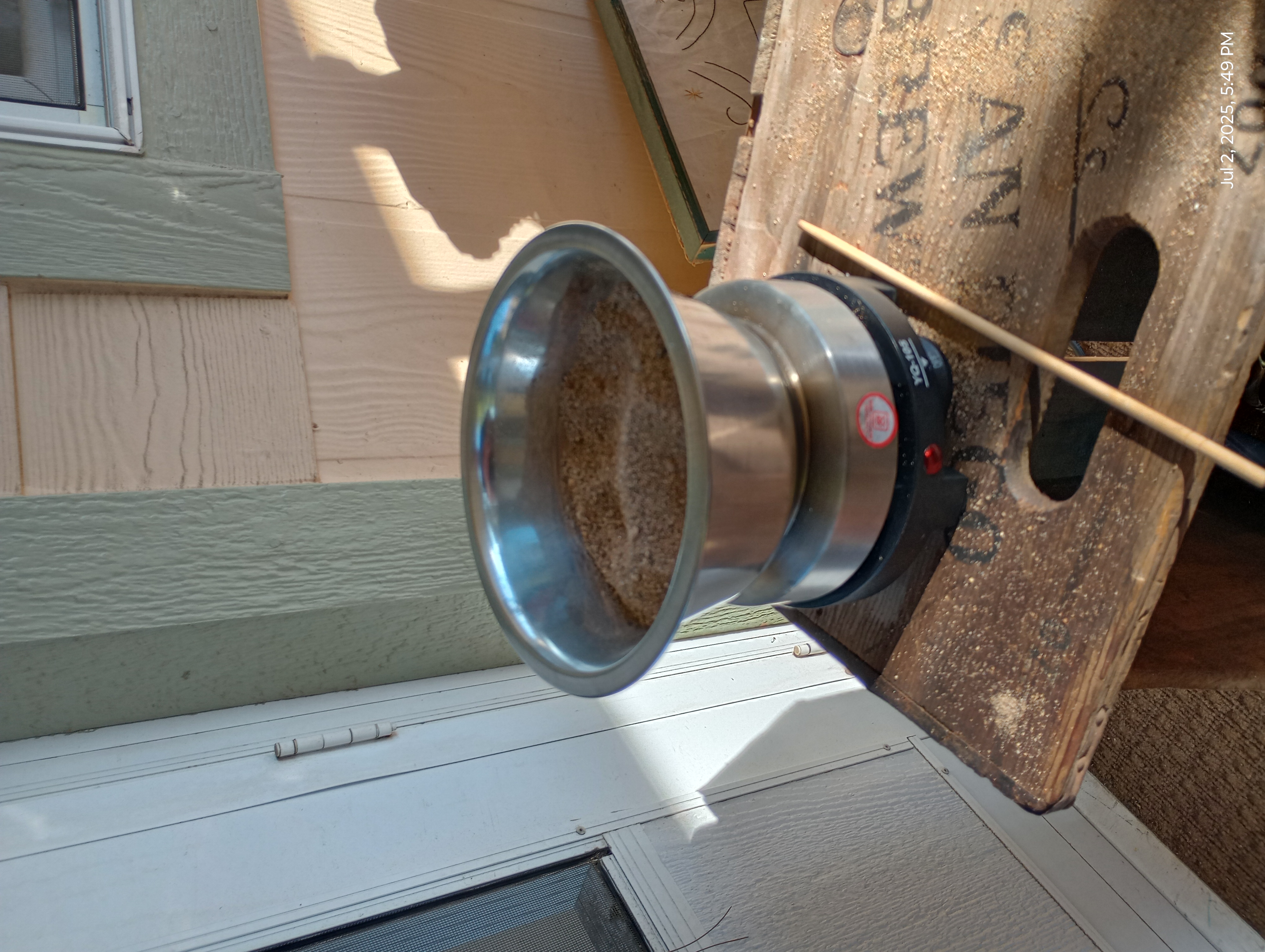

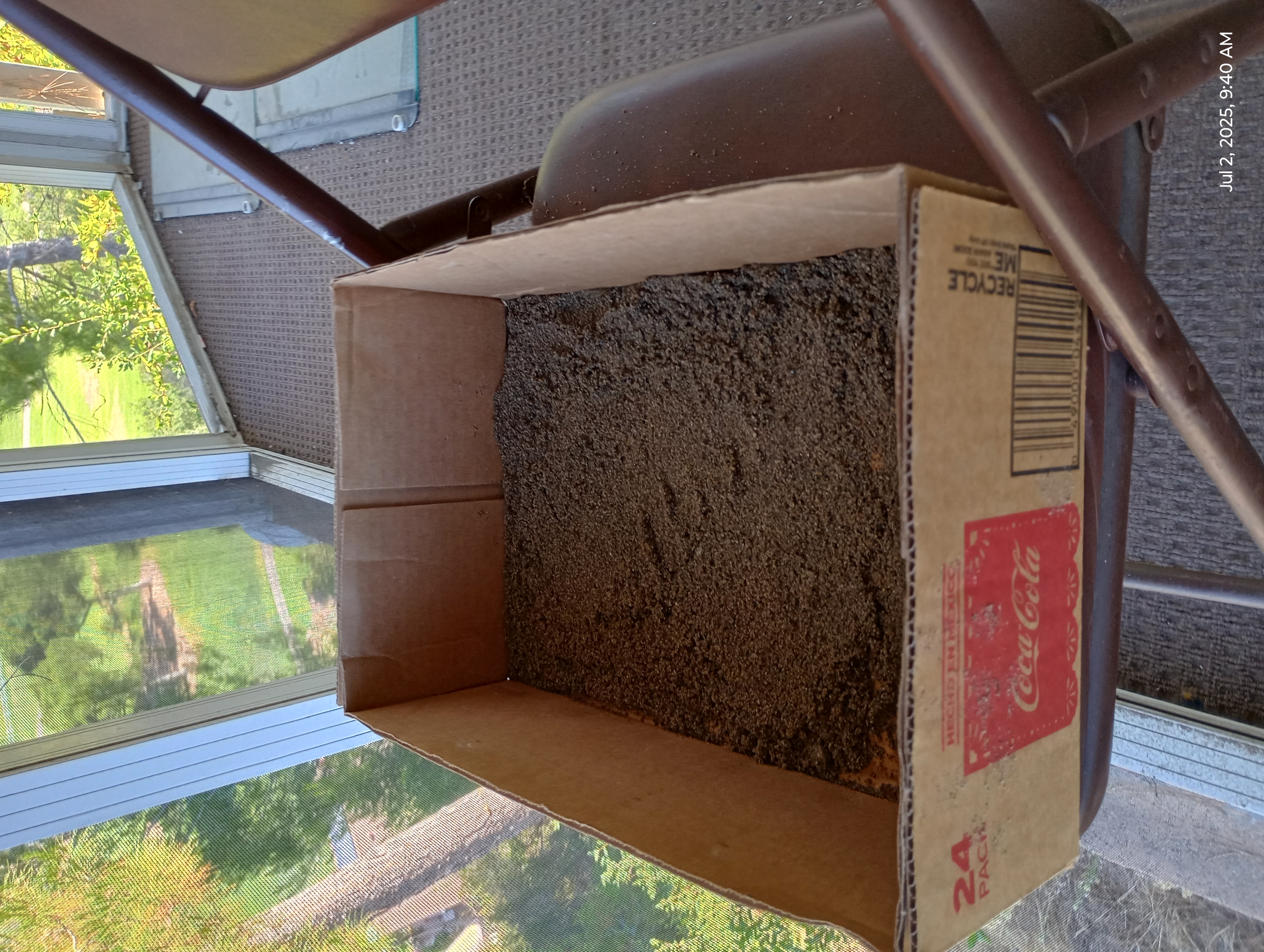

Sieved the sand, rinsed it in tap water, and now drying it on the hotplate.
Thinking that the residual water will aid in heat transfer allowed jg my sand to get hot faster -- than I expect it to smoke smoke as it is (debris burning off in the sand. (At least the lower portions nearest to the heat. It probably needs to be stirred.)
I'm noticing a good deal of condensation on the inside of my test tube, which reminds me of jsum1s post about short path distillation relying on evaporation. I forget whether or not he said this could be done without vacuum as well.) *
I will be going out today and hope to find a bigger pot.
I have little idea of how big I can go with this burner, I guess it depends upon allt such as how big of a flask and how hot do you want it to go.
IMG_20250702_090751353.jpg - 2.9MB

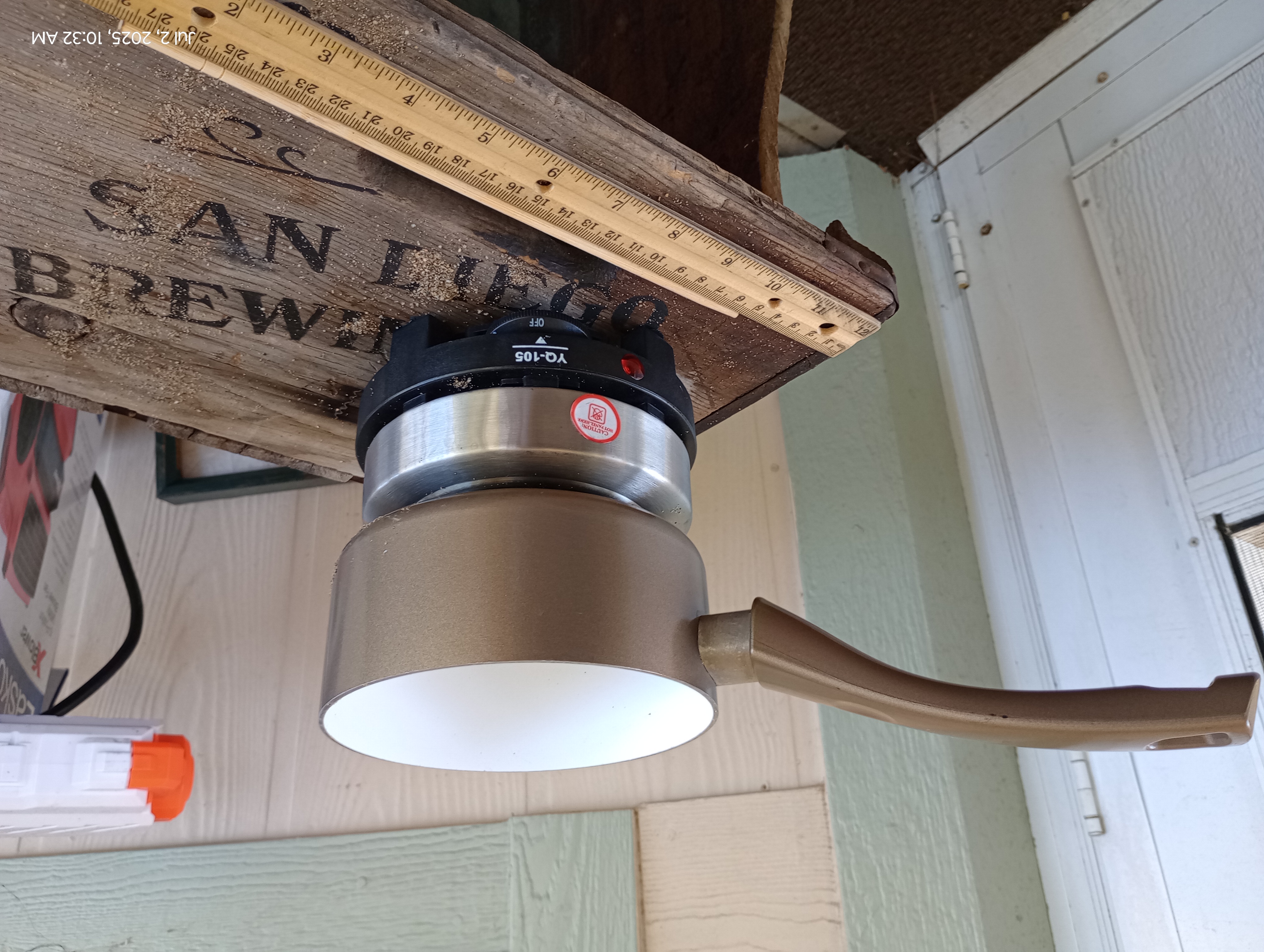

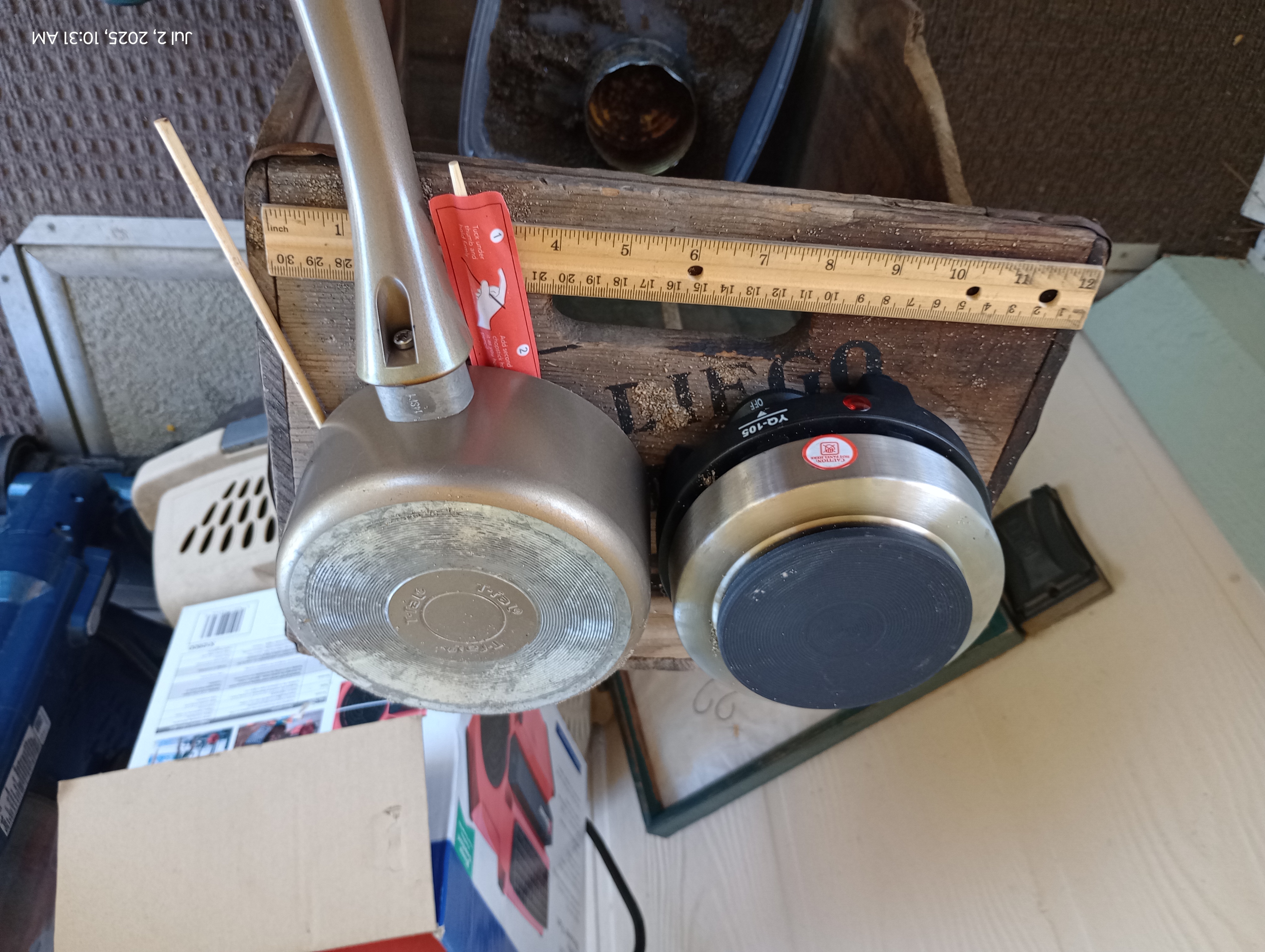

Maybe this pot with mineral oil would be a better fit.
It is a little larger than the hotplates 3.9" diameter. I hear that's bad.
Probably will take the long goofy handle off.

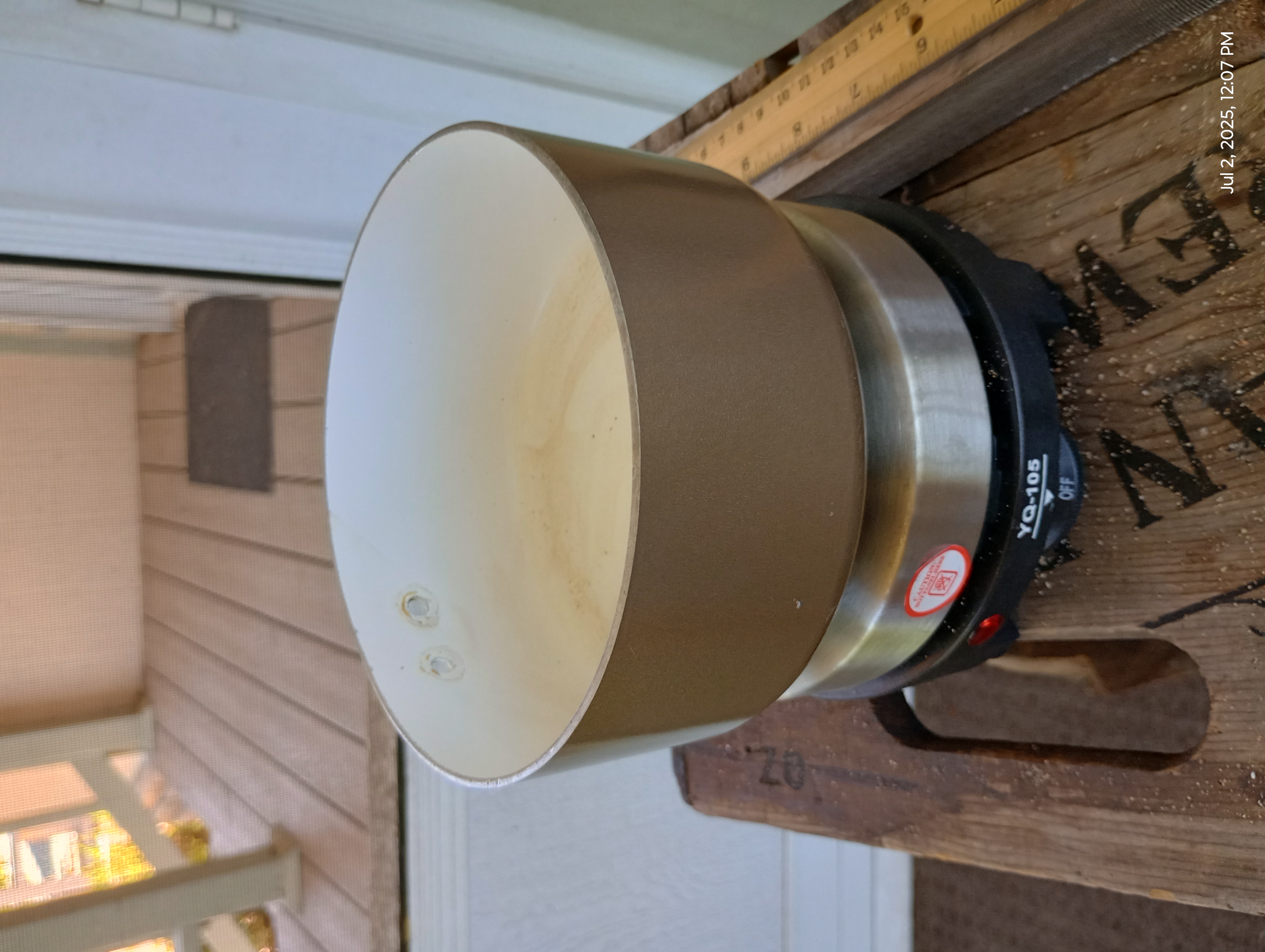

Here is my pot
IMG_20250702_120752660_HDR.jpg - 2.2MBIMG_20250702_103152707.jpg - 2.8MB

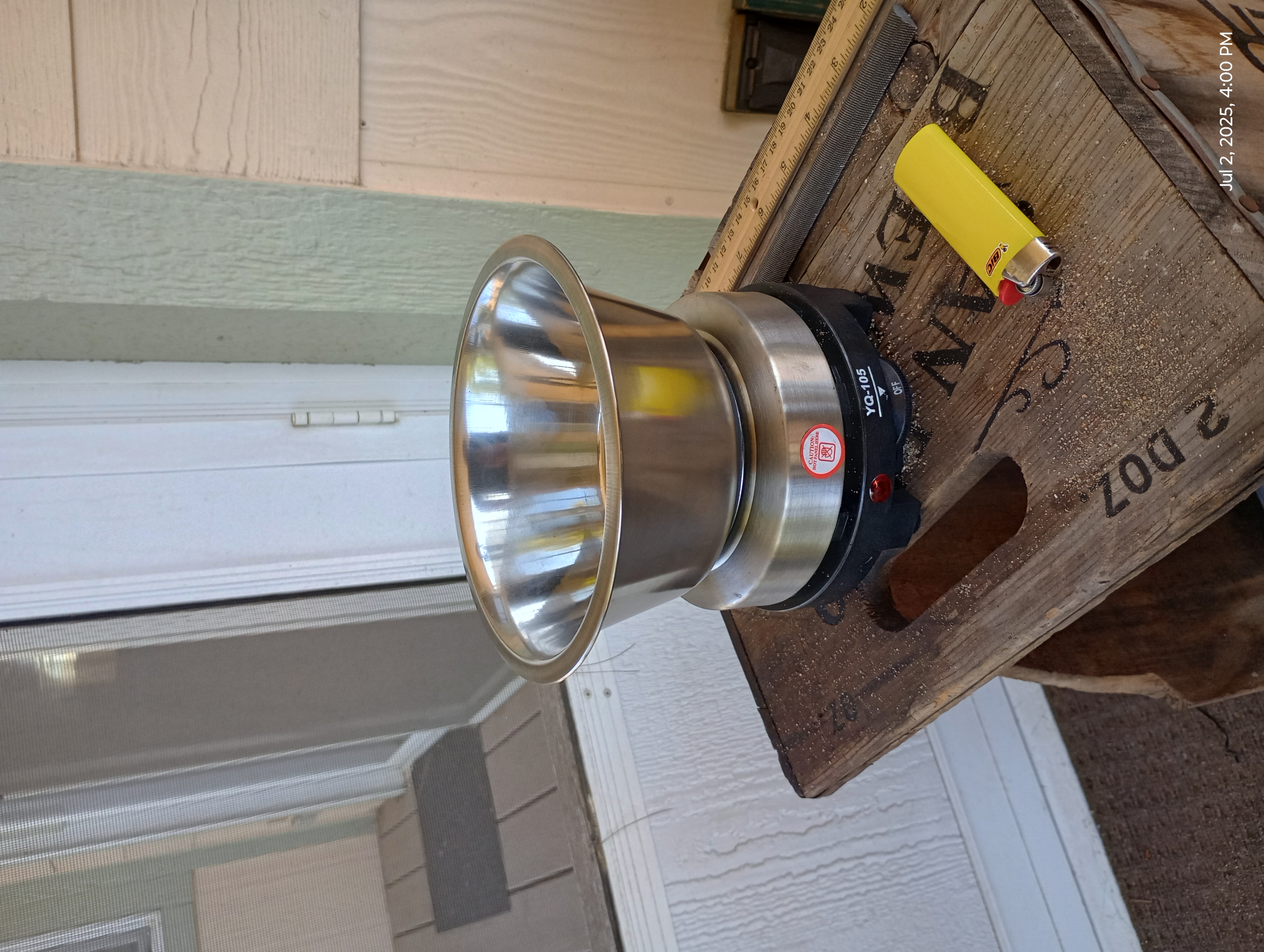

I tried getting a SS bowl from the pet store that is a little less heavy than the TFAL pot. I was also hoping for a better fit than the TFAL pot by getting the pet bowl.
Pet bowl holds 1QT it says, the TFAL bowl has holes in the sides, but I likely wouldn't need to fill it that full.
I also picked up 2 pints of mineral oil for a heating bath medium, though my sand is still drying, I may give that another go.
Which bowl would you say?
IMG_20250702_160004661_HDR.jpg - 3MB IMG_20250702_120752660_HDR.jpg - 2.2MB
TFAL bowl is 5 1/16"
SS pet bowl is 4 1/4"
Still a little bit overhands but not much
Hotplate surface is 3.9"
SS pet bowl is a lot lighter, fits the hotplate with less overhand
And I think I'll go with it
Though the TFAL pot looks nicer on the hotplate, I think.

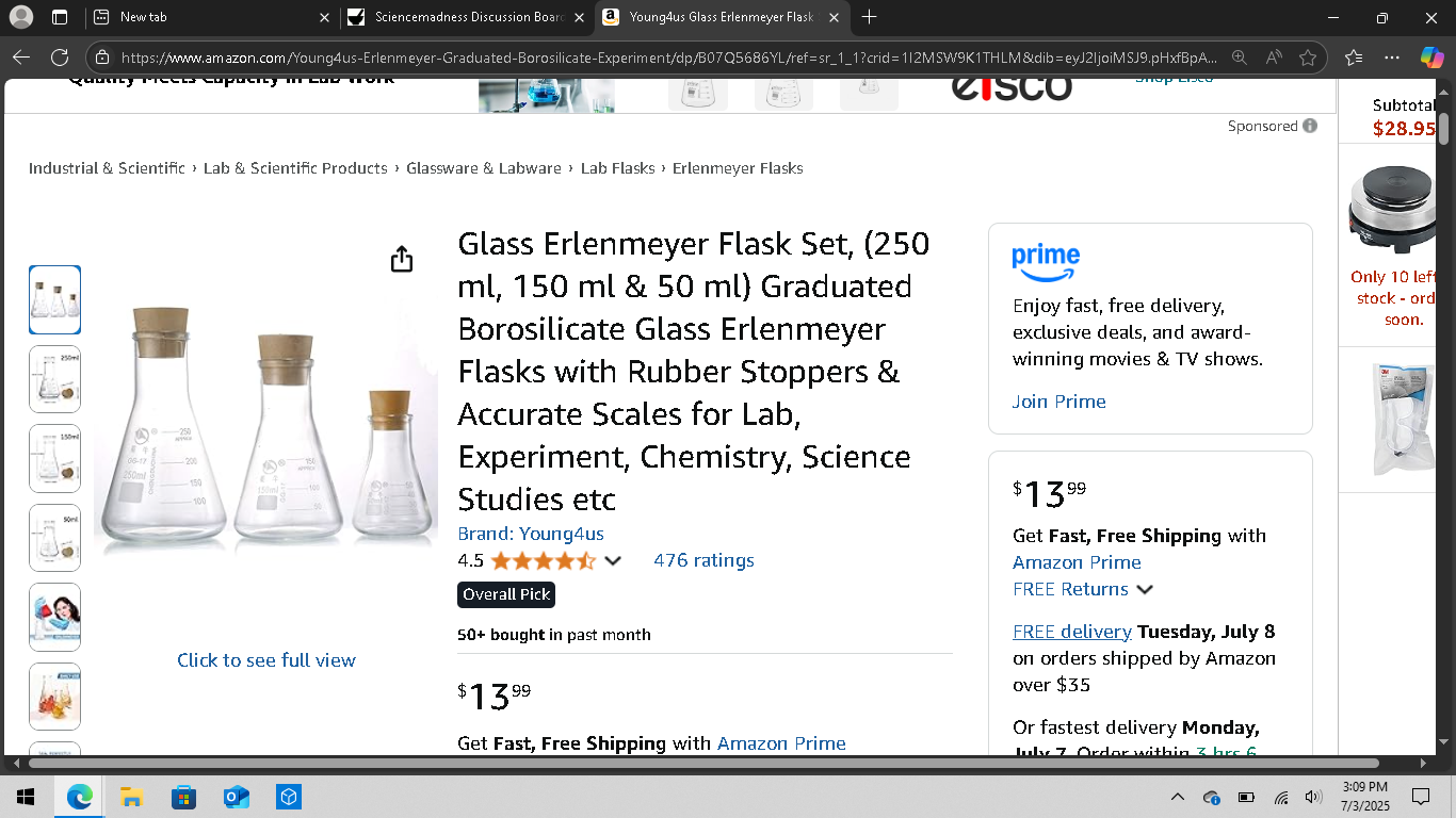

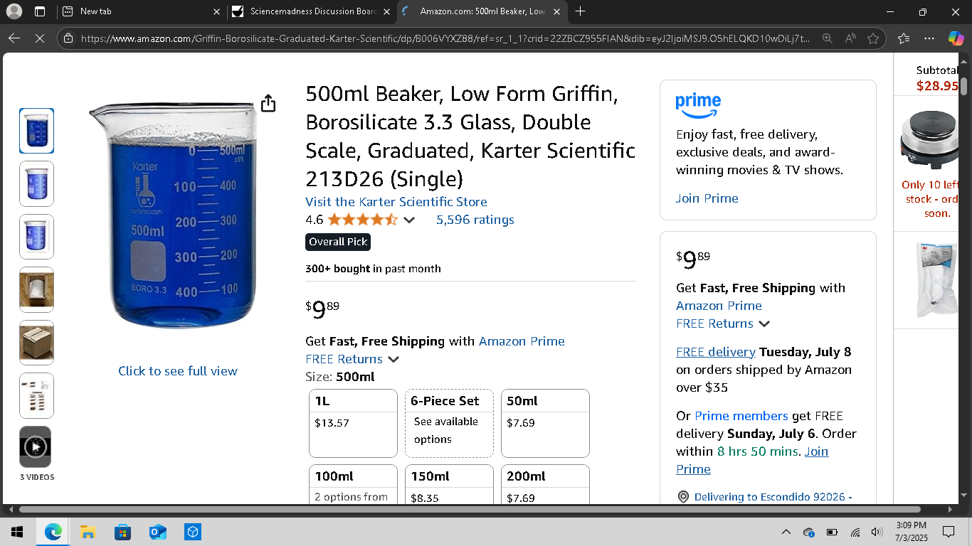

I'm going to be investing in some new flasks, not sure if I can make do with 1 500mL beaker, and a few Erlenmeyers.
but am thinking this is the lowest price set that offers the biggest bang for the buck
