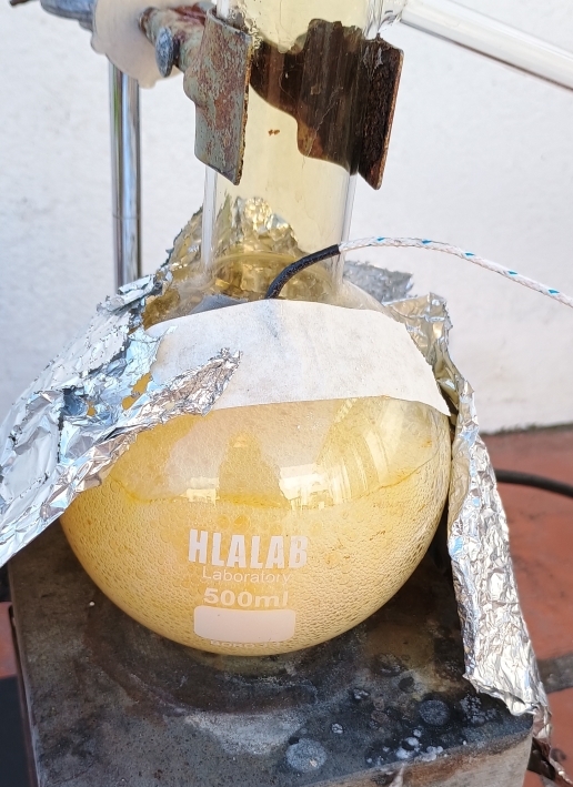

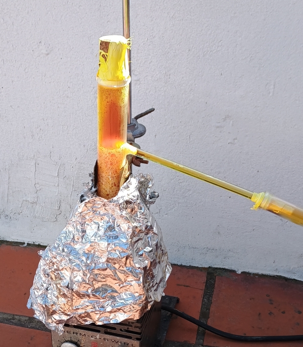

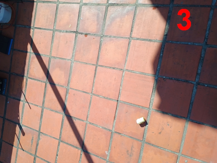

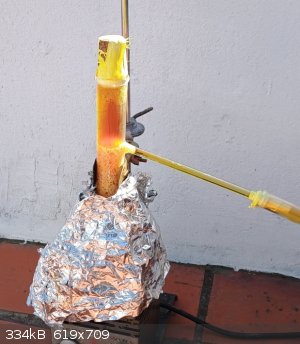

It foamed a lot. and it clogged the delibery tube (pic 2), triggering the "safety valve" (aka as flying cork, 3 meters high and 1,2 meters long - pic 03).
when cleaning I realized that the foam was like pumice stone (aereated stone) and needed a blowtorch to liquify and remove it. (boiling water was no good or too slow)
Luckily I was 2 meters away when this happened, because one can find molten salt drops 50 cm away from the launching site).

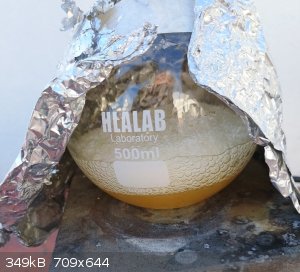

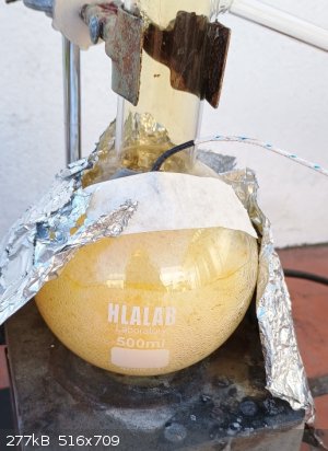

Once the brown fumes (mild) were produced, checked the flask (it was covered with aluminium foil) and there was again foam. pic 4.

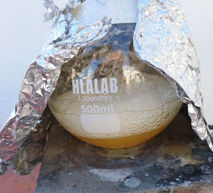

When /I thing) that concentrated nitric acid was finally destilling, there was a lot of foaming. it did not reached the top, but 75% of the flask was with foam (pic 5)
I have seen videos online that this is not normal (maybe some could share the experience with this method) and the procees is very straight foward.

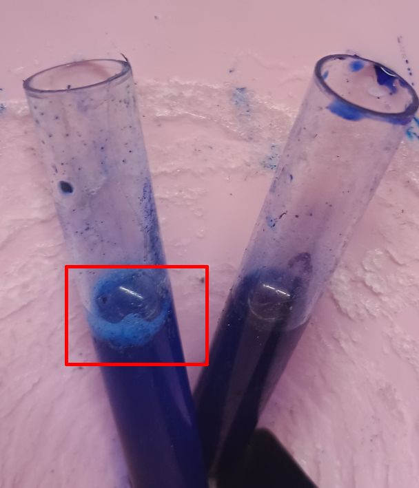

Dissolve some bisulfate in water, put the solution in a capped flask and shake it. If the bubbles take too long to burst, it means there is a surfactant.
I did this procedure with the bisulfate, no indication (bubbles dont hold), buy when I done with the KNO3, some small bubbles were hold for longer time.
1) cristallized some KNO3 (dissolving a random amount , filtering trough cotton, and once some cristals were made, removed (the orange... solution) and dried the cristals
On testing both (putting in a test tube and shaking), original KNO3 vs filtered KNO3, no much difference was seen,

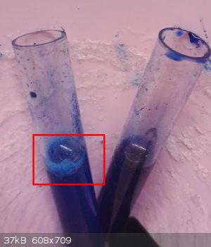

but then read: that adding methylene blue and using PP test tube, there is a qualitative test (paper attached) for surfactants.
So I took tip of the spatuta of powder methylen blue, added to each PP test tube, shook them and compare. A distintive difference, even after 10 seconds was seen. (Pic)
So the problem was not the bisulfate but the KNO3 (which wasn't like Woelen's prils, but like sugar consistency)
So will try again with the "cleaned" KNO3 if better results.
