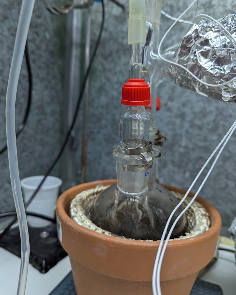

the trick is not to buy a whole heating mantle unit, those are watched like a 5L RBF
you probs wont find them through ali, but if you google "aliexpress heating mantle sleeve" you can get just the elements alone for $15-35 for 250ml-2L and they last a good long time, i used to use my 2L sleeve practically like it was an oven sometimes. a drill or any rotary tool effortlessly drills through $5 terracotta from bunnings, and conveniently theres a pot size for every mantle size. you dont have to insulate it either.
Also buy some high temperature wire and some nickle or high temp crimps, you dont need a crimper though just pliers, and make sure to tie it in a knot so you cant pull on the mantle through the holes. the high temp wire is needed to interface it. then stick a screw on plug for whatever cable youd like, like a female C14 plug, C13 is the male version and its the cable most PSUs take, especially PC PSUs. plug that cable then into a 240V dimmer, virtually any will work since mantle sleeves are only 300-500W at most and any incandescent bulb dimmer will probably be rated high enough for it, though probably make your selection based on the probability that water will spill on or near the dimmer.
And thats that.
I actually have been raided for buying too much glassware all at the one time, but that worked out fine in the very end, buying a 250, 500, 1000 and 2000ml mantle all at the same time, where i got two 250 and two 1000ml just since they seemed like the ones id reuse the most and i was expecting like 6 month lifespan, no interest, because they are not regulated in the first place, unlike the huge condensers i bought because they were dirt cheap and there wasnt even an option to buy them affordably within the country. heating mantles on the other hand at very least require an EUD, the sleeves, they do not, but you probably wont find any sleeves in the first place locally.
Lastly, to address stirring, when i need stirring i sit the mantle pot on my hot plate with stirring, the bottom of the pot though doesnt get much heat, but my thin plastic stirrer doesnt have long-range magnets like the hot plate does, but if it did, a simple air gap would be enough to protect it.
2025-09-02_184116.jpg - 141kB
edit - actually, since this one is sitting on a silicone mat, and this was from a diethyl ether synthesis, it was in fact sitting on my cheap plastic stirrer without any air gap, ether doesnt require especially high temps though, maybe 130C at most or something, and most of the mats role wasnt even insulation it was just not to press on the plastic and collide with the magnet stalling it since the entire setup was too heavy otherwise for the stirrer.

snip the nichrome short so the exposed ends cant touch no matter how they may wiggle about, then shorting will be impossible, plus lengths of red hot glowing nichrome will burn out exposed to open air much quicker, and it reduces overall resistance to cut it shorter, less resistance = higher peak power = better. Dont go crazy though, like 20mm exposed is probably fine, but it will come with like 2 inches or something at either end of surplus exposed nichrome.
its not difficult either anyway since the mantle is just a big spiral, so one pokes out near the top, and the other pokes out in the middle bottom, though it does tend to go on for a little bit but still. if you are really wigged out by that then just add an inline fuse? you can get C14 ports that have fuses built in.
3 important things: these sleeves come flexible and once run in, turn relatively solid and inflexible. so make sure to run it for the first time with a flask in there, not so much that it cant fit in a slightly different flask, but more that, you just want it nice and round is all, its still flexible afterwards but any dramatic reshaping could risk doing some damage so best to do the burn in with a flask at least for the start.
the second is, its fiberglass, resin coated glass fibers, that resin will burn off like crazy so, first time, increase heat slowly, because that smoke, if its thick enough, can be arced through burning the nichrome where it happens, same way a mantle might fail if water spills onto it. While i havent blown a mantle from the smoke, i have DIYd another sort of aparatus using fiberglass, and during the burn-off i ran it too hard and it arced between windings due to the smoke and/or soot buildup, popping the wire. the resin evaporates away cleanly but too hot too quickly can lead to charring which is electrically conductive and not great to have on your ceramic insulation.
third; since its essential that clay pots be wet when you drill or cut them or else it just fuses into glass instead of cutting like its hardened bread dough, your pot will be wet for a while after, so be mindful of that fact as well when doing the burn in. they dont have to be bone dry just dont do what i did accidentally and crank it up so hard it steamed and sweated, the clay conducts electricity when wet, we use it for an electrolysis membrane sometimes, so its a hazard if its wet. steam also can cause windings to arc and burn the wire, so, air out in the sun for a day and again, slow and steady so theres little smoke or anything else. the smoke from the resin is also super nasty like burning a motherboard

Rather than cut off your excess nichrome, you'd do better to fold it and twist it so you get a thicker, lower resistance, cooler connection point. Crimp your connections - solder will melt, and nichrome is a bitch to solder anyway. In the hot zone use silicone insulated wire, or solid wire with fiberglass sleeving.
