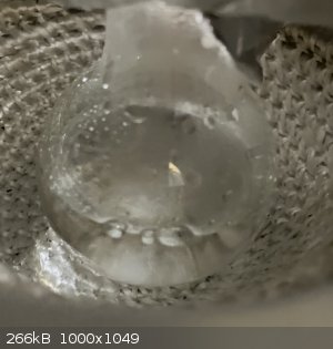

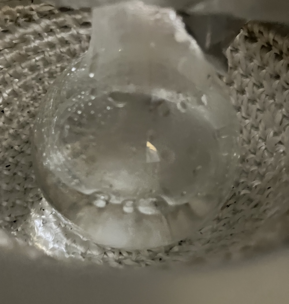

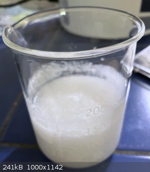

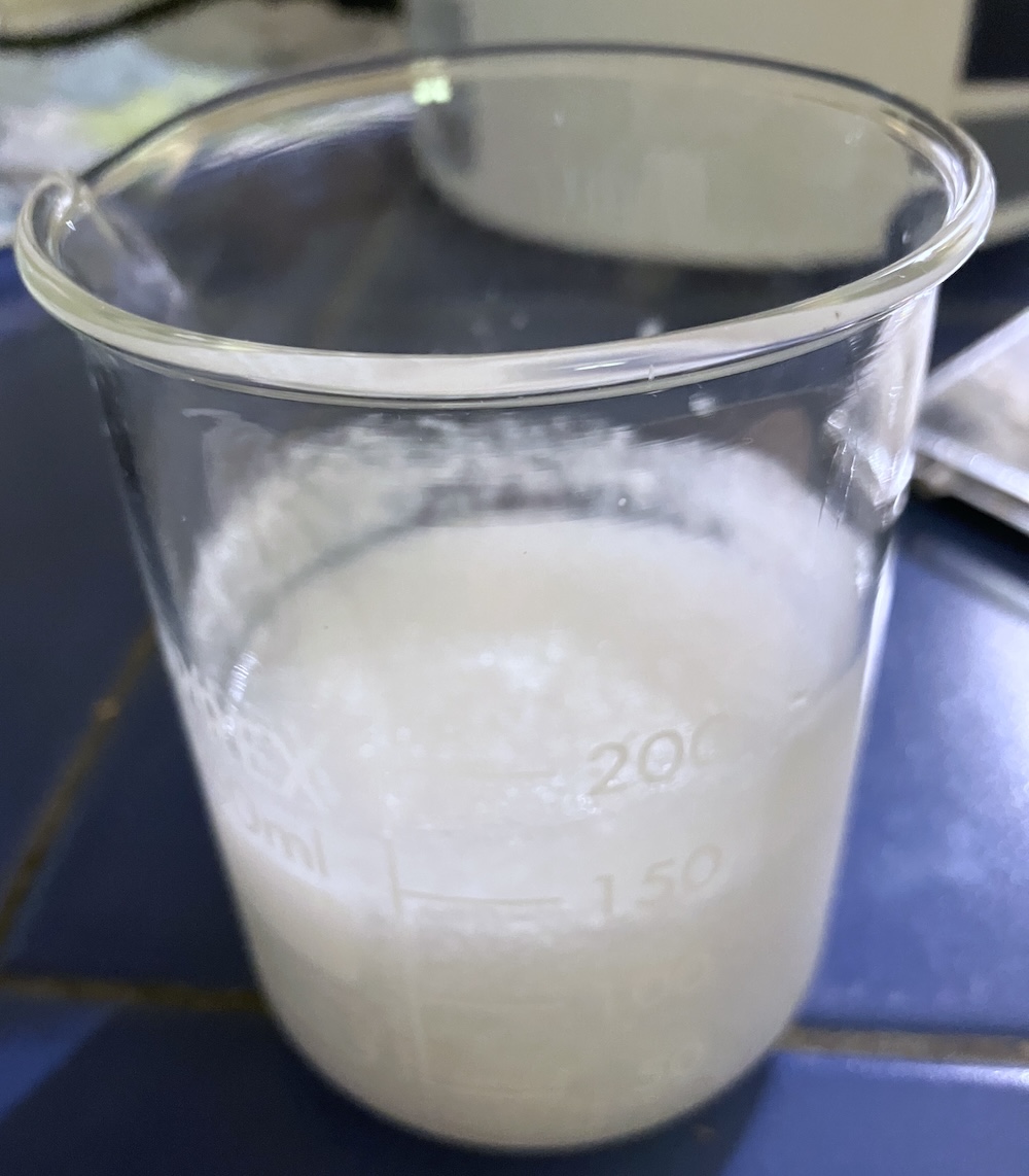

Okay, so I can confirm this works. 10 mL aniline + 30 mL acetic acid + 0.6 g Zn → Reflux at 160 °C for 90 min+ → acetanilide. Problem is the yield: I got only circa 30%. This is however really weird.
First off, this method seems to produce a highly pure product even without recrystallisation. After about 40 minutes+, the zinc dissolves completely and the resulting liquid is crystal clear (see picture). When this colourless mixture is poured into cold water, pristine white flakes almost immediately crystallise. I filtered those crystals, and the filtrate showed no sign of unreacted aniline. When I weighted the crystals, still slightly damp, I found about 15 g, which would, taking into account the extra water, correspond to an almost quantitative yield, consistent with the absence of leftover aniline.
I recrystallised the product using 100 mL (minimum amount) of water brought to boiling until all the acetanilide dissolved, and, after drying and 2 hours in my vacuum desiccator, got only around 4.75 g of dry flakes. So, either the flakes hold on to a lot of water, and the yield is poor (but in this case, where did the unreacted aniline go?), or somehow I lost 66% to recrystallisation, which seems unlikely given I cooled the recrystallisation beaker down to almost 0 °C.
So what???
[EDIT : Picture of flask in the heating mantle while being refluxed and crystallisation thereof when it is poured into cold water.
IMG_0292.jpeg - 241kB
[Edited on 21-9-2025 by Keras]
IMG_0291.jpeg - 266kB

[*] posted on 21-9-2025 at 12:56
What is the melting point of your product? What else is in the filtrate?
Good to see that it (apparently) works. I suppose that who typed the book forgot to put a "1" before "60 °C" and no one bothered to revise the final version. A suggestion: when reproducing experiments from that book, only follow the instructions given in the references.
