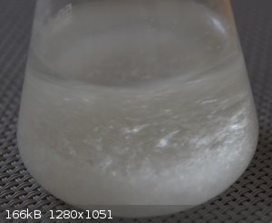

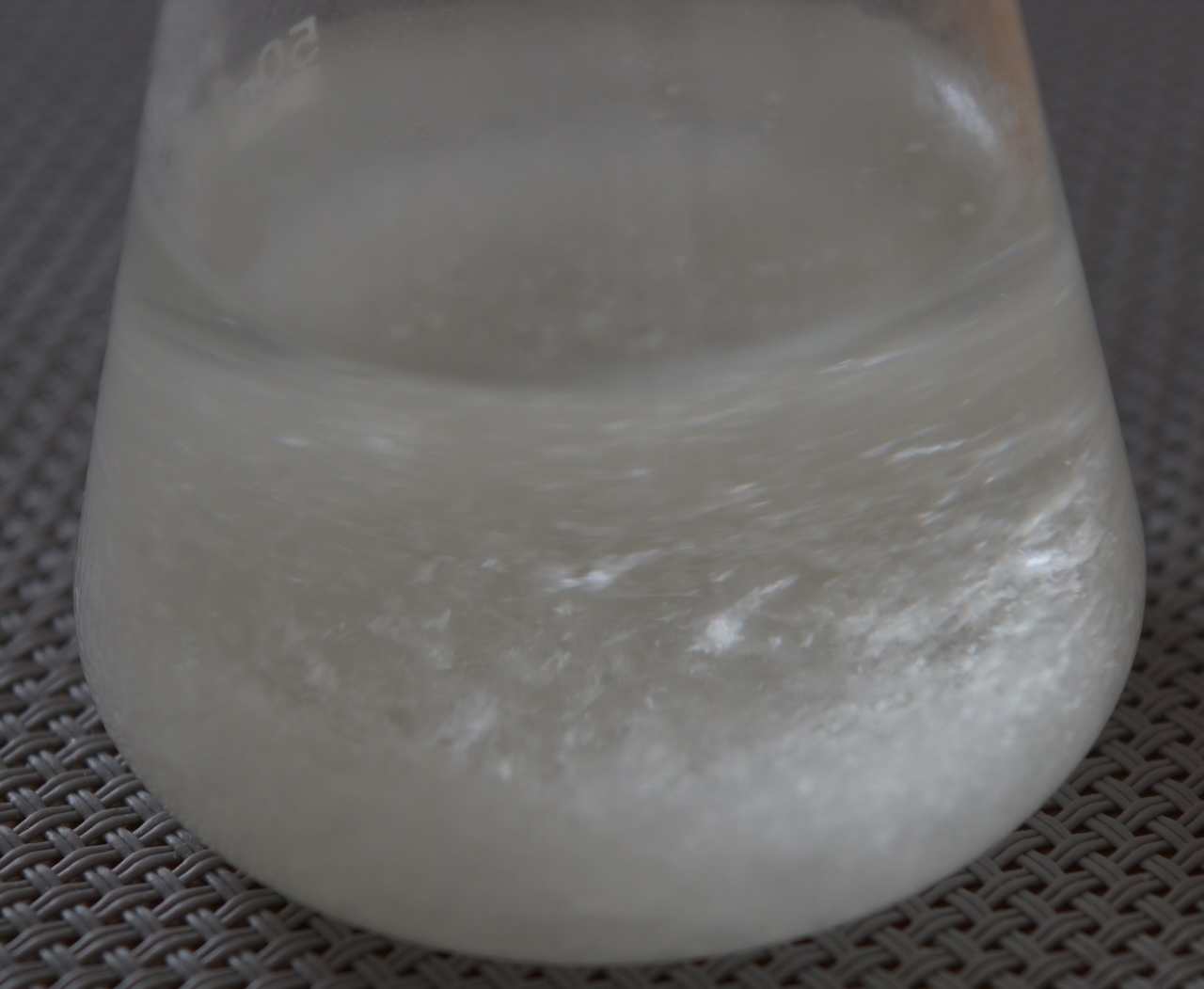

because I had a few grams of acetalinide I made while testing the synthesis without acetic anhydride, and I didn't know what to make of it, I decided to go ahead and make paracetamol in a rather winding way:
acetalinide → para-nitrosoacetanilide → para-aminoacetanilide → diazonium salt → paracetamol.
For the sake of brevity, I won’t detail all the steps, unless you want me to spell them out. In any case, I’m just halfway through it and I have obtained some very nice, pristine white crystals (see picture), but I’m not sure they are para-aminoacetalinide. I fear they might be:
– Unreacted acetalinide (although they don’t really look the same).
– Sodium acetate (I had to use acetic acid to dissolve acetalinide for the nitrosation, and later to neutralise the pH after it).
Apart from going on, try and diazotise them, what could I do to ascertain their nature, given that I can’t measure their melting point?

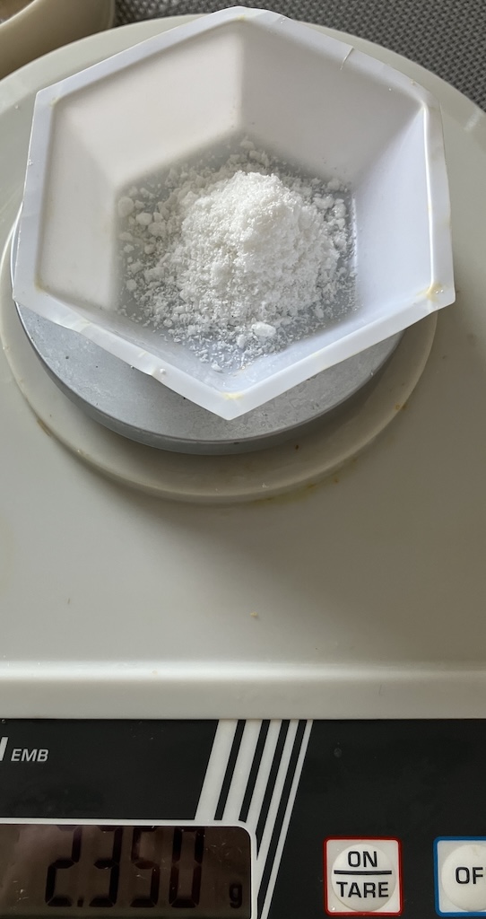

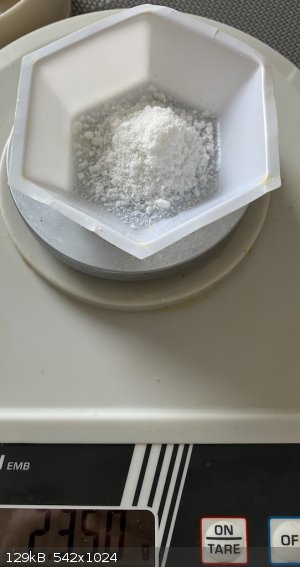

[EDIT] Since that message I filtered the mixture and obtained a batch of white fluffy crystals with a very faint, but I think characteristic smell of what I classify as ‘aromatic amines’. It’s difficult to characterise, but it’s about the same as para-aminophenol. Vaguely fishy, soapy maybe. Seems a good omen. In any case, not at all related to nitro compounds (as I experienced them).
[EDIT 2] So the crystals are now more or less dry, I weighted them and got 2.35 g, which is of course impossible since I started with 1.35 g of acetanilide, i.e. 10 mmol. p-aminoacetanilide has M = 150 g/mol, so… there’s definitely 850 mg of something else in these crystals (or maybe remaining water? Water of crystallisation? Some hydrate form? Sodium acetate?).
