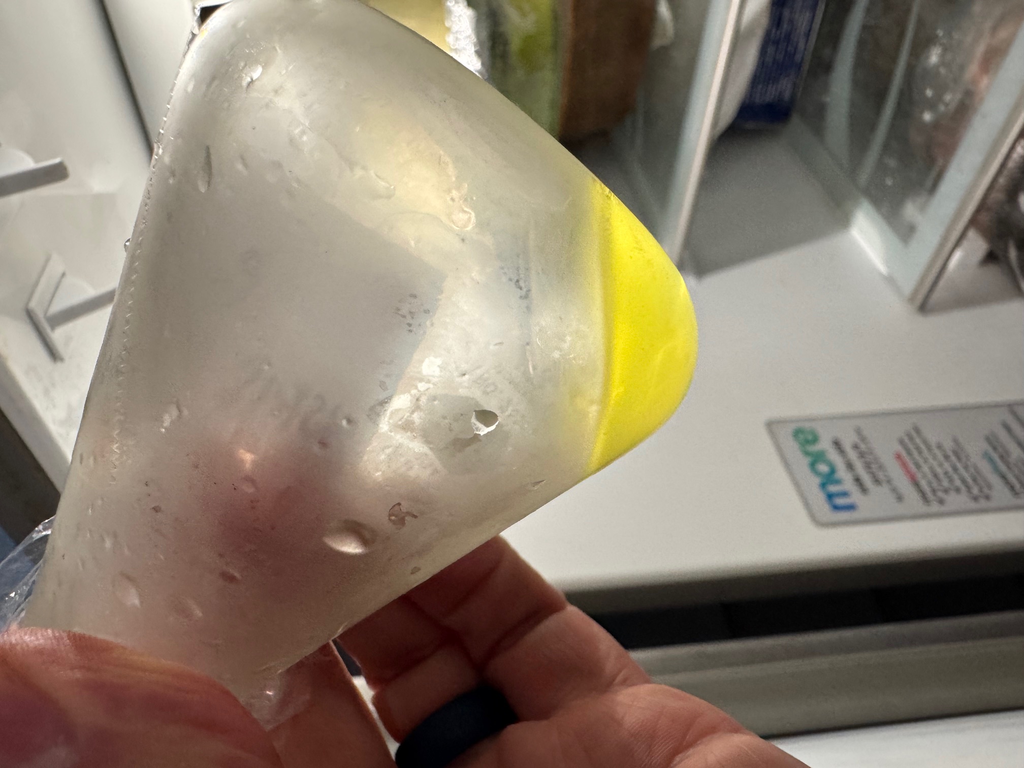

Howdy all!
Briefly - realized I had no sulfuric acid today but did have HCl.
So cooled off and then mixed 1/2 mol each ethanol and HCl.
Dripped this into a 1/2 mol of sodium nitrite in water in an ice bath.
I do believe what I got in the end was a small amount of ethyl nitrite (which I'm using to make "Sweet Spirit of Nitre" which is 4% ethyl nitrate in high proof ethanol. It was used in a few metal bluing recipes in the late 1800's - early 1900's. I don't actually think it serves much purpose but I plan to make a few solutions with and without it and see if there is any discernable difference. Anyway, yield sucked. I'll try again after I find some sulfuric acid.

I think HCl is okay these nitrite esterifications anyway. How good was your cooling? pure EtONO boils at 17 degC

[*] posted on 3-10-2025 at 16:37
Fair. Probably lost some because I mixed the alcohol and acid then dripped that into the nitrate solution right after mixing them.
Next time I plan to mix H2SO4 and ethanol ahead of time then cool then add to the sodium nitrite solution in the ice bath.

Posts: 8146
[*] posted on 4-10-2025 at 10:45
Keep in mind that quite some ethyl nitrite dissolves in the aqueous layer. This may lead to considerable losses.
Another option may be to use a warm solution of ethanol in 15% HCl and add warm drops of concentrated solution of NaNO2 to this and lead the gas through ethanol. This gives you ethanol with the nitrite ester dissolved in it, but some water vapor also makes it into the ethanol. If this is an issue then you may need to lead the gas through a tube, filled with dry and somewhat warm CaCl2.
