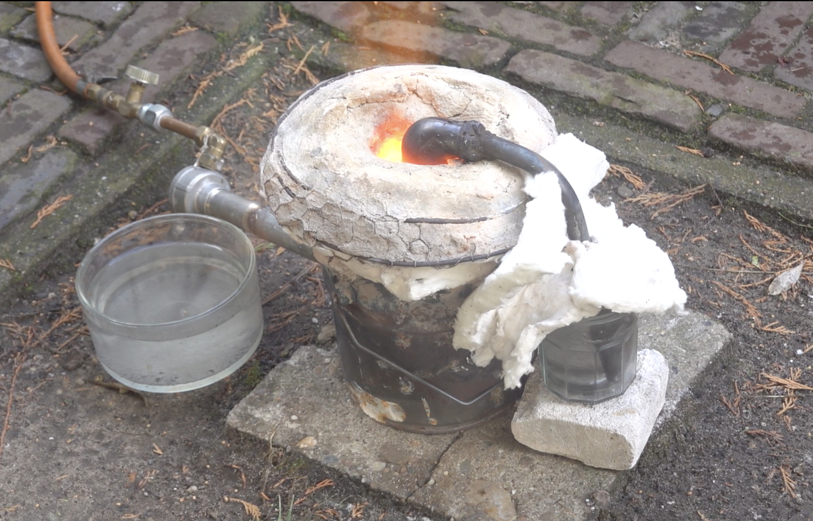

I put the mixture in a 316 stainless steel retort with its neck dipped in mineral oil. The same setup as I used successfully with KOH + Mg which
indeed yielded some K balls in the oil.

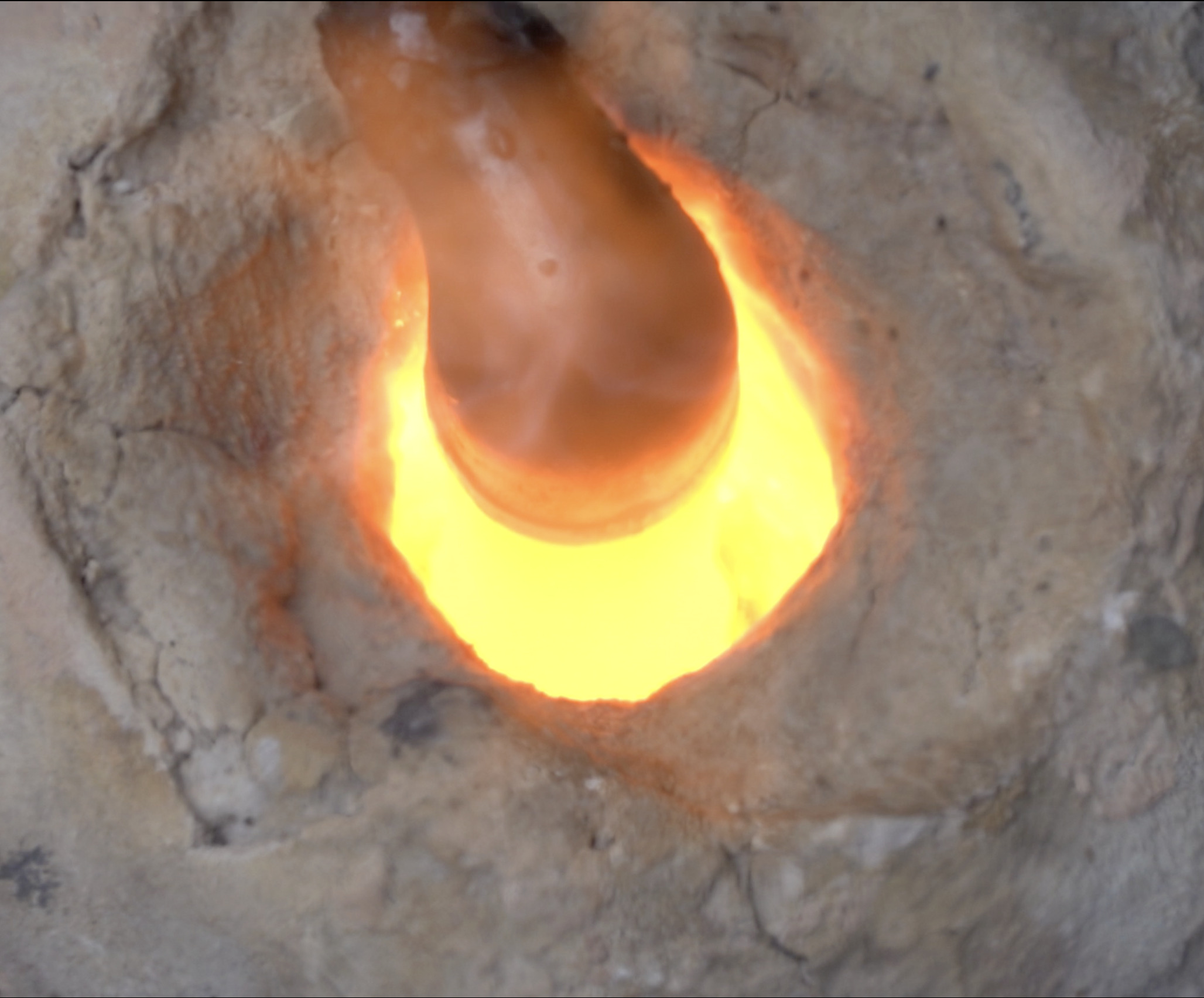

Now I heated it to 1200 C (checked with an infrared pyrometer on the bright orange body of the retort) for a few minutes until bubbling ceased.

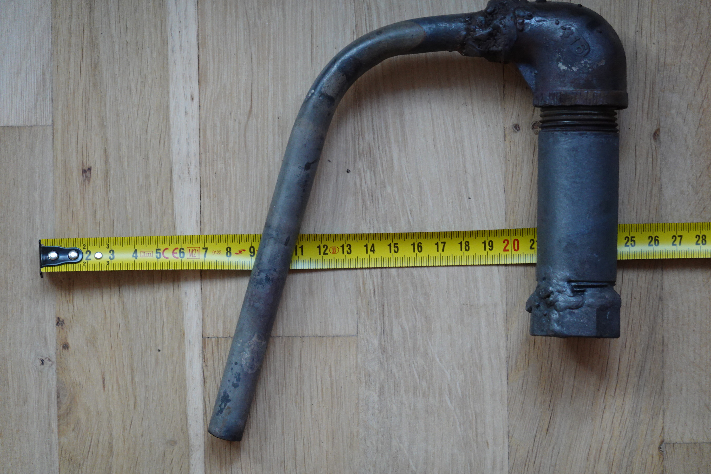

After opening and dumping the retort into water I heard a few small explosions inside the tube but the top part was full of foamed stuff. Weird,
because the lower (hot) part of the retort was only filled half full at the beginning with the charcoal powder with the pre-dried K2CO3 on top. Now it
was empty. The top part contained black frozen foam.
What did actually happen ? It appears that the liquid K2CO3 started to foam with the charcoal powder as CO gas appears.
On the pictures, the furnace running and the retort after use.
