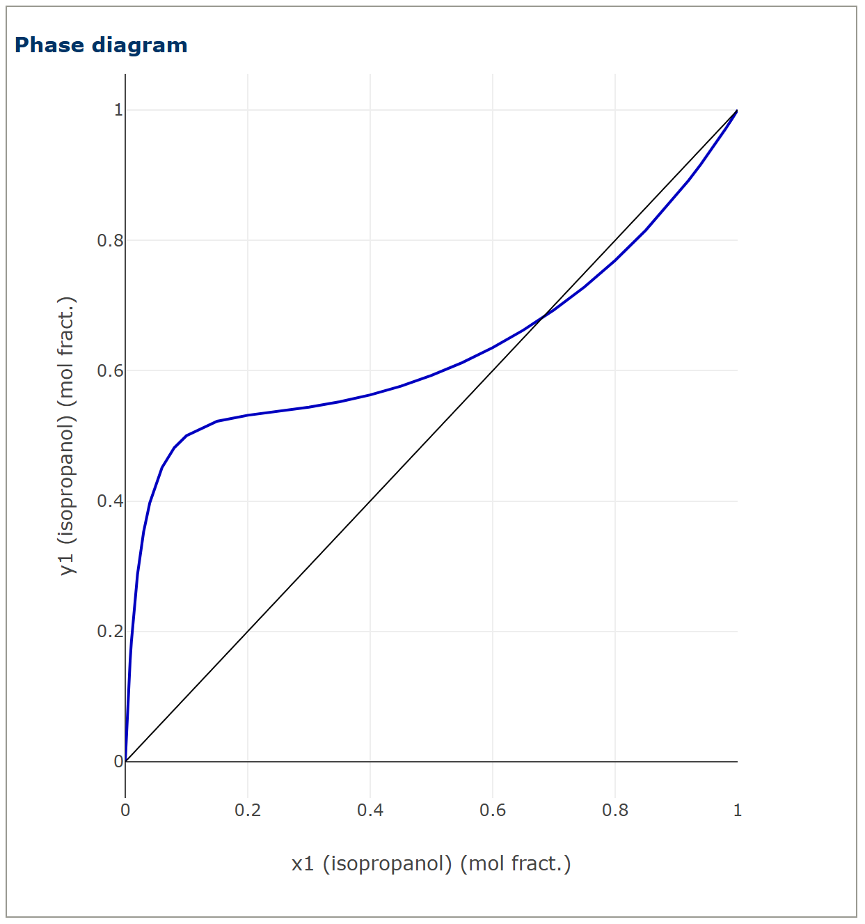

[*] posted on 10-10-2025 at 07:45
18 C difference seems pretty significant no? That's about the difference between 2-propanol and water is it not? I'd assume a Vigreux is probably good enough. Non azeotropic mixture too at that. I've had pretty good success concentrating 2-propanol via distillation when I first got started as a practice. Is there something I'm forgetting to consider that would make a difference here? Obviously aiming for high 90s is unreasonable and I don't plan on getting there by distillation alone, likely get to around 90% then concentrate to 98-99 by other methods.

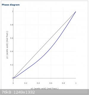

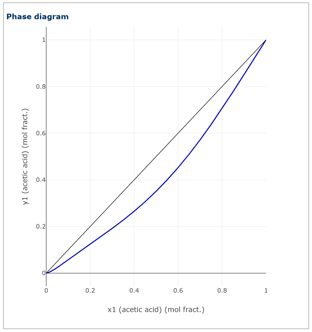

[*] posted on 11-10-2025 at 10:38
Hmm, I see what you mean. The mol frac of acetic acid in vapor is quite close to the mol frac of acetic acid in the mixture at any given point. The difference for say iPrOH is a lot more dramatic than that of acetic acid. In that case, I don't suppose fractional distillation would be a particularly viable method. Guess I'll have to do something else.
Screenshot 2025-10-11 113543.png - 76kB
[Edited on 11-10-2025 by Deo]
Screenshot 2025-10-11 114100.png - 75kB

I’ve found that drying acetic acid in general is quite difficult, even at high concentrations. Repeated distillation over sulfuric acid did nothing, the only way I actually got it anhydrous was distilling over acetic anhydride.
