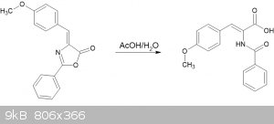

The first step however is the following ring opening reaction:
azlactone amino.gif - 9kB
The Galat paper references one method for this process, but a more straightforward method is provided in a more recent paper "Phenylpyruvic Acid Derivatives as Enzyme Inhibitors: Therapeutic Potential on Macrophage Migration Inhibitory Factors" (Carpy, Haasbrook, Oliver 2004, doi 10.1007/s00044-004-0102-y)
10.08g of the azlactone (a bright yellow crystalline solid, MW = 279.29, 36.1 mmol, MP 152C - 154C) is refluxed for 5 hours in 140ml of 93% acetic acid solution, until no trace of source material remains (TLC 10:2:1 Toluene:AcOH:EtOH). Rf of azlactone is 0.73, with product Rf 0.37.
The product crystalizes as the solution cools. The white material is washed twice with 1:1 AcOH:water.
Yield: 7.99g @ 297.31 = 26.9mmol = 74%.
MP: 226C - 229C.
I'll followup in the near future with a report on the amidation step.
A question: the Galat paper uses naming nomenclature I am struggling with.
Can anyone verify if N-benzamido-4-methoxycinnamic acid is a "correct" name for the result?
It's quite misleading, and definitely not standard. 4-methoxycinnamic acid and benzamide describe the two parts of the molecule that are linked by the C-N bond, but the name says nothing about where that C-N bond is.
A more accurate name would be N-benzoyl-α-amino-4-methoxycinnamic acid.
