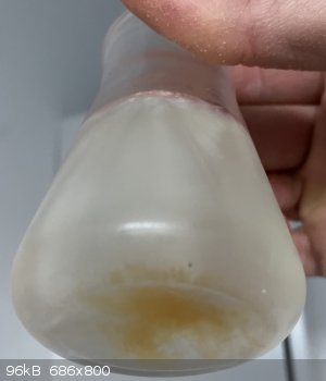

Two failed experiments: 4-aminophenol and benzocaine
Folks,
I tried two distincts experiments this weekend, and they both failed, and I was curious to know if you had thoughts to share about any of them.
Benzocaine: this is probably the simplest of all. Basically a Fisher ester synthesis between PABA and ethanol. But I can’t get it to work. Even with a large excess of ethanol (15 g PABA, 50 mL 99% ethanol, 1.5 mL 70% methanesulphonic acid) and two hours cooking, it doesn’t work. With that combination, when the mixture is poured into 250 mL of sodium carbonate saturated water, the crystals (very nice btw) I get after cooling turn out in the end only to be hydrated PABA (they melt around 40 °C releasing their water of crystallisation). True, there is a sort of plateau around 90 °C, but nothing really melts, and after boiling off the water I’m left with a solid white powder which: 1. doesn’t melt around 90 °C as expected; and 2. has no perceptible numbing properties. It must be unchanged PABA.
Now I’m wondering whether all the acid doesn’t go into the protonation of the PABA NH₂ group, leaving effectively no free protons, which would explain the failure. Do I have to add a little over the stoichiometric amount of strong acid so as to protonate all the amine group of the PABA? In hindsight, that would make sense.

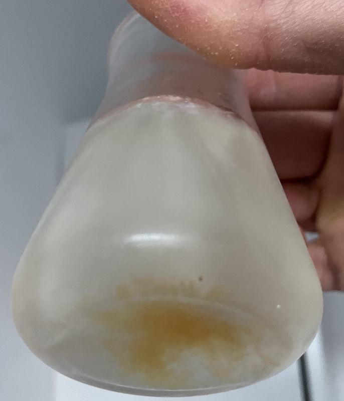

4-aminophenol: This is normally made by reducing 4-nitrosophenol (obtained by nitrosation of phenol under 0 °C, this step works fine) with sodium hydrosulphite. Problem: albeit that all the brown/orange colour characteristic of 4-nitrosophenol disappears as expected, and is replaced by a pale yellow somewhat turbid solution, I can’t get anything to crystallise out of it, even at pH=7, at which the solubility of 4-aminophenol is said to be minimal.
After a couple of hours in the fridge, there is a slight powdery layer at the bottom of the beaker, but it’s only a handful of milligrams (out of 10 g phenol), that turns from white to bluish when exposed to the air. I saturated the solution with salt, to no avail. Finally I tried to extract the 4-aminophenol from water using DCM, and got something somewhat unexpected: while the DCM layer is colourless when it collects at the bottom of the sep funnel, once exposed to air it immediately turns into an intense fuchsia/purple coloured liquid reminiscent of either iodine or potassium permanganate (see picture). Boiling the DCM off, I recovered a handful of small dark crystals, which do not really dissolve in water but colour it yellow. When acid is added, the yellow turns to red. When the solution is made basic, it turns to blue, then somewhat brown. What kind of pH indicator can this be?
Maybe 4-aminophenol is not soluble in DCM? I should’ve tried diethyl ether, or ethyl acetate instead.

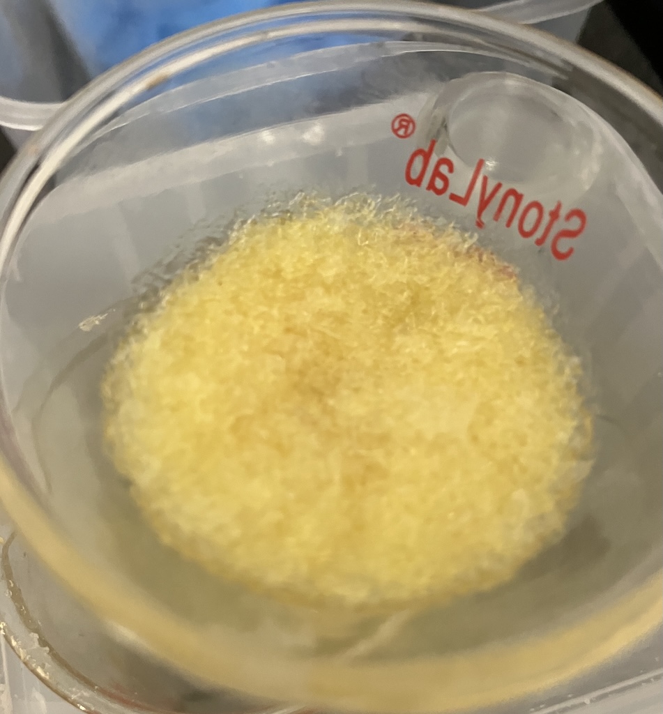

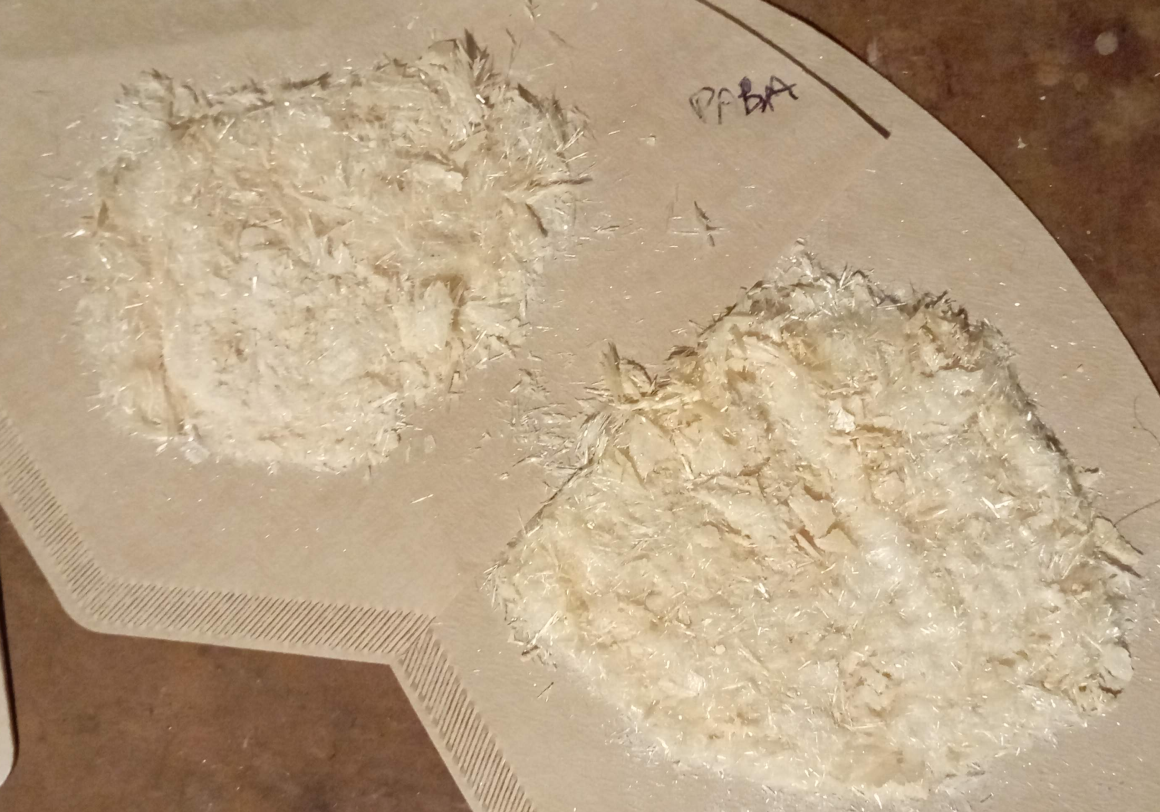

So I retried the synthesis using what I thought was PABA, but it turns out it was mainly sodium carbonate I had used to basify the fresh water I had poured the mixture into.
Anyways, there must've been a few milligrams of leftover PABA in it. This time I used an excess of acid, household alcohol, and got, after 90 min refluxing, pouring into cold water, raising the pH to 10 using sodium hydroxide and leaving the erlenmeyer in the fridge overnight, the result you see in the picture. While the big crystals are, I think, hydrated sodium sulfate, can the few yellowish/orange flakes seen at the bottom be benzocaine?
IMG_0357.jpeg - 96kB

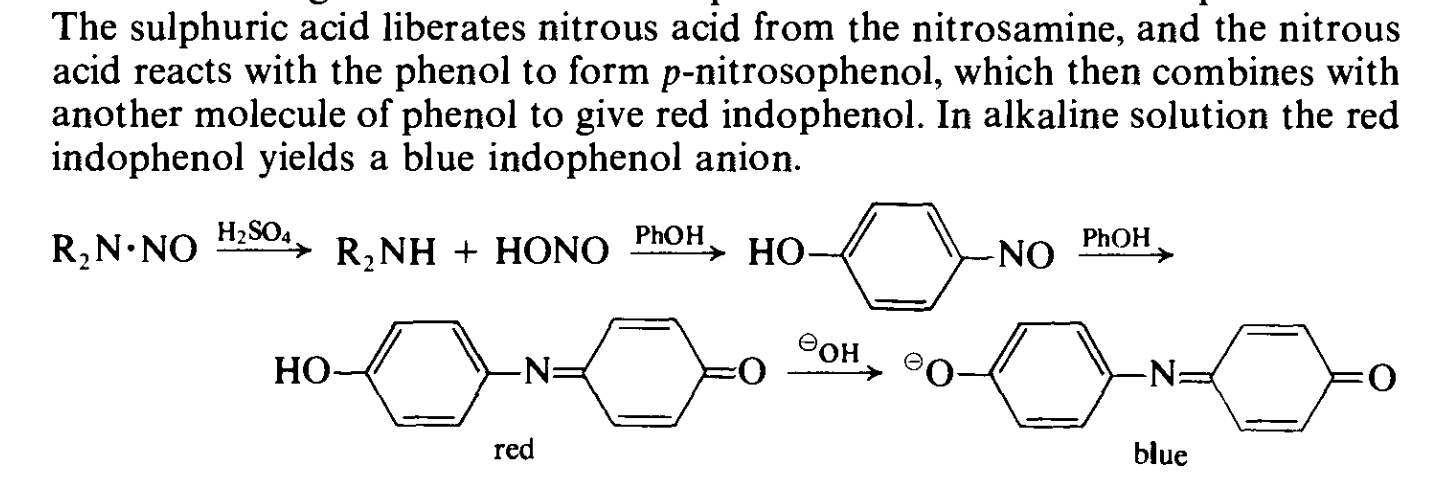

[*] posted on 21-10-2025 at 06:21
Not 4-nitrophenol? Did you follow any procedure from, say, Org. Syn.? I have to admit it is the first time I hear of 4-aminophenol by reduction of something other than 4-nitrophenol.
The way the "indicator" works suggests me a quinone. See if reacts with KI+HCl.
Interesting.
Nitrosation is taken from this pathway (see picture).
IMG_0358.jpeg - 176kB

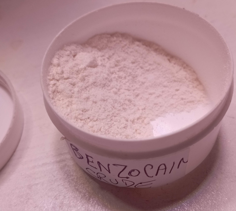

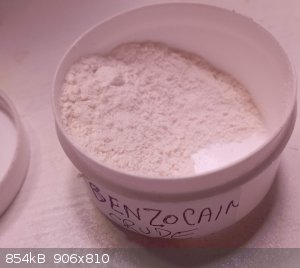

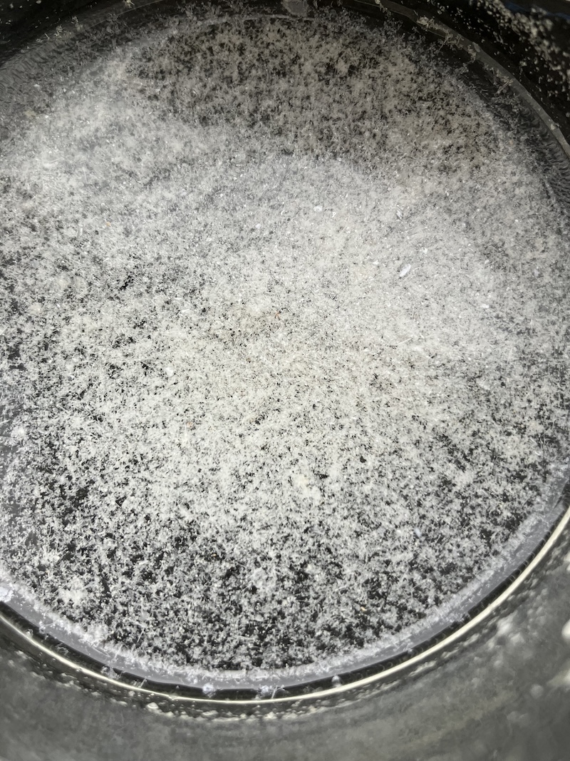

[*] posted on 22-10-2025 at 22:51

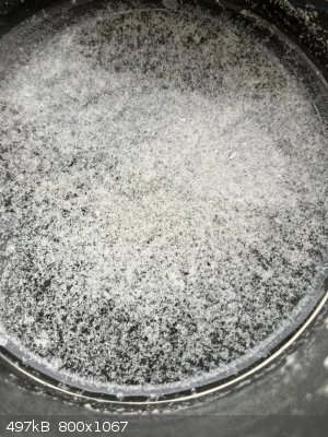

So I redid the benzocaine experiment with fresh PABA I ordered (pills), household cleaning alcohol and enough 37% sulphuric acid to get the mixture really acidic (pH < 1) and I think it somewhat worked. Of course, I didn't get such a high yield given how much water was present from the get go, but at least I've got a product that seems to have a numbing effect. I’m going to assess the melting point later this morning.
The capture of protons by the NH₂ group is something to take into account. In hindsight, it explains why my previous attempt at making methyl anthranilate failed miserably.
[EDIT: Picture of benzocaine after recrystallisation from boiling water.]
[Edited on 23-10-2025 by Keras]
IMG_0362.jpeg - 497kB
Posts: 2910
[*] posted on 23-10-2025 at 05:57
That is great. This is one case where full protonation of the amino group is needed before much else will happen, I would likely try to use 2 eq of acid. The amount of water and other bits (like denaturants) will lower the yield, but sounds like it worked enough. And trying to do the coupling with other methods would likely cause side effects from the amino group making the amide polymer.

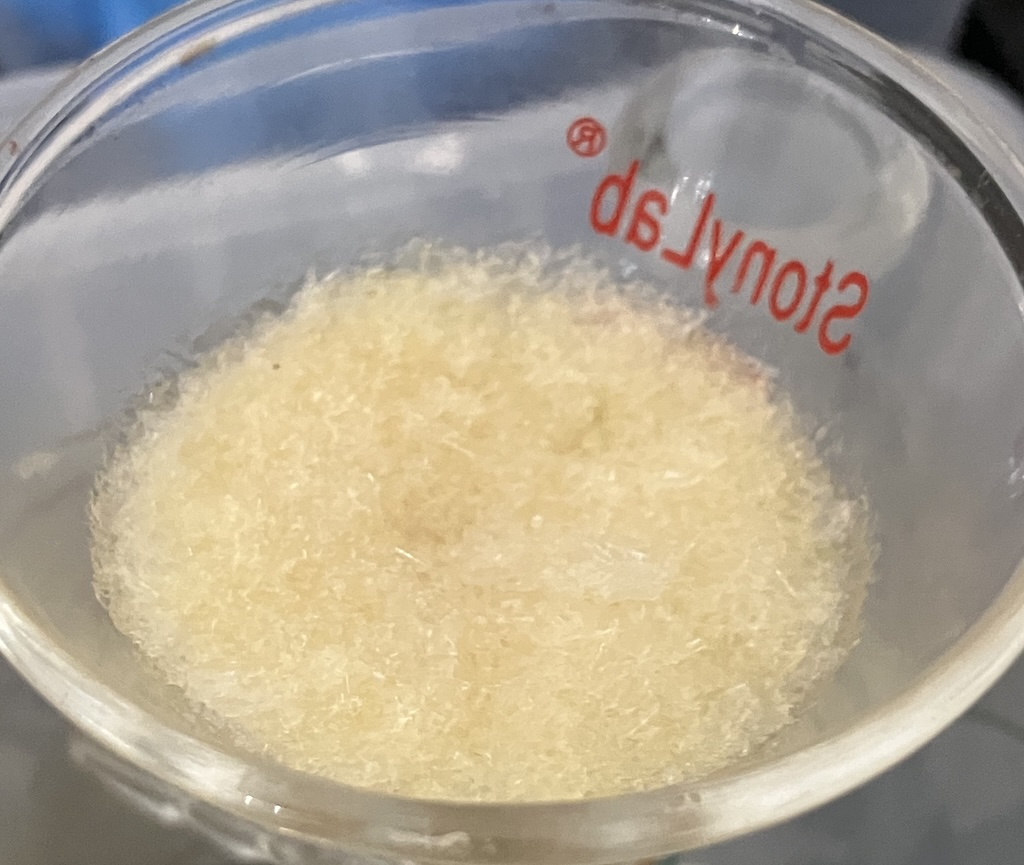

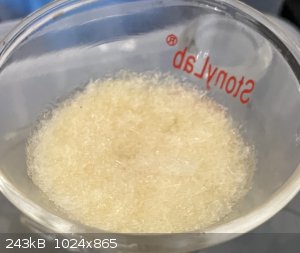

[*] posted on 26-10-2025 at 11:42

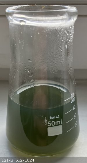

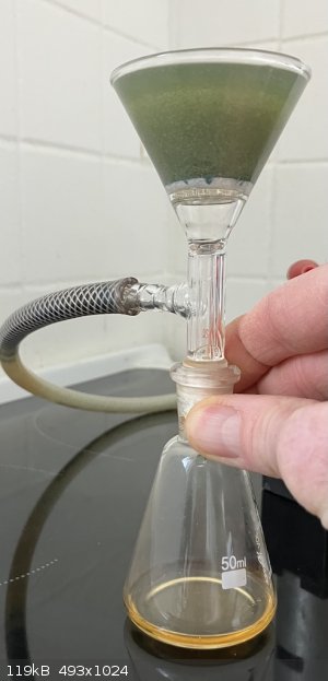

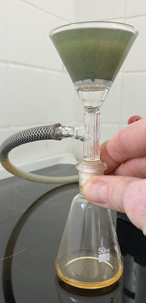

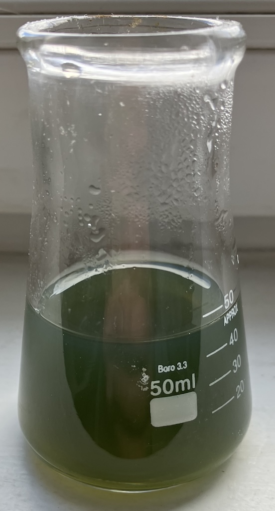

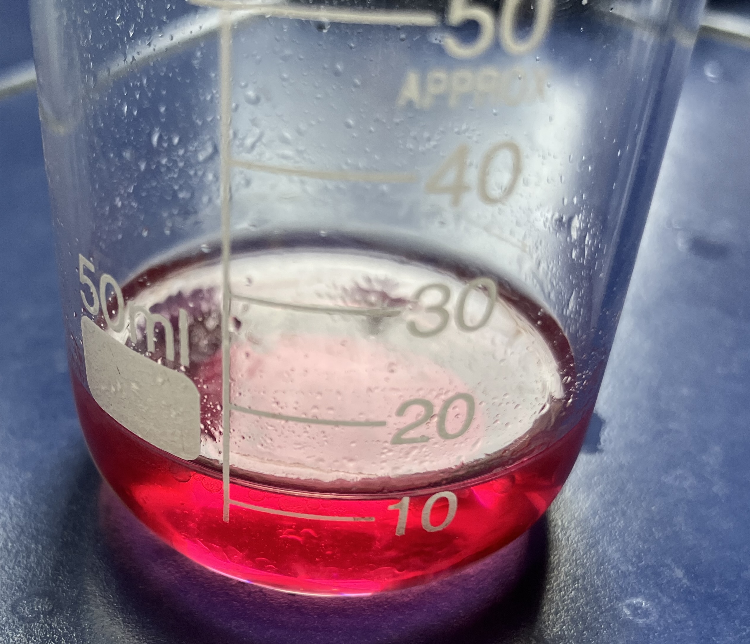

So, follow-up. I redid the 4-aminophenol experiment following more or less the protocol written on the paper (especially the quantity of sodium hydrosulfite). The brownish crystals dissolve after the sodium hydrosulfite addition and the solution turns to green (picture). It is stirred for 10 min at 45 °C then cooled and filtered.
When filtered, the funny thing is that the solution to filter is green, but the filtrate is yellow (see picture).
I recrystalled the precipitate and got a crop of nice colourless crystals. I was somehow unsure this was 4-aminophenol, but the crystals are browning by the minute (see pictures), as it said Rodinal™ does, so this must be the real deal. I’ll try to transform it into acetaminophen tomorrow using reductive acylation with acetic acid and zinc and see what's coming off it. Yet, I'd be interested if anyone had a means to test that this is really 4-aminophenol.
[EDIT] Because I fear the crystals are just some sodium salt covered in a thin layer of 4-aminophenol.
PS: I suppose p-nitrosophenol is first reduced to phenolhydroxylamine (OH-⏣-NO → OH-⏣-NHOH) and only then phenolhydroxylamine to 4-aminophenol OH-⏣-NHOH → OH-⏣-NH₂ + H₂O. My mistake was probably to not use enough sodium hydrosulfite, which would’ve blocked the reduction at phase 1.
IMG_0405.jpeg - 121kB IMG_0407.jpeg - 119kB IMG_0409.jpeg - 243kB IMG_0410.jpeg - 221kB
[Edited on 26-10-2025 by Keras]
