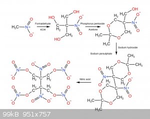

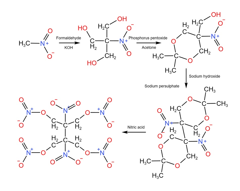

I ran across a far more convenient route to SMX, the intermediate tris(hydroxymethly)nitromethane (THMN) is made via a much cleaner reaction of nitromethane, paraformaldehyde with a touch on KOH in ethyl acetate which produces very nice white needle crystals free of the orange resin which forms when done in aqueous solution. I've repeated this reaction, it is very good.
The next reactions run very smoothly as well, The dehydrative condensation of THMN to acetone using P2O5, surprisingly results in a nice white crystalline powder when the resulting gum is dissolved in water.
The 3rd step, the oxidative coupling of the ketal protected compound is smooth as well, using NaOH and sodium persulphate, its precipitates freely from aqueous solution, the published reaction time I believe may be excessive it seems to drop out quite quickly. However, recrystallisation from ethanol was necessary to free it from an insoluble higher melting point product. It forms nice glittering plates from ethanol tested for correct mp. of 131C.
The only real stumbling block is the nitration, you have two choices, direct nitration of the ketal protected intermediate or acid hydrolysis to free the tetramethylol product before nitration. The later, being way less convenient but supposedly results in higher yields overall. I went with direct nitration, first using fuming HNO3 as in the literature then with KNO3/H2SO4. The fuming HNO3 attempt was a bit of a mess as I didn't recrystallise the intermediate which was shown to be less than pure. I won't comment much on it, but a small yield was produced that was difficult to free from an oily product, it was very explosive though.

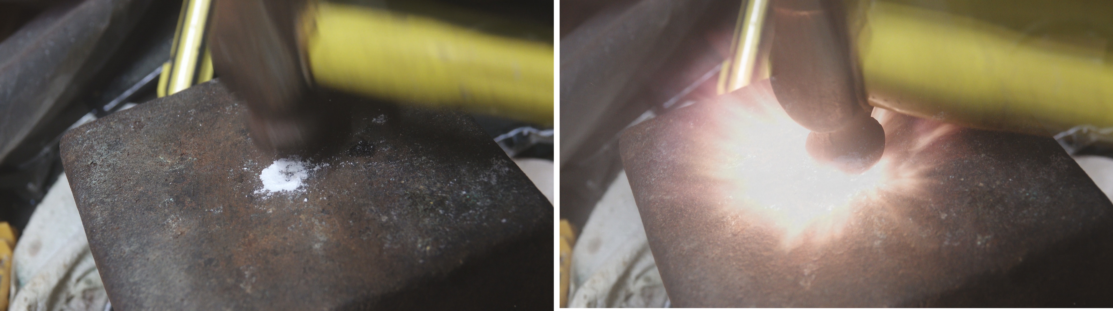

Testing the presumed SMX, it deflagrates much the same as PETN, with no real residue but leaves a tarnished stain on Al foil. It seems about as impact sensitive as PETN, as it should based on the literature. It propagates detonation easier under the blow of a ball peen hammer, what I mean by this is that PETN will snap and spread the loose surrounds about, whereas SMX is more likely to transmit its detonation into it giving a much louder and forceful bang. On the hotplate mentioned earlier, it melts at "75C", starts to bubble and decompose at 145C, vigorous bubbling and red fumes at 165C and ignites at 187C.

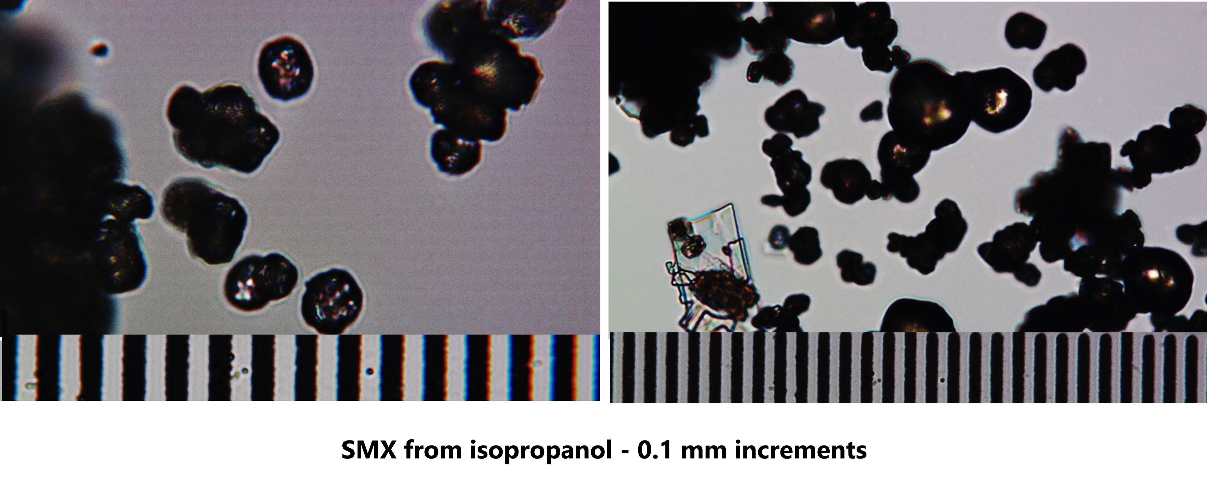

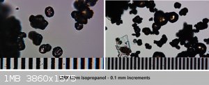

Some pictures. A hammer blow where it propagates into the loose powder for a powerful detonation. The crystals from isopropanol were very small, microscope struggles here but were quite spherical in nature.

Would be very interested to see how it goes in a melting point apparatus where the temperature ramps much more gradually. Maybe there is still a small amount of impurity in there forming a eutectic and lowering the melting point slightly if it isn't the hotplate.
Is it possible that the crystal structure/type forms hotspots more efficiently resulting in enhanced shockwave propagation in the hammer test. That coupled with the higher crystal density would be beneficial.

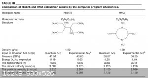

Everyone seems to designate a different name to it, NEST-1 and Hisk75 are a couple more, but SMX seems to have stuck the most. I think its hype died down after its thermal instability became apparent, so like the vast majority of discoveries it's unlikely to ever find use in industry.
I assume you were using the patent route Microtek? Theres a lot of hurdles in route for the amateur. The simple condensation of NIBG with acetone using P2O5 was the biggest key to opening it up. The "dimerization" via NaOH and persulphate confuses me, why is it heated with NaOH for an hour before the addition of persulphate?
If I was to do it again I'd probably use a larger excess of KNO3/H2SO4, I used a 3x excess but it's likely that the protecting fragment is also being subjected to nitration, possibly to nitroform so this should be accounted for.
Yeh Greenlight. It's totally plausible that it's the crystal form and size that allow ease of propagation, but I don't know of any specific study on that. It does seem likely there is one somewhere though. Comparing critical diameter to crystal size/morphology.
