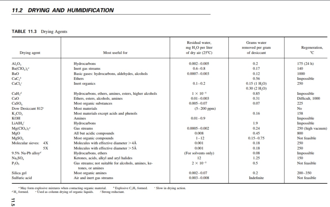

Below is a table of drying agents from Lange's Handbook of Chemistry (15th ed.).
Drying agents.jpg - 126kB

Nice starting point table, but some entries are questionable:
1) KOH recovery is stated as "impossible" when it is very much possible and pretty easy. It's not just s theory, I have done it few times when I run out KOH and needed it quickly. KOH decompose to K2O at less than 500°C and K2CO3 requires just above 900°C. Since KOH quickly converts to carbonate you can assume that some/most of it is carbonate hence the furnace. Just a cheap metal melting furnace available on ebay or amazon is very adequate. then K2O + H2O = 2 KOH. Even stranger is that for CaO recovery is stated as "difficult, 1000°C", so recovery with higher temperature is "difficult" and with lower temperature "impossible" ?
2) Why recovery of MgSO4 is marked as "not feasible"? Just around 200°C (ordinary oven!) and you get monohydrate from heptahydrate. I consider is not only feasible, but dead easy even for novice.
3) Sulfuric recovery as dehydrating agent is stated as "not feasible" and it is also pretty straightforward - just boil it till you get white fumes. Yes, it is more dangerous procedure than heating MgSO4, but for an individual with chemistry experience its rather nothing extraordinary.
Am I missing something ?

These entries stop being questionable when you consider that the authors had students and workers in academic and professional labs as their intended readership.
