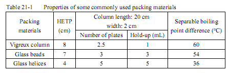

[*] posted on 17-12-2025 at 00:04
Found somewhere :
col.PNG - 14kB
I use 40 cm VC. It is sensitive to air movements but a loose sheet of aluminium foil, around whole column, fixes it.
As written elsewhere, it is possible to perform nice experiment of azeotropic dehydration of acetic acid-water solution using this column, so performane is not so bad.

Posts: 3953
[*] posted on 17-12-2025 at 02:39
@kmno4 : that is an interesting table.
for 3mm glass beads I get 60mm with a 25 mm id column
and the table shows 70mm for a 20 mm id column ...quite similar :)
the Vigreaux data is surprising,
almost as good as a packed column with reflux condenser.
I bought the cheapest NS24 Vigreaux column on eBay at that time,
(it has a side-arm take-off)
not as many fingers as the more expensive variants,
so maybe I am still over-critical of Vigreaux columns .... ?
or maybe I ran the distillation too fast ?
or maybe the authors used a reflux condenser ?
