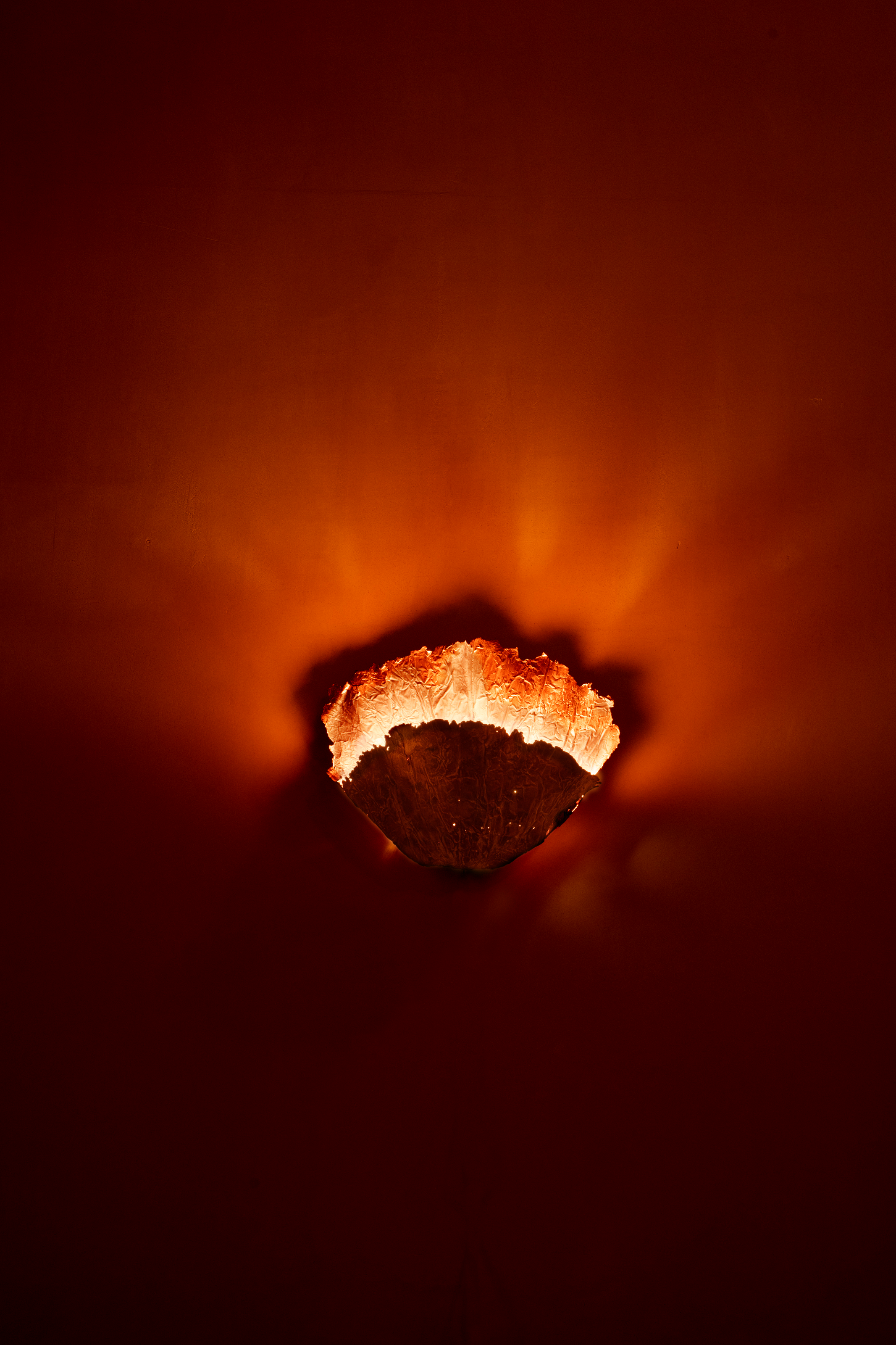

PS if you want to see what Im brewing up see attached.
DSC01277wide sconce- 3200 composite.png - 7.1MB
