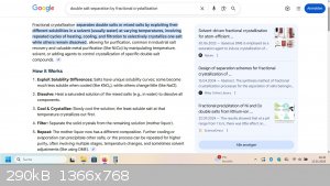

Google AI say it´s possible. I´ve never tried it personally, though. Who knows for sure?
Posting AI slop like this should be an instant ban.
Separating salt hydrates using organic solvents is a dubious idea in general. The water of crystallization will throw everything off; it dissolves in hence contaminates the solvent. Unless you have a published procedure you probably want to find another way.
I would stick with the original plan; you can separate sodium nitrate from the carbonate essentially by concentrating the solution and cooling. Gassing CO2 helps. NaNO3 is much more soluble than sodium carbonate. The sesquicarbonate and bicarbonate are even less soluble.
Posts: 4752
[*] posted on 12-1-2026 at 11:19
“Who knows for sure?”
Ffs. I know for sure that the AI response is full of shit from the briefest of readings, because it doesn’t even talk about double salts, and just gives the most basic overview of recrystallization imaginable, using sodium chloride and potassium nitrate as the example (two salts that do not form a double salt and are trivially easy to separate).
And yeah, I’m absolutely going to propose another amendment to the forum guidelines cracking down on the use of AI as a “source” and uncritically posting screenshots or verbatim statements of AI generated drivel. It’s nothing but a waste of time and energy.
