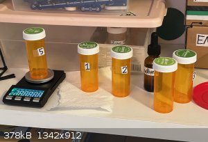

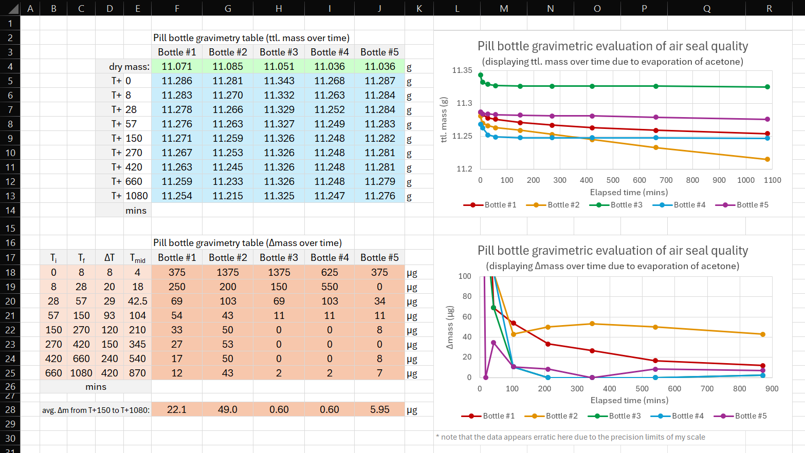

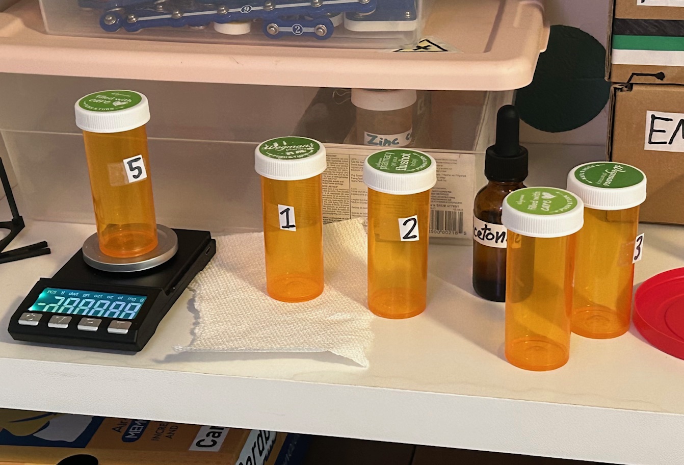

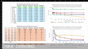

Someone's probably thought of this before, but I found that it's possible to quantitatively evaluate the air seal quality of almost any container using a simple gravimetric method.
By adding a small amount of volatile solvent to a container and tabulating the change in mass over time due to vapor loss, you can easily measure the rate of gas leakage.
In the following example, I evaluated the seal of 5 pill bottles which were more or less identical. A quarter of a milliliter of acetone was added to each bottle, and their change in mass over time was tabulated in the attached spreadsheet.
IMG_0207.jpeg - 378kB container_seal_gravimetry_spreadsheet_img.png - 178kB
(i believe the initial sloping that occurs before the change in mass over time becomes linear at around T+30 minutes is primarily due to a minor buoyancy effect caused by the expansion of the plastic bottles as the internal pressure reaches equilibrium somewhere around 1.3 atmospheres)
From the data you can see that the seal quality of each bottle varies significantly. The mass loss over time between the bottles with the best seal (bottles 3 and 4) and the worst seal (bottle 2) varies by a factor of almost 40!
In theory, the rate of vapor loss should be largely independent of the surface area of the solvent and the volume of the container so long as the seal is good enough to maintain an internal pressure roughly equal to the ambient pressure plus the vapor pressure of the liquid.
If you want you can actually estimate the shelf life for a given mass of solvent. As an example, the average loss rate for bottle #5 (from T+150 mins to T+1080 mins) was measured at 0.000006 grams per minute, which means 10 grams of acetone would take roughly 3.2 years to fully evaporate. Neat.
A moment of silence for all the homebrew chloroform and ether lost from leaky jam jars and wine bottles.
