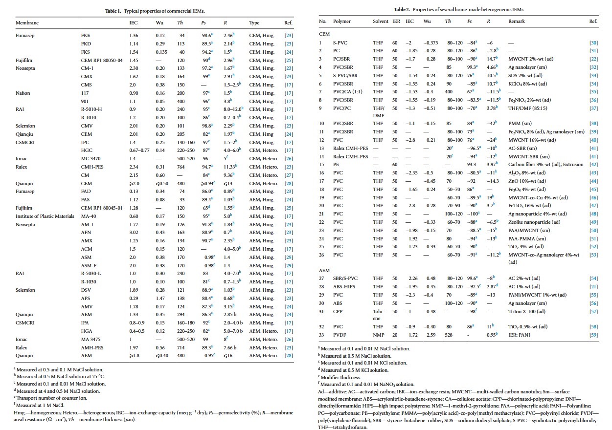

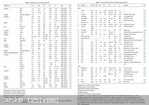

Here are articles dedicated to these membranes. Please note that they are made from polyethylene for a reason. Apparently there is a serious reason
https://pmc.ncbi.nlm.nih.gov/articles/PMC6950762/
Here is a great article reviewing the data
https://iopscience.iop.org/article/10.1088/2053-1591/aa5cd4/...
[Edited on 7-2-2026 by Hexabromobenzene]
