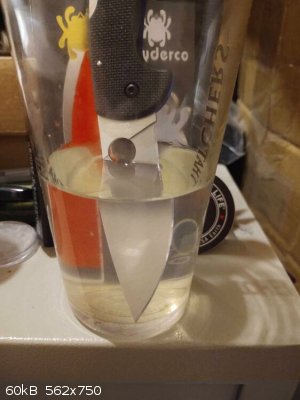

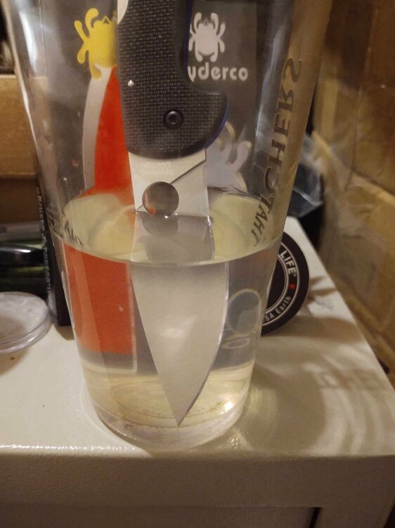

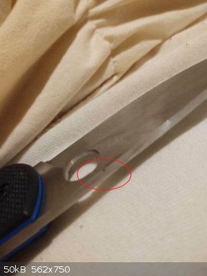

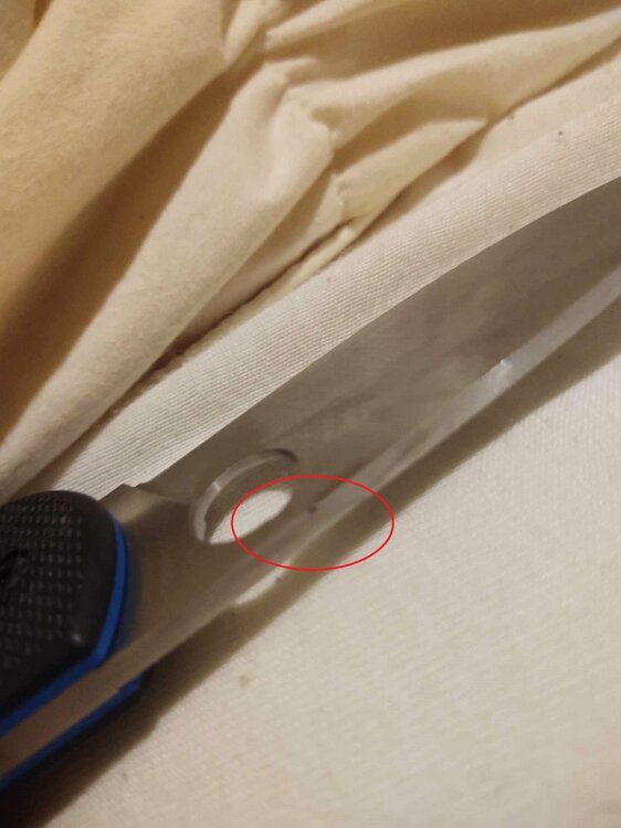

Left blade of Spyderco Siren knife in a cup with concentrated solution of table salt, on 3rd day in it some rust appeared and I noticed a little hole on the blade eaten by salty solution.

Photo in the fist comment is 3rd day in salty water.

This is called pitting.
Basically, a mini galvanic cell is created which accelerates corrosion in a highly localised area. As the pit develops, the corrosion rate increases. (Lovely positive feedback loop.)
Aluminium, chromium and stainless steels are the most susceptible, especially in an environment with chloride ions. Best prevention is a surface treatment such as anodising, or to keep the metal clean, and preferably dry.
It can happen rather quickly. I am curious as to why you left your knife in salt water for so long.

Thank you for your reply, you are not the first person saying that this is pitting type of corrosion. I did it to test the knife, before buying more of the same supplier, salt series too Magnacut, H2, as the knife is advertised to handle salty water and do not rust in it.
