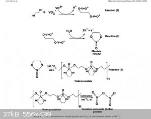

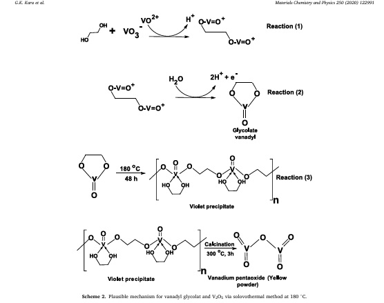

Just something I saw in my readings that I thought could possibly be of use to simply purify your vanadium compounds, via their ethylene glycol
complexes?
https://doi.org/10.1016/j.matchemphys.2020.122991
