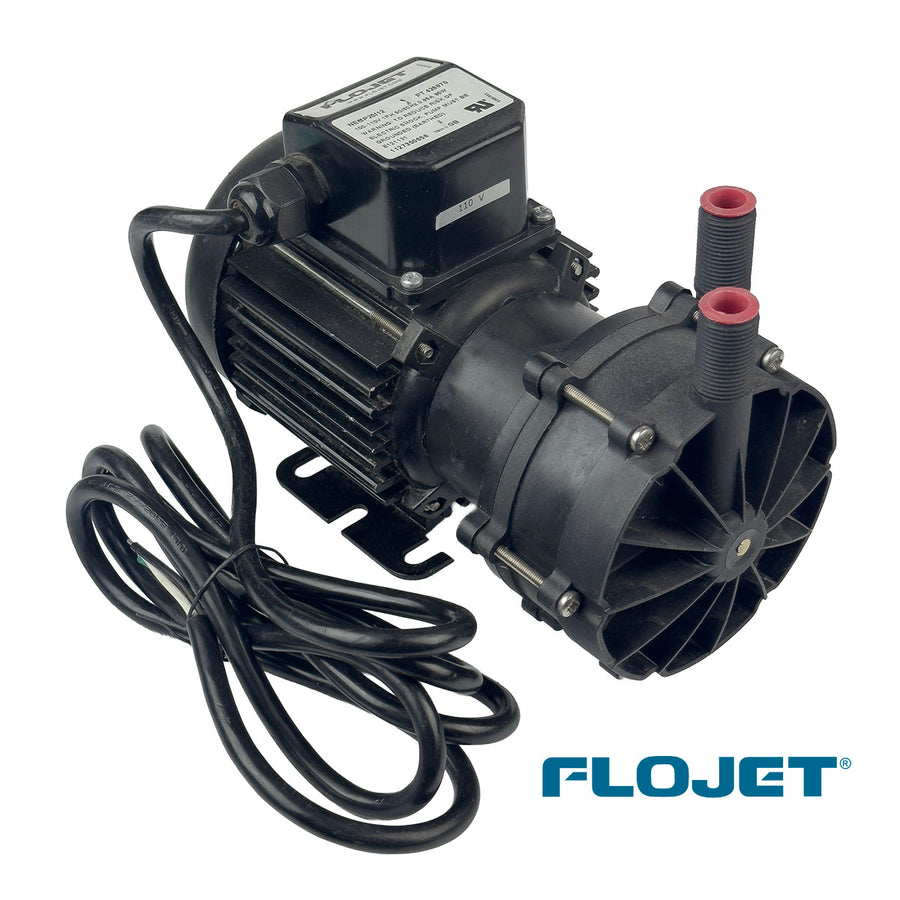

https://theelectronicgoldmine.com/cdn/shop/files/G29486-8_90... This pump is advertised to be made of chemical-resistant thermoplastic, resistant to aggressive chemicals, caustics, acids, chilled fluids, etc. It is magnetically coupled, so it can’t be run dry. I’ve got one I used for transferring sulfuric acid. Worked fine for that. Right now they have it for $99 plus shipping. I haven’t checked the price anywhere else. It’s not on Amazon, but it is also sold by a company called Xylem, where you can find more information.
