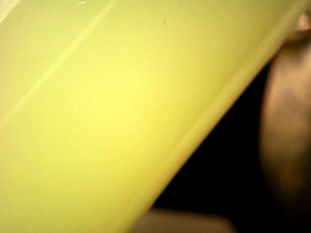

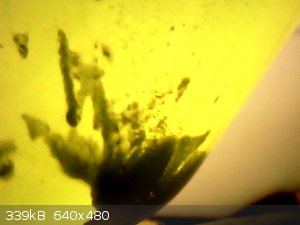

I mixed posassium ferrocyanide with water to make a yellow solution. Then I added very weak (1/2 %) hydrogen peroxide. Because --- Nothing appeared
to happen. I then I added sodium nitrite ( about the same amount of crystals, 1 [cc] or so as the ferrocyanide).
Very slowly bubbles began forming, and the solution changed from a pure yellow to a yellow-green color over a period of an hour.
I suspect the reaction worked, although the color isn't red yet.
I hope If I allow this greenish solution to evaporate over a period of days, the color will redden and eventually begin to crystallize.
Am I anywhere close to correct ??

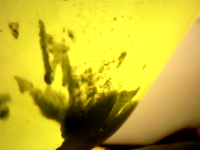

I've let my first attempt sit out for a couple of days but it's not evaporating very fast out of a test tube.
So, I decided to heat it gently and set a filter8 pump blowing a gentle stream of filtered air into the test tube. The water is evaporating
reasonably fast off my sodium nitrite, H₂O₂, and (previously) ferrous mixture.
It's looking quite green now.
I wonder how close to evaporated it will need to be before there is a color change.
Since whether the stuff oxidizes or reduces depends on the alkalinity of the solution; maybe ammonium nitrate, or ammonium chloride, would be
effective in acidifying it to convert it to ferric state with H₂O₂ -- eg: if the nitrite doesn't work.

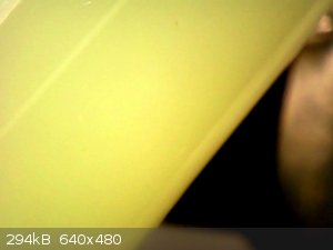

Sigh. Failure.
As the water evaporated the color changed back to yellow, and a more intense yellow than the original Prussian (ferrocyanide) yellow.
I'm thinking that the reason it probably failed is because there are more potassium ions required for the ferrous state, than for the ferric state.
But, I didn't remove any potassium and the excess sodium nitrite that I added can't remove any either. Thus, the excess alkalai metal probably kept
the pH basic.
I'm repeating the experiment with ammonium chloride. The ammonia can be boiled out, which hopefully allows small amounts of potassium ions to be
removed by chloride ions. Then perhaps the hydrogen peroxide can oxidize the ferrous salt to ferric.
Again, there's no obvious color change when I mix peroxide with ferrocyanide. Not even after adding a small amount of ammonium chloride.

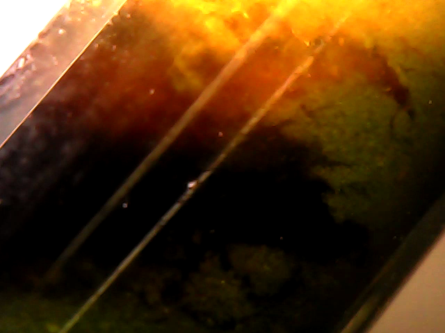

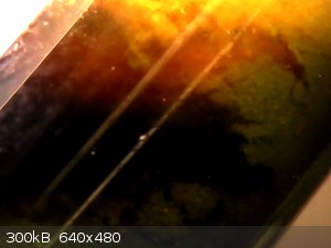

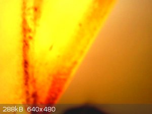

I'm not sure what I'm doing wrong.
Next attempt, incrementally attempting to change using ammonium chloride.

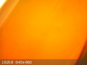

I mixed yellow prussate crystals with a small amount <10% by volume Ammonium chloride. Then added hydrogen peroxide to dissove it (~<3%).
The result is much the same as before, I get a brighter yellow-green color.
Therefore, I continued to add Ammonium Chloride and dissolve it until I had added around 25% crystals by volume compared to ferrocyanide. It became
brighter yellow, and then the green became much more saturated but otherwise ... still green. It's not turning red, or reddish orange.
So, I dried it overnight with a gentle air breeze in the test-tube. It mostly dries super bright yellow (more yellow than the original salt) with a
small part on top being yellowish orange. But, all references I see say the solid ought to be "ruby red" -- and it is not.
Mixing it with weak peroxide, again, I added more ammonium chloride. The green starts to go dark, and the more ammonium chloride I add, the darker
the green color is. The solution itself looks almost black, which could be red -- but if it is, then why isn't it drying red rather than turning
orange as it evaporates ?
If I had stripped of the potassium, completely, I would be left with prussian blue and that's not what I have. I would need at least dark green for
it to be a mix of prussian blue with ferrocyanide.
I estimate close to 50% by volume is ferrocyanide vs. ammonium chloride, now.

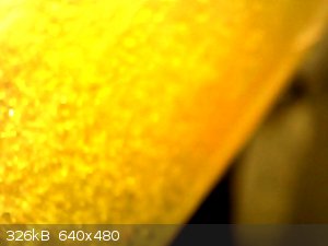

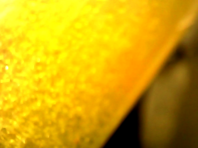

Drying the solution under air causes whitish-yellow crystals to separate out first and fall to the bottom of the test tube, with orange crystals
forming on the test tube walls above the salt. Orange is not ruby red.
The more ammonium chloride I add, the more orange salt appears -- but the yellow stuff is still there. Heating it makes the crystals falling to the
bottom of the test tube become a dark green. I assume that's the onset of prussian blue....
The light orange makes me suspect that I have half yellow, half red, iron cyanides mixed ?
Apparently, it's difficult to drive the reaction to a pure ferric state ?
Online searches don't give me any clues, either.
Anybody have an idea of what I'm doing wrong?
(Besides not buying the ferric already, which I am ordering...)
This is supposed to be an *easy* reaction to do.
[Edited on 27-3-2026 by semiconductive]

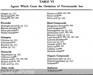

PLEASE BE CAREFULL - on using acids on ferrocyanide - READ before proceding.

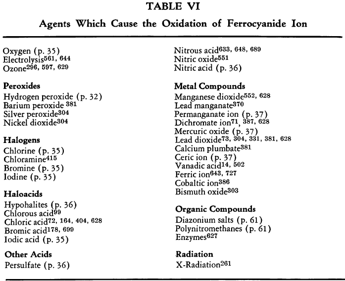

here is a table from bellow:
https://www.911metallurgist.com/blog/ferrocyanides/

The 911 metals site notes:
| Quote: | Nitrite. The nitrite ion causes the formation of a bright yellow coloration in ferrocyanide solutions in the presence of acetic acid. This is due to
the formation of the ferricyanide ion and nitric oxide.
ferrocyanide-nitrite
Nitroprusside, [Fe(CN)5NO]-2, is formed from ferrocyanide and acidic nitrite or nitrate solutions on boiling. In the cold, the reaction goes slowly
and incompletely owing to the formation of by-products such as ferric oxide, ferrous ferrocyanides, and the nitritoprusside ion.
How strange!
Bright yellow, then, is sometimes ferricyanide and not mixed ferro-ferri cyanides?!
I may have already succeeded if H₂O₂ has the same effect as acetic acid with sodium nitrite.
There's no guideline as to how concentrated the acetic acid is, either, ... but I might try replicating it by slow addition (dropwise) of a weak
solution first, then glacial later (outside with ice).
911met.. also mention no precipitation when mixed with caffiene. But, they don't say if that's because there's no reaction -- or if it forms a salt.
A lot of online references say that Chlorine conversion is not very high yield, but the halogens mentioned by 911metallurigist say "quantitative" even
if slow. eg: A small amount of Iodine will produce ferricyanide + a small amount of prussian blue precipitate. ( But: I'm temporarily out of iodine
crystals. Used them to very effectively kill off a toe nail fungus with tea tree oil / eucalyptis .... )
There seems to be quite a bit of contradiction about what color means what.....
