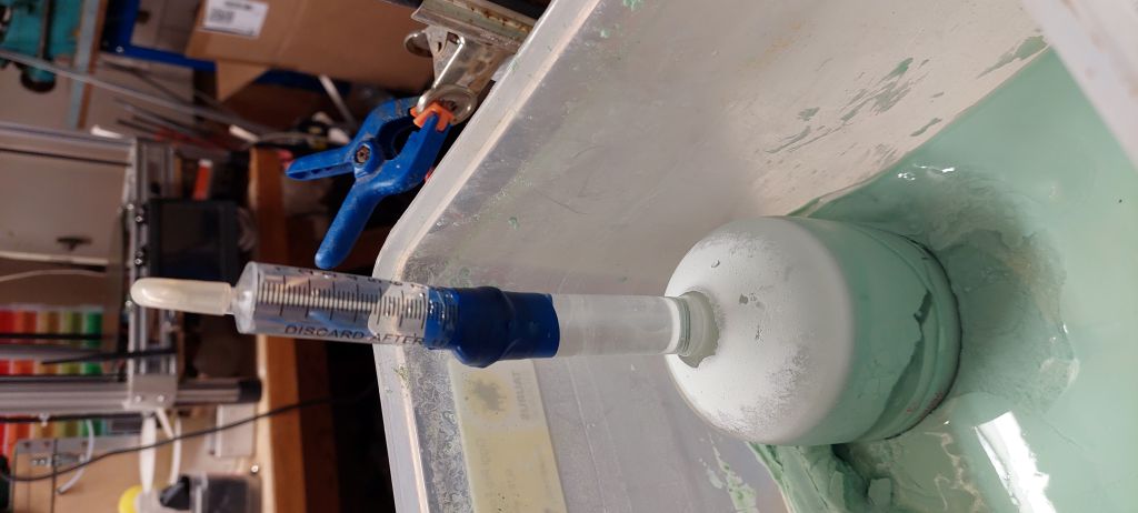

I recently found myself needing to filter about 6 liters of liquid, having just done some nickel plating and wanting to store the nickel dry as the
basic carbonate.
I quickly realized that slowly feeding it through a coffee filter, 1 cup at a a time, was going to be a long and tedious exercise.
So I came up with this:
1: attach some 4mm ID silicone tubing to the stem of a glass frit filter funnel ( I made an adapter using a 10ml plastic syringe and some vinyl tape
to seal it)
2: invert the funnel in the bulk liquid container
3: create a siphon to a receiving container
Its slow, but it means I don't have to babysit the thing for hours. I left it to do its thing overnight, and in the morning I had a tub with a thick
layer of damp nickel carbonate - ready for a rinse and repeat.

Can you take a photo?
I am having some difficulty in visualising how the filtering works.

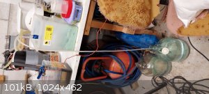

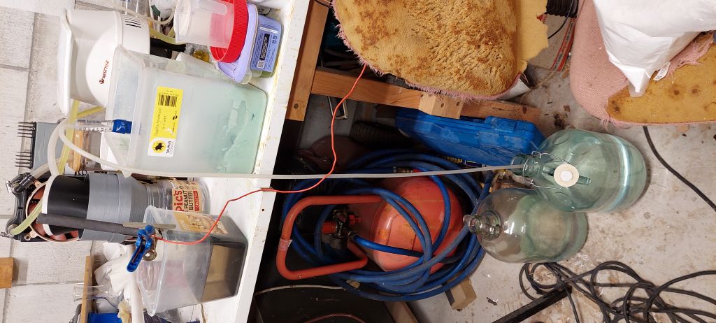

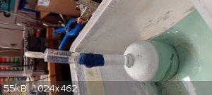

Here's a couple of photos of the setup, one showing the siphon, the other showing the inverted filter funnel in the upper tank.
I also have a small peristaltic pump I could have used instead of the siphon, but I'm not in a rush with this one.
