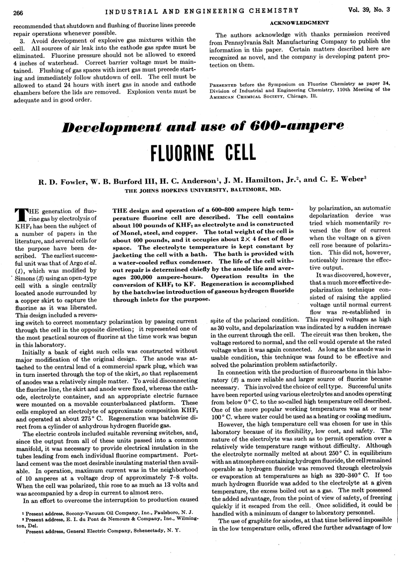

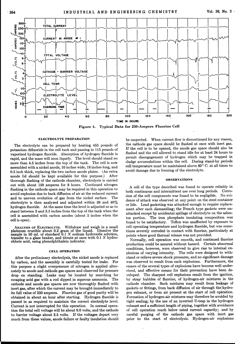

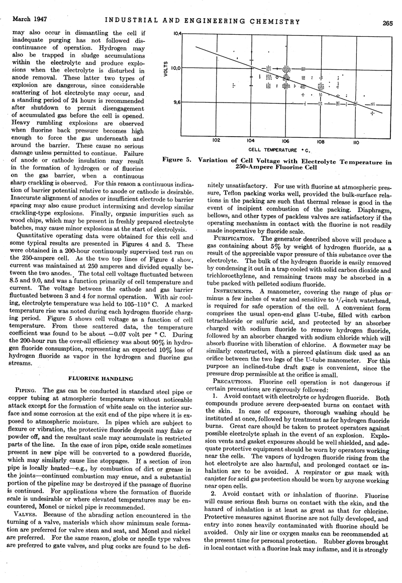

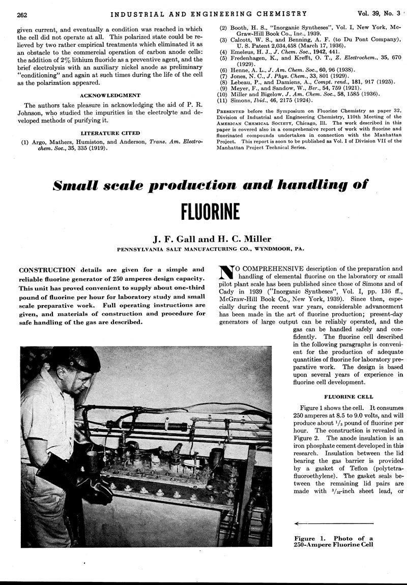

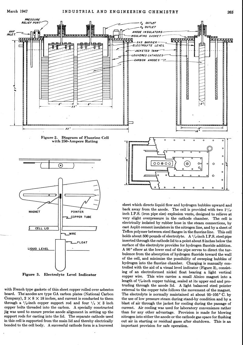

A small scale fluorine generator
A weekend project.
Presumable one could scale it down.
Up.
Murray, Osborne and Kircher
Carbon-Anode Fluorine Cell [2000 Amperes]
p. 249-254
Fluorine-small-scale-production-1.jpg - 486kB Fluorine-small-scale-production-2.jpg - 417kB Fluorine-small-scale-production-3.jpg - 555kB Fluorine-small-scale-production-4.jpg - 624kB Fluorine-small-scale-production-5.jpg - 568kB

The cell described can be assumed to be entirely resistive devoid of reactive elements
so power factor is equal to one. 250 amperes at a nominal 9 volts is 250 x 9 = 2250 VA
or 2250 watts ( 2.25 kilowatt / hr ) , just a third more than the output of a hairdryer
( 4/3 x 1650 watt ).
If storage can be managed , 1/3 pound per hour production for experimental use may
seem excessive. As Wizard has mentioned this setup can certainly be reduced.
Sourcing an appropriate tranformer for a 1/5 power supply on Ebay _
http://cgi.ebay.com/115V-13-5V-60-Amp-High-Current-Power-Tra...
Reduction by a factor of 25 will yield 2/3 pound (~ 316 gm ) in a 24 hour period.
The resulting current demand of 10 amps is well within the capability of any
common DC 12 volt computer power supply.
