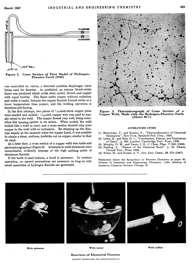

Be the first kid on the block with a hydrogen-fluorine torch
From Industrial and Engineering Chemistry.
Hydrogn-fluorine-torch-1.jpg - 562kB Hydrogn-fluorine-torch-2.jpg - 503kB Hydrogn-fluorine-torch-3.jpg - 407kB

Forsooth! La article on the HF torch sez they welded copper to
copper with it. I have use my Oxy-acetylene brazing torch to
weld US nickel (5-cent) coins together. Unkl Tungsten told his nephews
that Superman did it with his X-ray vision.
Brazing is welding, and if'n your using iron rods you are melting
the work along with the rod.
