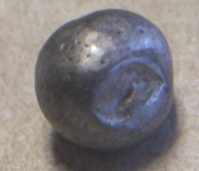

[*] posted on 22-2-2012 at 04:22
This sphere is about 1 centimeter in diameter. It is quite dark gray and not very shiny.

[*] posted on 22-2-2012 at 06:18
looks just like mine! with the little crater and everything! guess we had the same suppier

[*] posted on 22-2-2012 at 06:29
Beryllium nodules often do have strange shapes.
