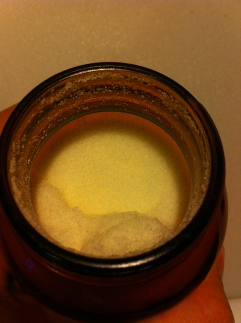

[*] posted on 23-3-2012 at 19:13
I have a nearly 30 year old bottle of NaNO2 with a plastic screwcap and this NaNO2 still is good. I did not measure its purity, but if I add some to lukewarm dilute sulphuric acid, then it strongly fizzles and a lot of brown gas is produced, so I expect that at least the major part of this solid still is NaNO2.
NaNO2 (and also anhydrous Na2SO3) are easier to store than many people think. Just keep them dry in well sealed bottles. As long as they remain dry, the deterioration will be negligable.
This is my situation as well, my bottle of sodium nitrite seems quite old (although not exactly sure of the age...I'm guessing 20 years perhaps...who knows!) and has what I think is a bakelite cap. It says to store in tightly closed containers, which I do, and it performs as it should, just keep it well sealed and I dont think you will have any problems
photo 2.JPG - 69kB
photo 1.JPG - 76kB
[Edited on 24-3-2012 by Mailinmypocket]
