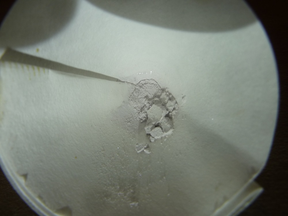

The total weight of the (almost) dry product is about 1,28 gram, that´s pretty close to the theoretical maximum 1,33 gram.
See attached pictures, 760 milligram with one eurocent-coin (16,25 mm diameter, for a rough estimation of bulk density) and 520 milligram without.
I guess the bulk density is not as good as expected (patent claimed about 1,5 gram per milliliter), but I do not want to measure it out.
The flowability is moderate, maybe it´s not completely dry.
The bulk density depends on the form of the crystals. If it is low, you probably violated something in technology. Look at your product in a microscope.

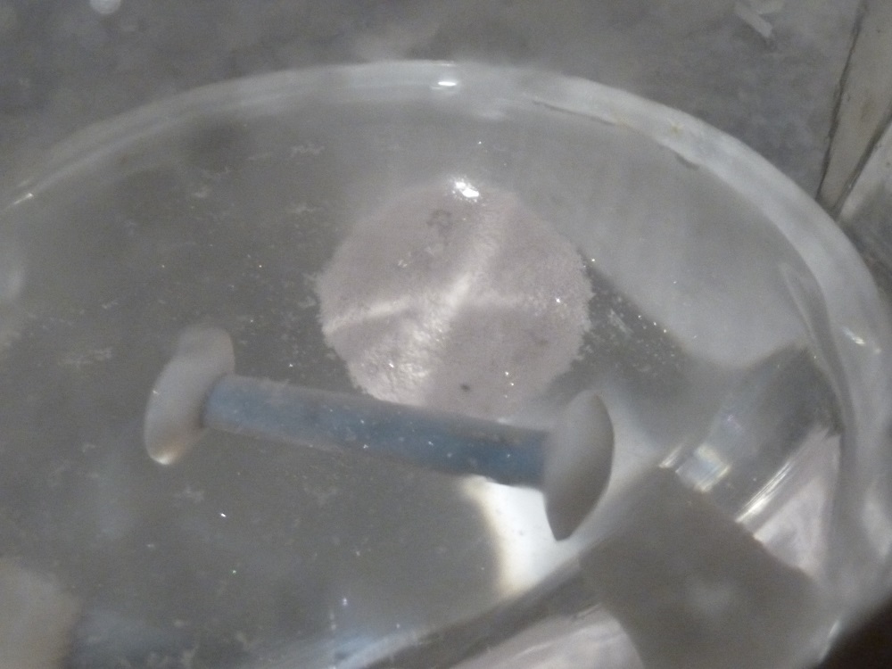

Second batch seems better
Thank you for fast reply. I´ve performed a second batch with same quantity of reagents, but - as suggested - more diluted with distilled water.
I´ve also reduced the reaction temperature from 75 degree centigrade to 55 - 60 degree and a prolonged reaction time (6 hours followed by a very slow cool-down over night).
My first impression is positive, a fine granular glistening precipitate, very light grey, almost off-white.
Hopefully the ignitability is better. See the attached pictures from the reaction mixture, the unwashed precipitate in the rbf, the still wet clumpy second batch and for comparison together with the first batch (looks like atomized aluminum).
The reagents I´ve used are from commercial lab supply and should therefore be of sufficient purity. The silver nitrate was from caelo, a pharmacy supplier in Germany.
Next week I´ll make further tests and report.

The trick is to use lower reaction temperature, prolonged reaction time and more diluted reagents.
The yield is also better, about 1310 mg from 1510 mg silver nitrate (approx. 98 % of theory).
The ignitability is much better, first attempt ignition delay 0,5 - 0,6 s, second attempt about 0,3 s (slow-motion 8 x). I think that´s okay, silver azide explodes beyond 300 degree centigrade.
The second explosion was powerful enough to break a small red plastic piece out of the knife handle.
