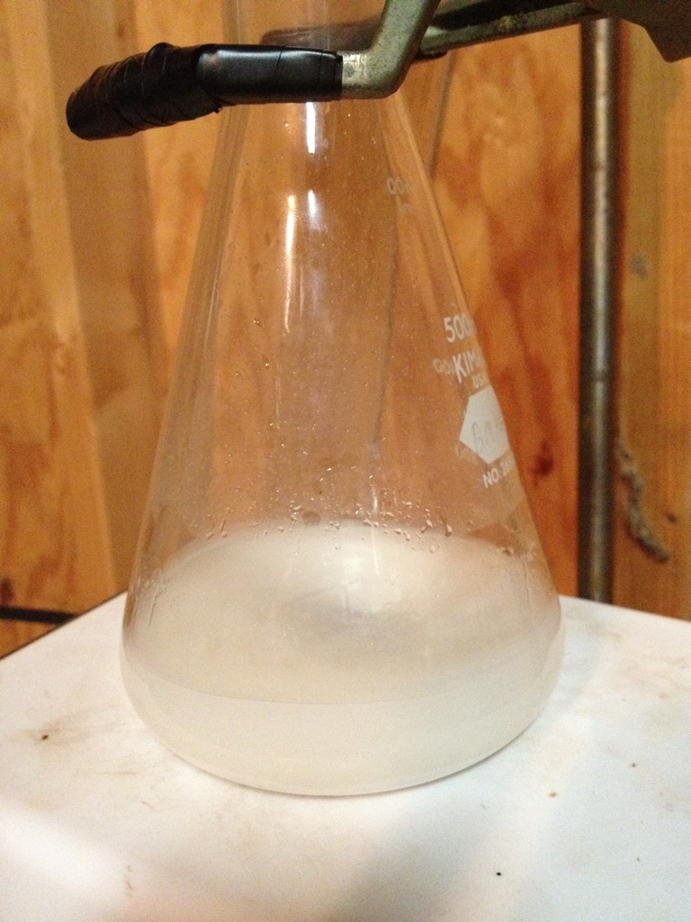

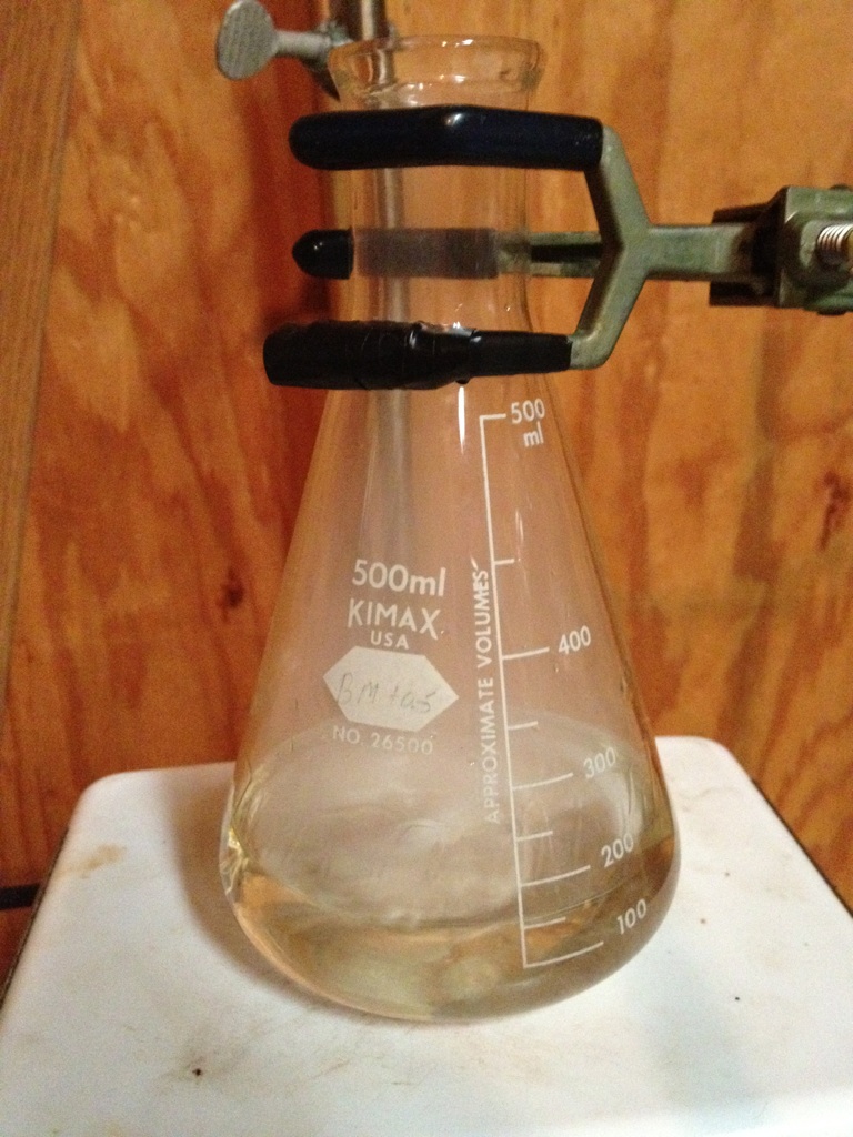

Feel free to merge this thread, I'm not sure if this has been posted before. Here is a run through on the synthesis of Mercury (ii) Chloride I've done recently.
Ill start with the HgSO4 formation:
Hg + 2 H2SO4 → Hg(SO4) + SO2 + 2 H2O
A conical flask (Erlenmeyer) equipped with a magnetic stirbar was charged with 39.56 g of Hg and ~120 mL of H2SO4 ( I used a beaker you all know how accurate these things are). Gradually heat was applied and magnetic stirring was started. Initially the solution appeared clear with beads of Hg at the bottom of the flask. A thermometer was not used in the initial reaction, once white vapors appeared the heat was turned down to minimize acid loss. The entire reaction was stirred for 18 hours to ensure all Hg had converted to HgSO4.
Here are some pictures of the process (ill post the 2nd half here soon...)
IMG_8863.jpg - 234kB IMG_4388.jpg - 241kB
polymerizer87
Posts: 35
Registered: 16-7-2012
[*] posted on 26-7-2012 at 06:39
Picture 1: In process HgSO4 formation (t=3 hours)
Picture 2: In process HgSO4 formation (t=30 minutes)

I used conc. H2SO4 (Fischer), Elemental Hg (Sigma Aldrich)
at ~14 hours into the reaction I looked under the flask and saw a rather large bead of Hg, So I turned up the heat and hit it pretty hard for about an hour. After turning the heat down I let it sit for another 2 hours and came back with no residual Hg left in the flask!
The excess H2SO4/H2O was decanted off the HgSO4, and a previously prepared 1 L dH2O HOT was poured into the Erlenmeyer flask until the HgSO4 turned bright yellow/orange (I agree with the commentary on Erowid that the addition of hot dH2O may be decomposing the HgSO4, I'm considering taking this out) The HgSO4/dH2O/residual H2SO4 solution was then filtered through a buchner funnel with a 2.5 micron filter. The bright yellow/orange filter cake was then transferred back to the flask and washed with a previously prepared 1 L saturated NaHCO3 (~80 g/1 L) solution. The yellow/orange precipitate turned dark maroon/brown after the addition (like Zygot mentioned). The NaHCO3 solution was then decanted off and another portion of the NaHCO3 solution was charged, and decanted again following with 3 x 100 mL dH2O washings using the same methods. At this point what is left in the flask is a fine dark brown/maroon powder at the bottom. A magnetic stirbar and ~50 mL of dH20 is charged into the flask. Drops of HCl via pipette is added to the suspension until brown/maroon precipitate turns yellow --> white "curds" and the addition was seized. Heat was then applied to the solution until all H20 is evaporated. Filter--> wash---> recrystallize using boiling dH2O.
I'm currently going through another run with 80 g Hg, I'm modifying the procedure some and will be able to post some better pictures. I tried to follow the procedure on Erowid.com for the preparation of Mercury Salts, but found that it was much easier to use a decanting method during the Hot dH20 and sodium bicarbonate addition. It would have been extremely messy to pour the HgSO4 into boiling hot water, filter, then add saturated Sodium bicarbonate and doing subsequent filtering and water washes. Since NaHCO3 is water soluble and HgSO4 or HgCl2 are not (at room temp) several washings with dH2O will get all the residual NaHCO3 out. I was not worried about yield loss as I have 1 kg of elemental mercury.
