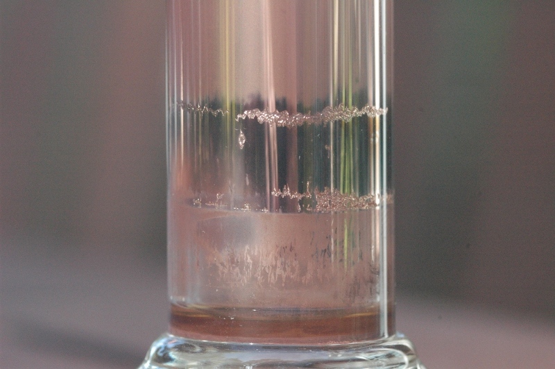

Please understand this was not a well controlled experiment but, rather, grew out of a demo for my daughter. Hence the quantities where not measured.
I had read on this forum about the use of Ascorbic acid to reduce Copper II to elemental Copper in a fine powdered form. Further investigation yielded several papers on various techniques of generating Copper nanoparticles and/or colloidal suspensions. That set me off down the path to try do the classic Copper mirror experiment using Ascorbic acid as a more benign (and easily available) reducing agent.
I began with ~30 ml of saturated Copper Sulfate solution. To this I added enough 10% Ammonium Hydroxide to just dissolve the precipitate formed. Then ~ 1 gram of Ascorbic acid was added (the exact quantity I am unsure of). This did not completely dissolve and yielded some evolution of gas. I suspect that not all the hydroxide precipitate had dissolved and as such reacted with the Ascorbic acid. This formed a milky colored layer just above the undissolved Ascorbic acid due to turbulent mixing I assume. Within a few minutes the blue Copper II color completely disappeared and the solution was water clear (except the bottom "milky" layer). At this point the cylinder was immersed in boiling water. Almost immediately the solution begins to turn brown and darken. This is I believe colloidal Copper. The Ammonium complex is apparently important for limiting the particle size, at least that what the literature suggests. Withing a few more minutes the mirror layer began to form just above the milky bottom layer. Within 10 minutes all was done with the solution remaining a dark brown. The mirror turned out be quite tenacious and could not be wiped off but required an HCl/H2O2 etch to remove it. This was surprising given that I didn’t do anything special to clean the glassware prior to the experiment.
I have been only partially successful in repeating this experiment. Currently I am awaiting the delivery of more Ascorbic acid before I can continue. It seems that the interface between the saturated Ascorbic acid layer and the solution just above it holds the key.
That's it - lots of words but not much useful information :)

arclight, your experience with copper reminds me of the silver layer produced by the Brashear process, which uses glucose as the reducing agent on an ammonia complex of silver hydroxide. The Brashear silver layer is very tough, an advantage for telescope mirrors where it must be polished periodically to remove the tarnish. I have found that the Brashear layer of silver cannot be removed with a razor blade, instead I have had to use nitric acid.
The process is also very fussy, and won't work unless conditions are just right (very clean glass, very pure reagents). Maybe it's related to your difficulty in reproducing your results.
Have you done anything more recently with copper mirrors? I might be interested to try reproducing what you have done.
