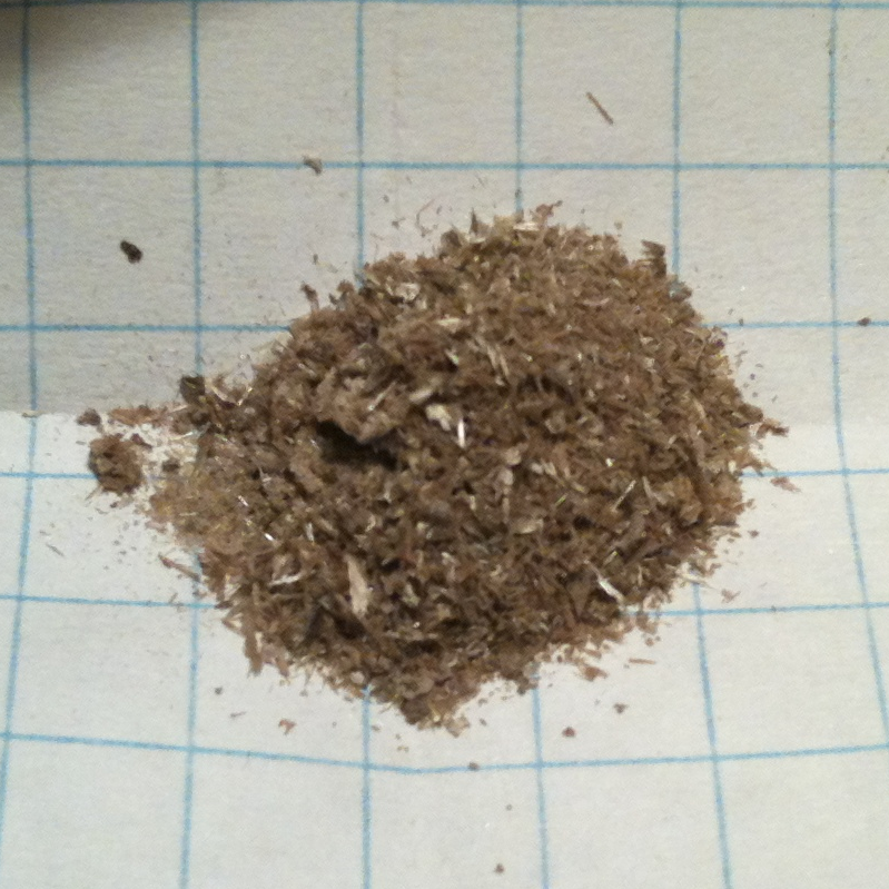

Four 100mg 5-HTP capsules were opened and the brown/tan contents placed in to a 50ml erlenmeyer flask. ≈25ml of (≈95%) ethanol is poured in to the flask. The slurry in the flask is gently heated just below boiling. A stir bar is placed in the flask and the flask stoppered, the suspension is stirred for a few minutes. After stirring the flask is placed in the fridge and allowed to cool a little below room temp (≈15C). The suspension settled out forming a grey/tan layer of insolubles on the bottom and a brown solution on top. The flask is swirled to bring solids back in to suspension and the liquid is vacuum filtered, yielding a clear brown ethanol soln, and a grey/tan solid in the filter paper. The solid in the filter paper is saved and the ethanol soln is allowed to evaporate at room temp eventually yielding a small pile of brown crystals. The product obtained is suspected to be rather impure... :P (Note: the pic below is not my product from this extraction, pic will be posted later.)
Where do I go from here? I am having difficulty finding solubility data on 5-HTP so I don't know what solvent would be best for attempting a recrystallization on the 5-HTP.
As for decarboxylation this is where I originally found the procedures for tryptophan -----> tryptamine (http://www.erowid.org/archive/rhodium/chemistry/tryptophan.h...) I plan on using either the carvone catalyzed or the ketone catalyzed decarboxylation. Can anyone offer advice as to how I should go about this? If I attempt to use the tryptophan decarboxylation procedure for 5-HTP will I have to change anything besides the stoichiometry? Can anyone offer info on 5-HTP solubility in different solvents? Is there any additional information you'd like me to provide? Thanks to anyone that can provide help, as you will be rewarded with pretty pictures of serotonin if everything works out. ;)
PS: The bottom attachment is the remains after attempting to evaporate some 5-HTP soln to dryness (not a good idea, no crystals and some probably decomposed).
