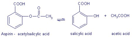

I was under the impression that the Aspirin had to be hydrolysed to Salicylic Acid before nitrating it
Hennig Brand
Posts: 1284
Registered: 7-6-2009
[*] posted on 9-11-2014 at 09:13
If aspirin is used instead of salicylic acid hydrolysis occurs in the hot sulfuric acid sulphonation stage of the process. The products of aspirin hydrolysis are salicylic acid and acetic acid. The salicylic acid is then sulphonated to almost exclusively 5-sulphosalicylic acid from what I understand.
Hydrolysis of Aspirin.jpg - 10kB Product of Direct Sulphonation of Salicylic acid.jpg - 41kB
During nitration the sulphonic acid group is easily substituted by a nitro group and finally the dinitro-salicylic acid is decarboxylated and the final nitro group is added producing picric acid. The decarboxylation is witnessed as the foaming that occurs especially during the last third of the nitrate salt addition.
