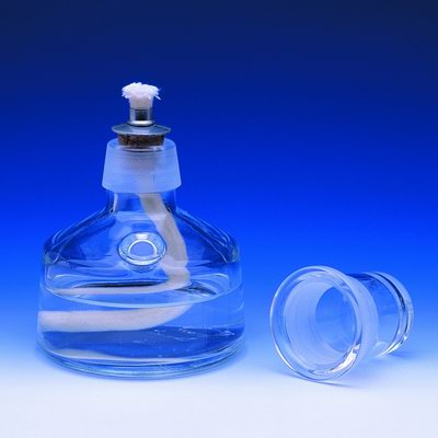

Here's a relatively old thing I did for YouTube.
<iframe sandbox width="420" height="315" src="http://www.youtube.com/embed/OUHOjpbkAPY" frameborder="0" allowfullscreen></iframe>
It's one of those things that suffer greatly depending on the geometry of the reactants in the vessel, and the temperature distribution. The consequences can be disastrous, and were throughout the history of chemical plants.
I recommend only analytical purity ammonium nitrate in small batches, 5 g, more or less. Never let full decomposition take place in a test tube or similar vessel.
Eye protection is a must, and if you have a face shield, use it.
I did it with a recrystalized compound from a fertilizer, so it contained earth alkali nitrates which precipitate and can form a hotspot, so I was extremely careful. Such mixtures should never be heated even near full decomposition because a hotspot-initiated detonation is likely to occur. Don't even try, it's not funny at all. If you must use impure AN for making nitrous oxide, watch for the precipitate. As soon things start to go milky, stop.
And for the love of god, never use these as a heating device.
It has become increasingly common to see people on YouTube using these torches for heating glassware. It's EXTREMELY STUPID and can cause a disaster.
What happened with simple alcohol burners?
It's the "I want it NOW NOW NOW" attitude of kids today, that's what it is. I hate painfully slow experiments that require constant tending, too, but some things are not meant to be rushed that much.
You can use a micro lamp as a heat source.
It has a collar like a Bunsen burner that allows you to throttle it back to produce softer flames.
I did a lot of chemistry with gas burners before electric heater, stirrers became generally available.
I still use one for general heating.
