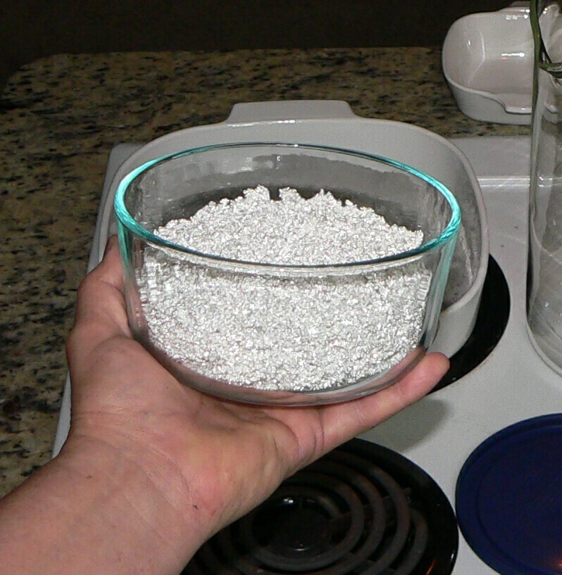

[*] posted on 6-3-2013 at 11:54
Here is the final product from the stainless silver cell.
There is 73.4 troy ounces of pure silver crystal in that bowl.
Took exactly two weeks to produce this amount with my tiny silver cell.
It assayed at 99.9% pure elemental silver metal.
I had the cell back in operation in just minutes after harvesting these crystals.
kadriver
P1240378.jpg - 155kB
