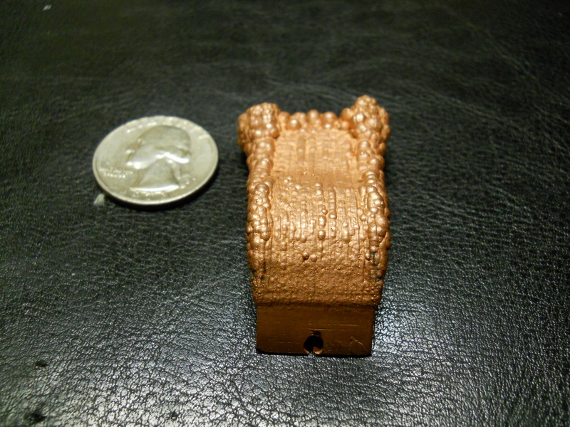

Yes you can. its called Electroforming
http://en.wikipedia.org/wiki/Electroforming
I did see on another site a guy who made little copper cones this way.
I wasn't trying to form a shape but i did deposit 41 grams of copper onto another piece of copper.
The piece is solid and not fragile at all
Project pics 015.jpg - 370kB
elementcollector1
Posts: 2689
Registered: 28-12-2011
Location: The Known Universe
Mood: Molten
[*] posted on 5-4-2013 at 19:04
What was the original shape?
Elements Collected:52/87
Latest Acquired: Cl
Next in Line: Nd
Godspeed429
Posts: 11
Registered: 24-3-2013
Mood: +2
[*] posted on 5-4-2013 at 19:27
A semi-curved rectangle, roughly 2''x.500''x.062 ''
The Cauliflower looking bulbs are the corners.
its a piece of tubing cut in half a straightened
