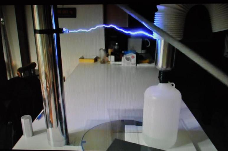

I know this is primitive, but just a little salt water in an LDPE bottle held this nice little spark I made simply by rubbing a paper towel over a
piece of PVC tubing. Salt water makes a decent capacitor. Under it is a piece of 1/8 inch thick PTFE. On top of the poly bottle is a stainless steel
water bottle for the electrode. Probably not the design you are going for but I was really impressed by the simplicity.
