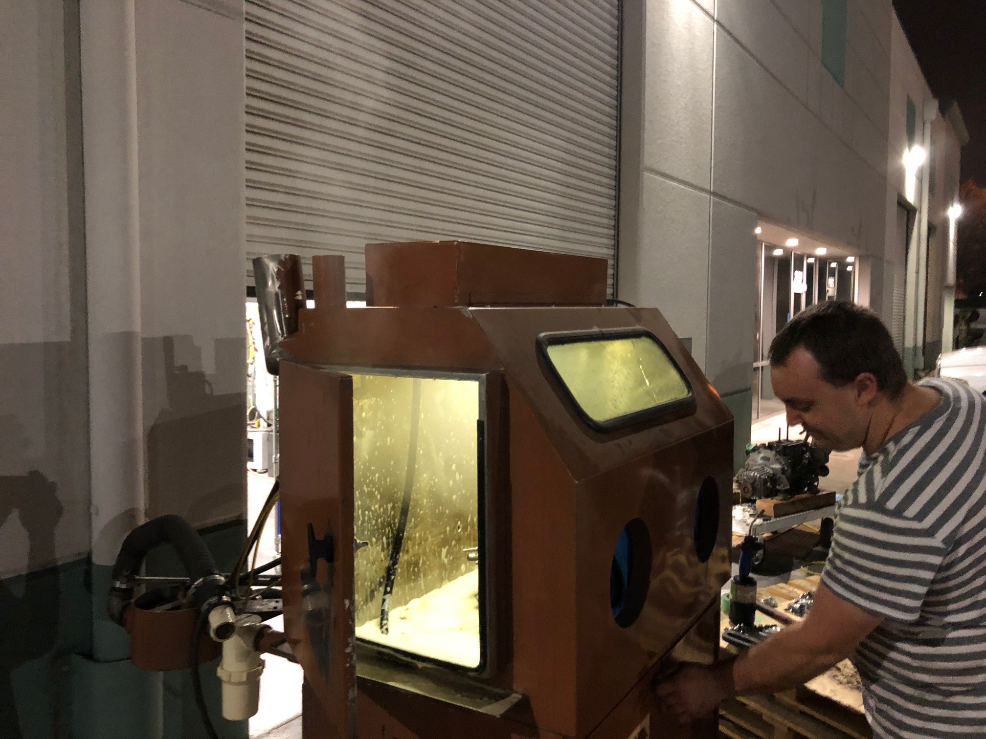

[*] posted on 4-10-2020 at 16:39
I've been having too much fun cleaning some rusty metal parts lately, thought I'd share my favorites.
Ultrasonic tank with hot (85 deg C) Alconox solution is one of them.... Works great on glass, works good on rusty and oily metal parts.
IMG_0788.jpg - 620kB
Added bonus, I've recently noticed that it removes rust, down to bare metal. Not sure if it's chemical or mechanical (from the ultrasonic) action. Here are some parts that, 30 mins ago, were completely covered in rust.
IMG_0790.jpg - 1007kB
Downsides are it makes a lot of steam, I run it in the bathroom. The hot and slippery parts are hard to handle (specially if glass). And have to keep stuff from touching other parts or the sides of the tank. I'm still trying to figure out a nice basket that's soft, and keeps parts separate. But hot Alconox solution in ultrasonic tank, great for cleaning glass.
Now for extreme cleaning. This is a stainless steel glovebox what we charge with sodium- or potassium- hydroxide solution, and heat to like 90 deg C. The solution goes though a filter and a 1000PSI pump, like a pressure washer
IMG_0753.jpg - 694kB
IMG_0756.jpg - 753kB
Cleaning parts from a sailboat diesel engine that's crusty inside with salt water deposits. It's a truly evil machine to use, the amount of steam that comes out is ridiculous. I'm running it outside until I figure out ventilation. The hot solution under high pressure is hard on gloves (and on hands under the gloves). Finding gloves that don't disintegrate is hard, plus I'd like to find something that insulates from the heat.
I would never dream of cleaning glass in the pressure blasting cabinet, things are slippery and the jet of solution will pop things out of your hand and send it flying. But good for rebuilding machinery, engines, turbines, etc.
EDIT: one more thing. I'd be very hesitant to use Scotch-Brite (the green or brown scouring pads) on glass. These have an abrasive that's pretty effective at scratching glass, making grime stick to the scratches next time, and weakens it.
[Edited on 10-5-2020 by 1KEE]
