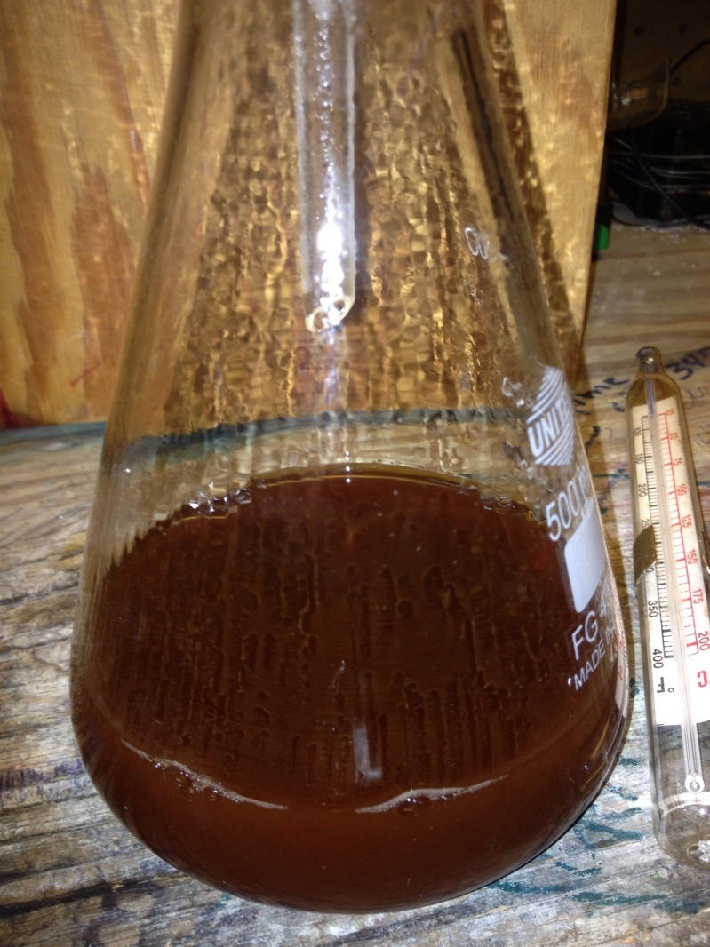

Copper acetate problem. Muddy brown solution
I was synthesizing copper acetate from copper metal in boiling 50/50 3%h2o2 and 5%AcOH. The reaction proceeded as planned forming coppers characteristic blue tinge, until about a minute in. It then began evolving a brown foam rapidly. Once I calmed the foam down I was left with a muddy brown solution. Could the h2o2 have formed coppers oxide?

CuO catalyzed hydrogen peroxide decomp.
Please type formulae properly—it matters.
H<sub>2</sub>O<sub>2</sub>
The answer is yes. You formed <a href="http://en.wikipedia.org/wiki/Copper(II)_oxide" target="_blank">copper(II) oxide</a> <img src="../scipics/_wiki.png" />, which catalytically decomposes hydrogen peroxide&mdash;esp. ca. 100 &deg;C.
<strong>2 H<sub>2</sub>O<sub>2</sub>(aq) &mdash;cat. CuO&rarr; 2 H<sub>2</sub>O + O<sub>2</sub>&uarr;</strong>

I apologize I'm usually more careful about capitalization. I appreciate the help.
Shows a graph on decomposition rates dependent on catalyst. Copper (II) Oxide would most certainly cause decomposition at 100C.

Both copper and manganese(III) can form unusual structured complexes with acetate. These might not be the color you would expect.

A better way to make copper acetate would be to react basic copper carbonate (precipitated from copper sulfate and sodium carbonate) with acetic acid. Also, mixing hydrogen peroxide and acetic acid can form the dangerously unstable peroxyacetic acid; however, this probably won't happen with vinegar and 3% hydrogen peroxide.

OK, I have performed this experiment by adding metal copper (actually US pennies with the intent of cleaning) to a mixture of vinegar and 3% H2O2. It never occurred to me to apply heat as I felt the H2O2 would just decompose too quickly. The reaction, as I understand it, is that exposed Cu reacts with the H2O2 forming CuO, which is more readily attacked/dissolved by the weak acetic acid exposing new copper, and the reaction cycle repeats. As such, it may be wise in this slow preparation of Copper(II) acetate to periodically add more H2O2 in a sealed vessel to avoid CO2 exposure. To quote from Wikipedia (http://en.wikipedia.org/wiki/Basic_copper_carbonate ):
"Copper in moist air slowly acquires a dull green coating because its top layer has oxidised with the air. Some architects use this material on rooftops for this interesting colour. The green material is a 1:1 mole mixture of Cu(OH)2 and CuCO3:[1]
2 Cu (s) + H2O (g) + CO2 + O2 → Cu(OH)2 + CuCO3 (s) "
In a day, without heating, and sealed from air, the solution will form the characteristic color of a copper salt. More precisely, Cu2(OAc)4(H2O)2 is bluish-green, whereas anhydrous Cu(OAc)2 is a dark green crystalline solid. If using a copper plated source (a post 1982 US Penny, for example, is at least 95% Zn, but pure Cu plate, see http://en.wikipedia.org/wiki/US_penny ), do not dissolve too much of the penny as exposed Zn could enter the reaction mix and displace Cu. As Zn acetate is colorless, you will clearly notice the color change in the solution. To quote Wikipedia (link: http://en.wikipedia.org/wiki/Zinc_acetate ):
