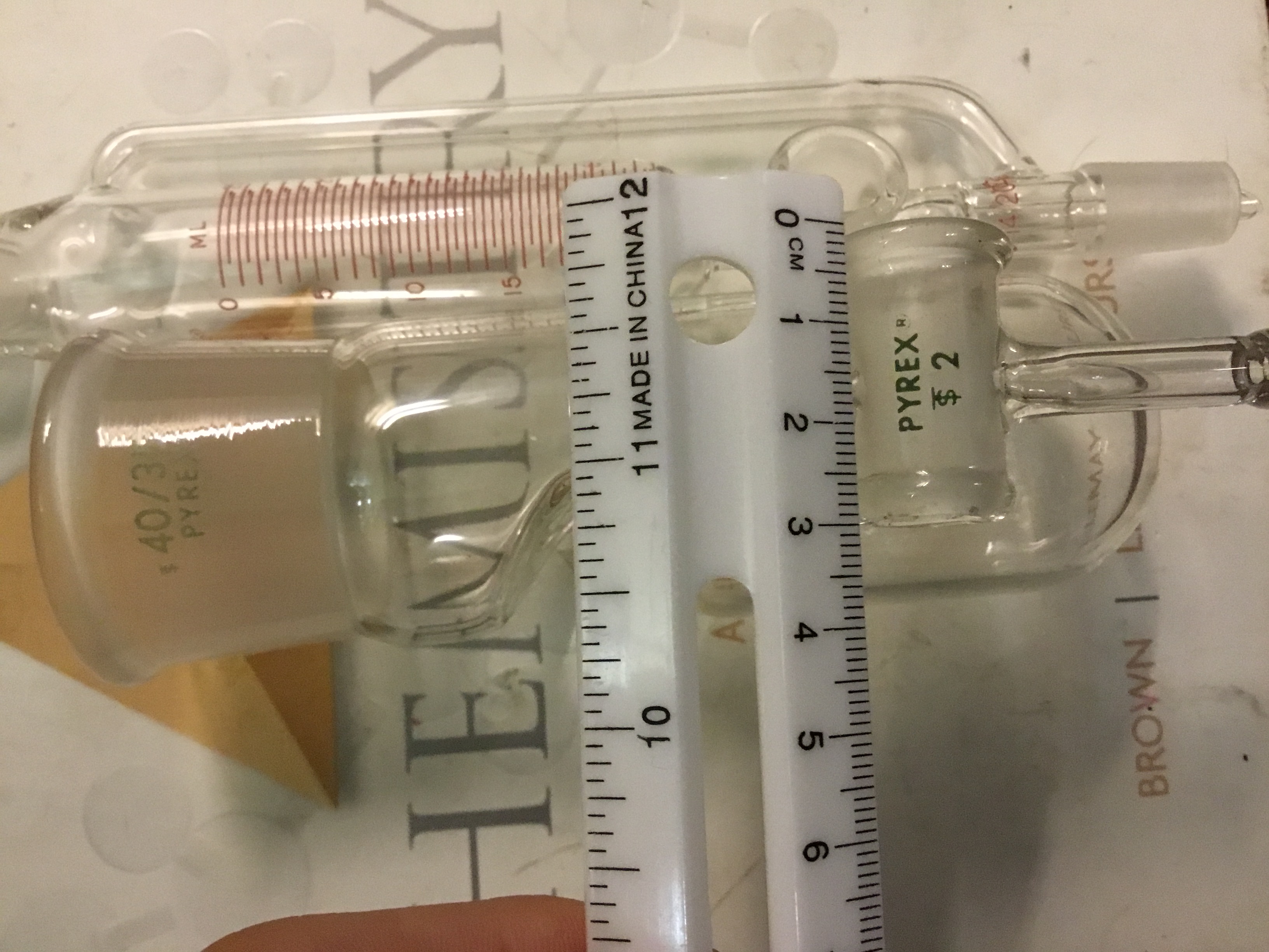

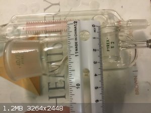

[*] posted on 14-10-2017 at 19:11
Stopcock size
Are the sizes of glass stockcocks standardized? I need one that has a 2mm bore, ~30mm long, ~13mm widest, ~10mm narrowest. This eBay listing has dimensions that are close, but not exactly the same (.4mm off). Is this just error of measurement or the wrong size?
Some pictures of what needs the stopcock:
IMG_0070.JPG - 1.2MB IMG_0071.JPG - 1.2MB
As always, thanks for any help :)
