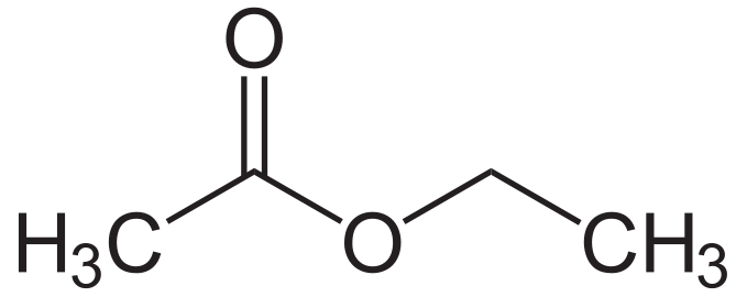

It came to mind that if i can manage to oxidice ethy acetate via some alkane intermediate , i can synthesise acetic anhydride.....any tips on how can i go about accomlishing this.......solo
ethyl acetate
acetic anhydride
Note: however i did read this "Alkanes usually resist oxidation with oxidising agents such as KMnO4, K2Cr2O7 etc. However, alkanes containing tertiary hydrogen can be oxidised to corresponding alcohols."
Note 2:how abot a transterification with totsyl chloride hecemaking it an acidic transterification adding sodium acstate to replace the totsyl chloride all sone in toluene.....just a thought
[Edited on 2-3-2022 by solo]
[Edited on 3-3-2022 by solo]
Posts: 2499
[*] posted on 8-3-2022 at 20:48
If you have tosyl chloride, you can just make acetic anhydride from that by reacting with sodium acetate. Boom.
The problem with oxidizing ethyl acetate is that it will tend to oxidize at the acetyl carbon rather than the carbon you want to oxidize, giving instead ethyl glycolate or ethyl glyoxylate. Maybe if you tried to do a radical halogenation of benzyl acetate, instead, you could get acetic anhydride or acetyl chloride upon rearrangement. In fact, that might even be a good idea.
