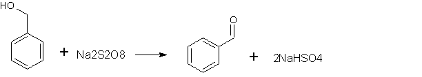

benzaldehyde synthesis.gif - 2kB

Thanks, DJF90. I wrote this procedure up in 2009 but did not post it until now. The picture I show is the only one I could find - and I had to lift that from an earlier post - that's why it's a Word file, which I realize is a crappy way to post a picture. If someone could show me how to make the Chemsketch equation (a gif file) and the photo (a Word file) show up directly in the post I would be grateful.
