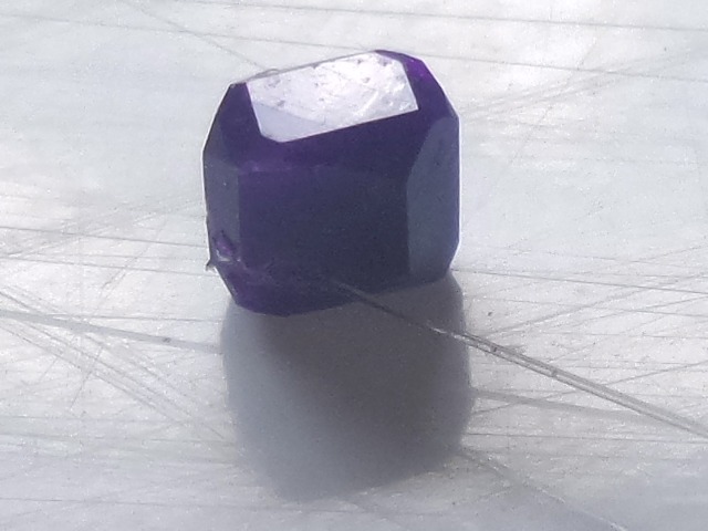

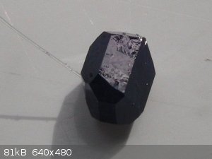

I used 7.38 g of NiSO4/NiCl2 (assumed to be NiSO4) in 50ml water. Then added 5.7ml (en) to 50ml water, and mixed both solutions. Let stand for a while and filter off Ni(en)3(OH)2. Add at least 9.3g of KI and let crystallise in the cold (I used 5 C). I obtained a second batch by evaporating about half the solution and cooling again.
As said, recrystallisation was an assumed purification step. The iodide is able to form beautiful multi-faceted crystals, see pictures.

Very nice crystals! How large are they?

[*] posted on 17-11-2020 at 15:34
These are close-ups. The long side is 4 mm. I'm making more of this compound to continue growing.
Posts: 8145
[*] posted on 18-11-2020 at 02:09
That's quite big already. My crystals of nickel complexes are at most 1 mm, but most of them are smaller, like table salt.
I really like the deep blue with a hint of purple of your crystals.
