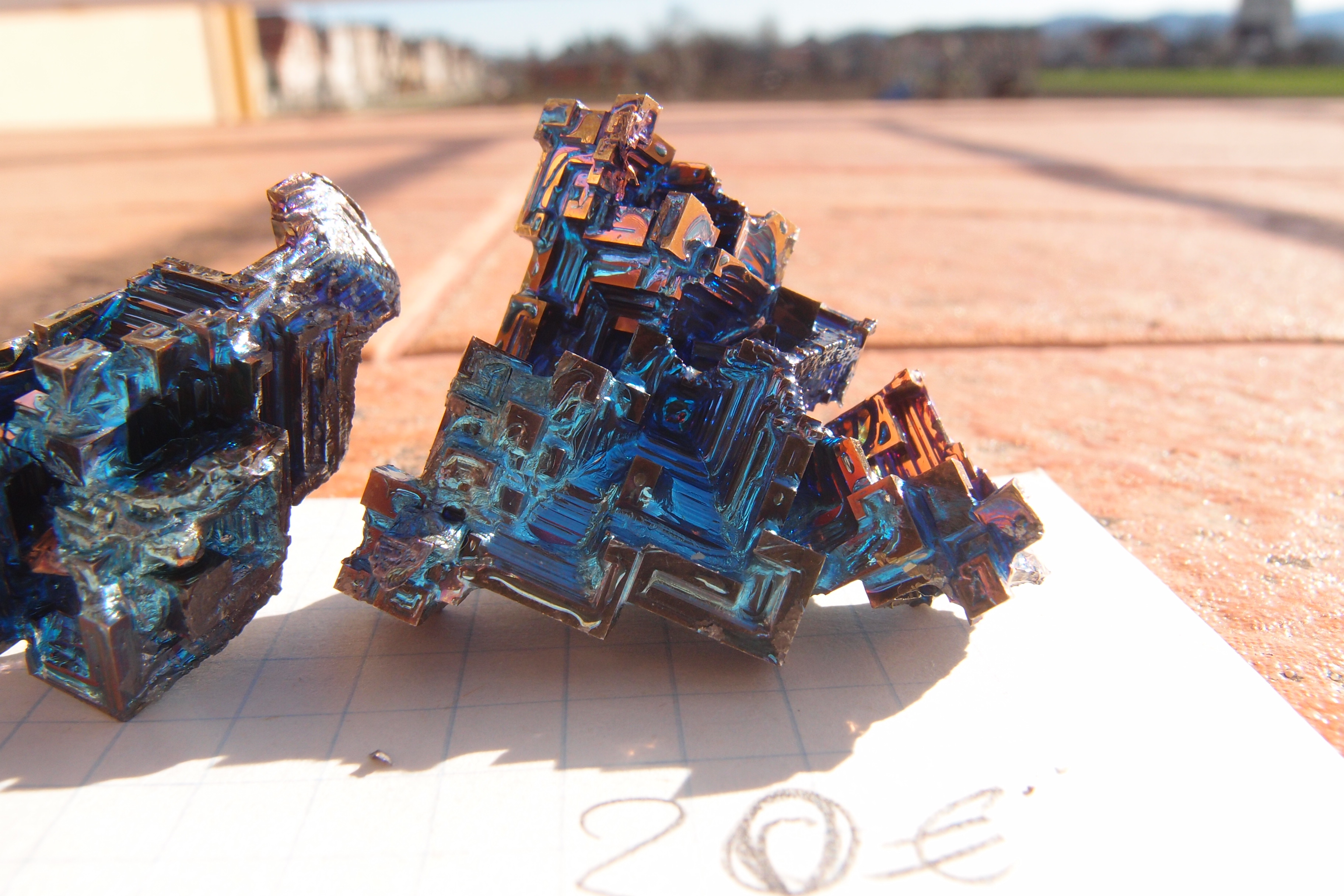

Very nice, Bismuth is definitely my #1 as well. Here's a few of mine. I figure at least one of these phone photos will look good on the big screen.
IMAG1303.jpg - 1.6MBIMAG1304.jpg - 1.6MBIMAG1305.jpg - 1.3MBIMAG1306.jpg - 1.3MBIMAG1307.jpg - 1024kBIMAG1308.jpg - 1MB

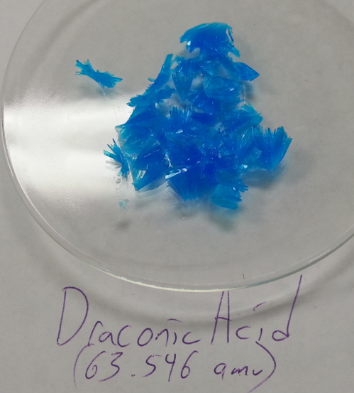

Copper(II) lactate trihydrate
CopperLactate.jpg - 93kB
[Edited on 18-2-2016 by DraconicAcid]

Yeah bismuth is awesome.
Btw bismuth crystal is much prettier in real life than in the picture IMO.

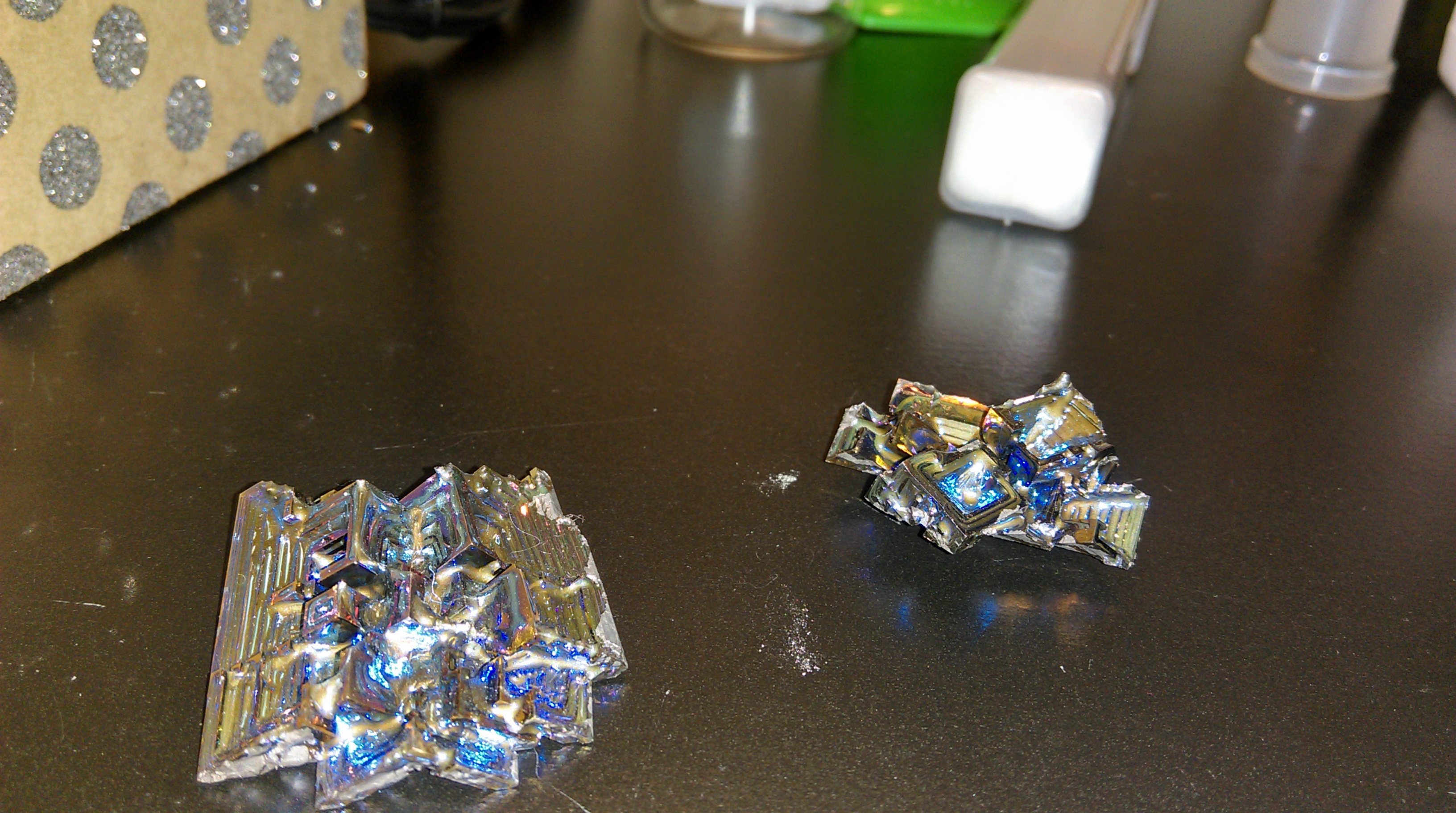

[*] posted on 22-2-2016 at 11:24
Awesome pic of my bismuth crystal:):):).
P2222505.JPG - 1.7MB

[*] posted on 22-2-2016 at 11:32
What is your trick to make great cristals like that? I made a bismuth cristal as great as this one once after many tries, but I don't know what I did and i'm not able to do it again x)
Help us build the Sciencemadness Wiki! Every question and tips about amateur chemistry two clicks away, wouldn't that be awesome?! sciencemadness.org/smwiki

[*] posted on 22-2-2016 at 12:03
hmmmm......:D
In fact I made this one a year ago and... now it seems i can´t make so pretty crystal again for some reason:(.
Maybe I have contamined bismuth with something or its some curse of bismuth:D:D:D.
I will probably buy some new ingot and try it again. If it will be a success, I will tell u more.

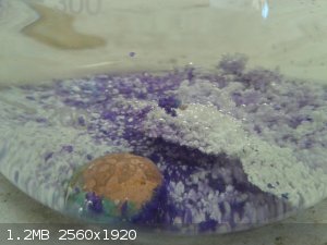

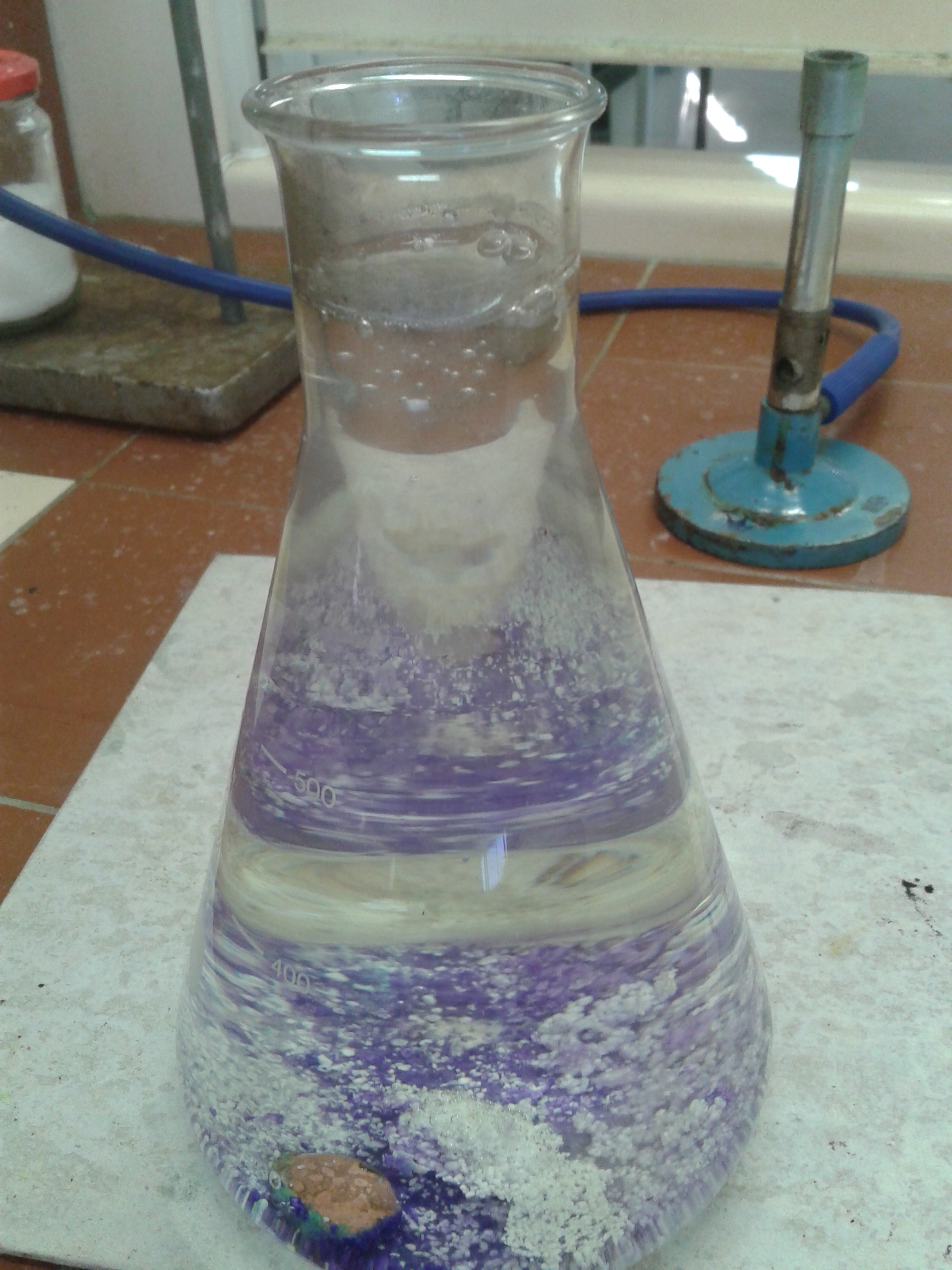

Details in my recent post in the When chemistry goes wrong thread.
The coppery stuff is what remains of a brass spoon. The bubbles were kind of sparkly looking and were chlorine. The purple is the copper-sodium dichlorocyanurate complex. (Interesting that Na-DCCA was not one of my starting compounds.)
2016-02-24 15.09.10.jpg - 1.2MB2016-02-24 15.09.41.jpg - 1.2MB
