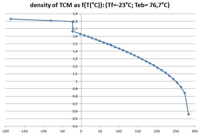

[*] posted on 26-7-2014 at 12:31
Quote: Originally posted by Dany
PHILOU my friend, i didn't tell you that liquids are incompressible. liquids are compressible, even solid are compressible but to a much lesser extent. The propagation of sound in liquid compresses and decompress successively the liquid, however the compression is infinitesimally small to make a density variation in liquid (or solids). However, under high dynamic shock wave liquid and solid will be compressed to a smaller volume. this is obvious from the unreacted Hugoniot diagram (the P-V diagram). This phenomena is observed under several GPa of dynamic pressure. For example liquid TNT has a density of ρ= 1.473 g/cm3 at ambient pressure. A shock wave entering the liquid with an amplitude of P=10.855 GPa (approx. 109 kbar) will compress the liquid TNT to a density of 2.259 g/cm3 [1]. of course the P-V diagram for the liquid TNT is called the unreacted liquid TNT, so no detonation is observed (the density of 2.259 g/cm3 do not correspond to the density at the Chapman-Jouguet point because as is already told, it is the unreacted Hugoniot). Your example of density change between sea level and the mountain peak is meaningless. Btw, you are telling me that at ambient pressure the water will dilate between 4 and over 4000°C, the question: is water still a liquid at these temperature :)

You didn't tell that liquids are incompressible but you did wrote: "It is the first time that i hear that the density of liquid change with pressure..." what means pretty much the same ;)
The question was if density change with altitude...not if the effect was strong or weak. True that the compressibility of gases is much bigger than the one of liquids, itself usually bigger than the one of solids.
Most liquids will expand under reduced pressure and contract under increased pressure...some will even freeze under pressure.
I'm analysing datas on that subject to give you numbers...the effect is weak but not negligible...I think it is in the order of 0.5-1%.
"Btw, you are telling me that at ambient pressure the water will dilate between 4 and over 4000°C, the question: is water still a liquid at these temperature :)"
Water at ambiant pressure turns into a gas above 100°C, between 100°C and 1800°C it remains molecular, but above it starts to decompose into its elements...so water dropped onto a white heated 2000°C metallic plate will explode in a flash due to overheating of water, decomposition into H2 and O2 and recombination into H2O. The H2O gas and later the H2 and O2 gases will continue to expand with heating.
Here follows a typical diagram of density of a substance as a function of T°. The example is TCM (tetrachloromethane) at ambiant pressure wich display a fusion T° of -23°C and a boiling T° of 76.7°C; you can see that at the melting point there is a gap of density; but that at the boiling point the volume variation is almost continuous.
[img]http://[/img]

[*] posted on 26-7-2014 at 13:58
Thank you Philou for posting the textbook of P.W. Bridgman which back up which i post in my previous comment that the pressure of liquid change under very high pressure. for example you can see (in the bridgman book) that at a given temperature the volume of liquid change very little even at 500-1000 bar range. So let's back to the original story of liquid density variation with altitude...the rapid answer is that the variation is practically zero et pour ne pas oublié, merci beaucoup pour me mettre la photo que ta pris du livre d'Arnaud! Je pense que l'internet est plein de livres d'anglais (que tu peux pirater) pour copier et coller des courbes d'isothermes et autres courbes de ta première ou deuxième année universitaires :)
Dany.
